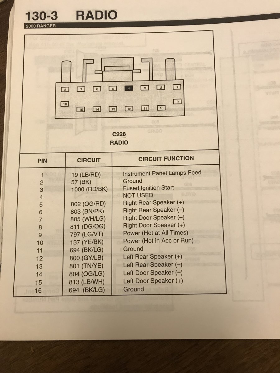

I just don't wanna hook the new ones up backwards
I would go with orange/green +
White/blue -
I don't have your exact wiring diagrams. But at least two other ford truck books show that.
from the Ford 2000 book
This thing is old
Thanks that looks good enuf to go with
Left door spkr
I just needed 1 to be able to figure it out that thing is pretty darn close
If you get it wrong, it sucks the music back in.
