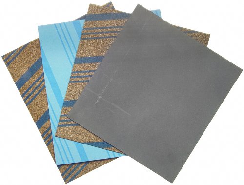

That's a neat idea. I just siliconed mine down. But in hindsight, I thought maybe a better idea would be to get one of these FelPro gasket material kits (below) and make one. Come back and reply as to how well your idea works out for you, I am interested in the end results.

^^What he said. I have used gasket material for over 40 years without any problems. Parchment paper breaks down in a few months or so form hot or cold weather...not smart. Inner tubes work great as does my old diving suits that I never throw out. I can patch a lot of things when I need to...lol

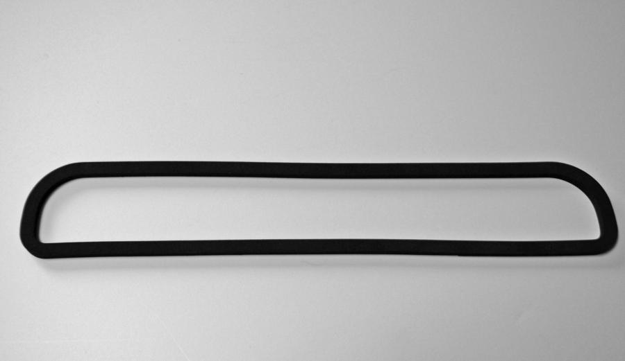

I have tested and am manufacturing a replacement gasket. I use closed cell material (much like the divers suit) that has been die cut. This material is actually a true gasket material that is UV, solvent, and pressure tested. It seals perfectly and is much cleaner faster and easier than anything else. Three years of testing with no failures. Designed, made from material, and made in the USA. I currently have them on Ebay, just search Ford Ranger Third Brake Light Seal.
Happy Trucking!

Hey Mook, I just ordered one of your replacement gaskets on Ebay and I used my PayPal account to send you payment. Thanks for taking the time to have these made up for us Ranger Owners.:icon_thumby:
Kind of delayed reaction, but thanks for purchasing the gasket. I like hearing back from buyers on the product and installation. If you have not contacted me through Ebay, let me know here.

No leaks makes you a lucky Ranger owner! It seems like the OEM gasket eventually fails on these trucks, thus the aftermarket gasket I produce.
Thanks to both of you for posting here.
