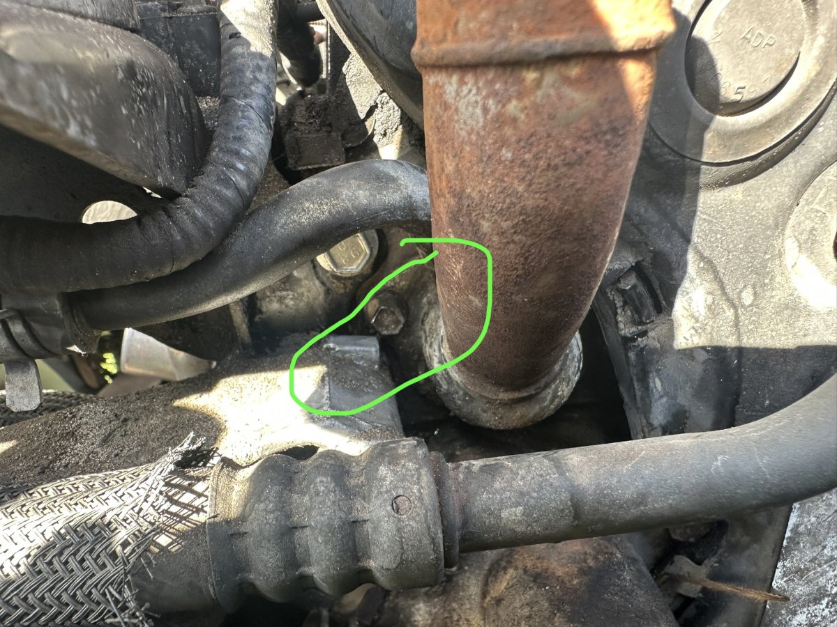

Alright fellas, what’s the trick here to get the thermostat housing bolts off? Of the two, the right one was easy, for the left bolt there is ZERO room for a socket. There’s a piece of metal of the alt bracket that sticks up maybe 1/16 of an inch too much. Tried every thin wall possible, can’t really get a good angle with an wrench either. I’ve even taken out the bolt for the alt bracket, still didn’t help. How should I go about?
Also, does anyone know the thread pitch for spark plug hole into the head? Appreciate you guys.

Sparkplugs are 14x1.25mm. 14 being the diameter, 1.25 mm is the distance from thread to thread.
I haven't dealt with that particular bracket, but if you're patient take a cheap wood chisel or something you don't care about that's sharp like a wood chisel and just by hand push and carve away at the aluminum... conveniently aluminum is soft and that whole process should only take 5 minutes or less I'm pretty sure...
Not a bad idea, hopefully someone else can chime in but last resort, I’ll try this. thanks man
