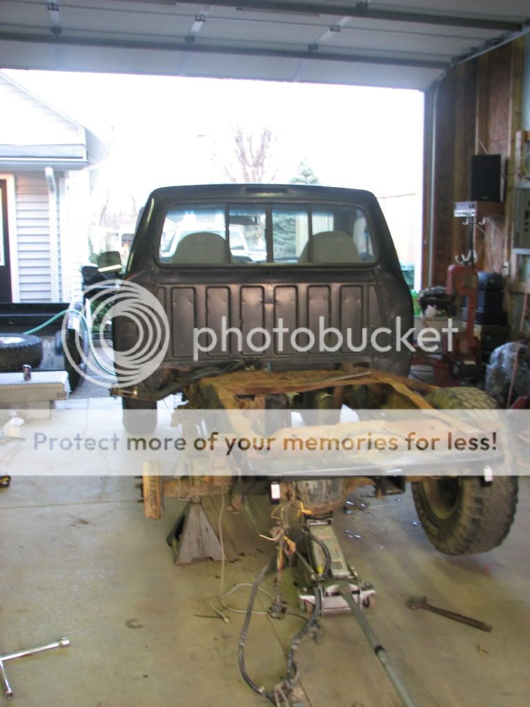

started pulling things apart

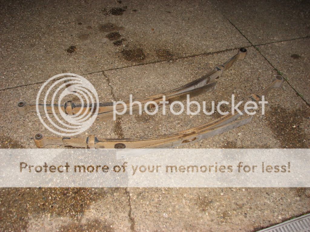

the new 63's

got alot done tonight....leafs and brackets and the tank are out
How come you had to take the fuel tank out?
When you replace the front hangers, you have to slide the fuel tank over to get access to the inside framerail for the nuts/bolts...I think he opted to just remove the tank rather than balance it and install the hardware, pretty much need 3 hands to do that...

Out of curiousity, how much did you pay for the 63's. I can get them from a junkyard around here for $50 a pack, seems reasonable but I just want to make sure that I'm not getting robbed
$50 a pack is about right...I'd get em if they had it...I'm needing 8" lift 63's for my setup, wish they had 10" 63's:icon_confused:
yea like he said cant really get to the back of the frame to i just dropped it since i had to fight the broken brake line which is now fixed...

so they want $50 for one leaf pack or for both? i paid $33 for both packs out the door
Ahh, yea, in the writeup? On the gen 4's I think the tank is a couple inches to the middle, i could fit a wrench in there no problem on my 99.
The JY wanted $50 for one leaf pack or $100 for both. I would have had them sitting on my garage floor right now for $33
ouch yea 100 is pretty steep....is that with you pulling them?
btw....63 swap is almost done...just waiting to get the springs re-arched
Oh yeah, wish we could get b4 and after or side by side pics of the springs being re-arched...how much can you get them re-arched and how much $$ is it costing you?? I was going to get 8" 63's, but the cheapest I found them was around $270 each pack...

search threads by racerranger97 and look for a thread called rear long travel...
stock the leafs have 9 inches of arch and im taking them to 12 or possibly 13 to make up for a little sag....probably going to be about $80-90 to get them done
