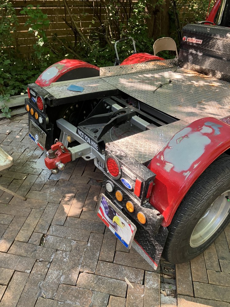

I used the metal working tools to flatten out the dents on the rear fenders caused from my misalignment of the linkage in the trailer tongue when I turned. I beat the metal about as flat as it’s going to be, and I put the first thin layer of Bondo,

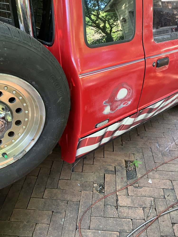

I sanded and skimmed the fenders and a couple other spots. Boy that’s always clean fun work especially when it’s mid nineties. Tomorrow should be last details before paint touch up.

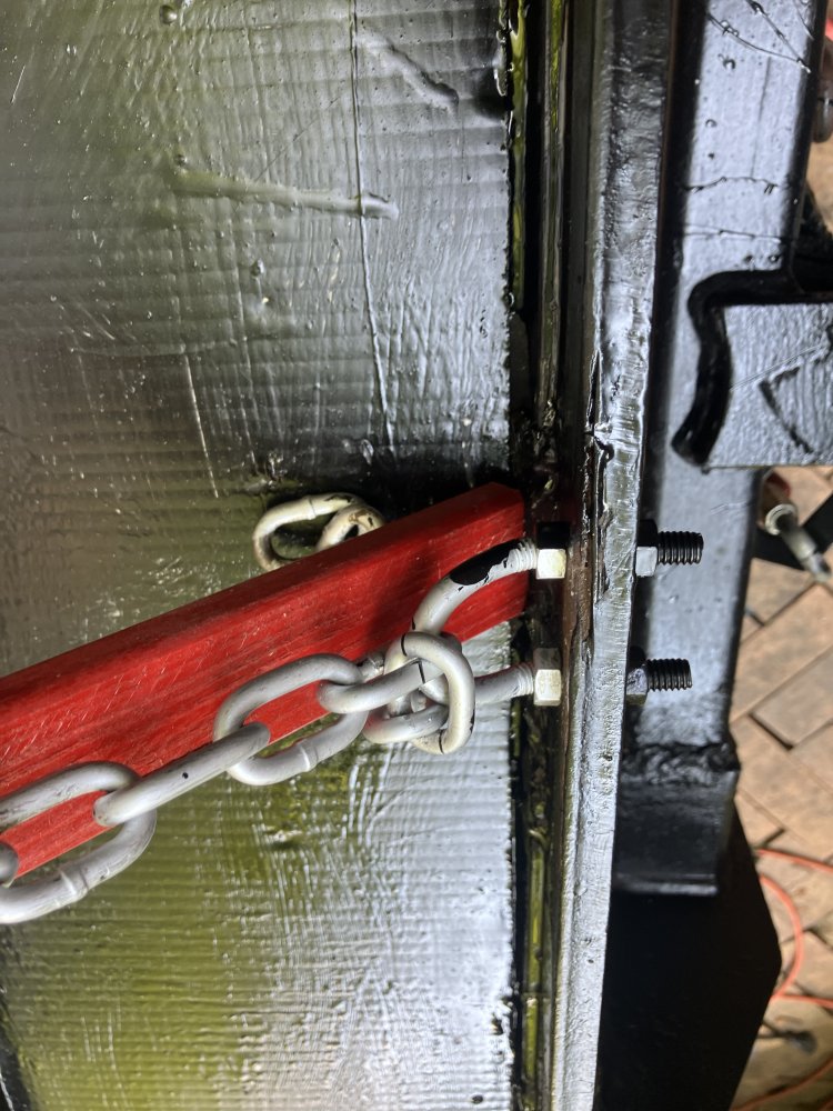

I also installed the safety chain and safety support under the upper deck of the trailer. Chain to keep from damaging the hinges so it won’t flop over too far, and support (stick) to hold it up at the same time so the wind doesn’t blow it down when I’m working underneath.
Got 3 more things done and crossed one off the list.
Safety chain & stick:
Yes, that’s a U bolt from a conduit/beam clamp, bent in granddaddy’s vice.
Body work is done & painted. I’m sure there will be several rounds of final touchup on the silver, the black, and the red.
Trailer is all wired for the brakes with a positive and a negative hanging just above the axle on each side. If the brake hubs come in in the next couple days, it’ll get done, if not…

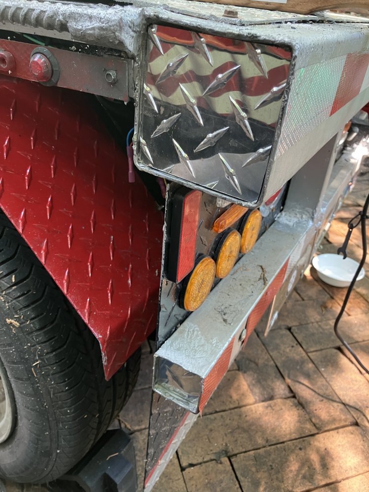

Low intensity, strobes on the trailer are fixed. What was driving me crazy was that I could get them to work, and they would work for a day or a week or a month, and then the amber strobes would go out. I wired them with speaker wire, which I have done with LEDs many times. I like it because it’s inexpensive and it comes in a four color common cord. There are two circuits, a positive and a negative each, one for the Amber, and one for the white lights. It turns out that if you don’t wire the reverse light positive into the amber ground circuit for the strobes, they work better. When the power went to the reverse lights, the speaker wire I was using for the strobes was like one giant fuse link. I broke down and replaced some of it with copper until I found the cross wiring. I think there are 27 different lights on the back of the trailer, and some are double circuit, like the brake/turn. The amazing thing is that I only cross wired one of them.

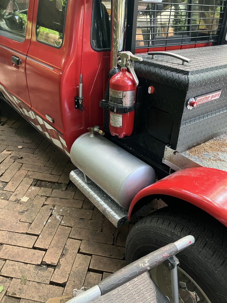

Fire extinguisher and cover panel done. I still have to get it filled or replace it.
And I made caps for all the open tubing.

Pin stripes are all fixed after the body work, and door Steps are painted.

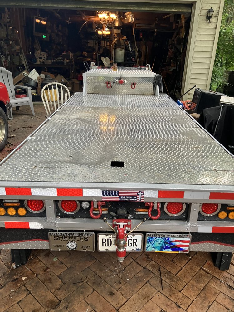

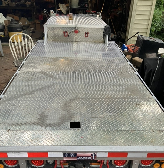

I have made a little progress. It’s the “20 foot” type of progress.
I think you can see the difference in the upper deck, and the first sheet on the lower the closest to it.
Those dark, almost black discolorations are where some of the sack of concrete sitting on top of the stack of sheets seeped in between the sheets.
I spent a ton of time on the upper deck. Might be hard to see, but there are several independent sheets of diamond plate up there. There’s one big sheet that’s about 60% on the right hand side, and then four smaller plates make up the left-hand side (because that’s where my access panel is for the main electrical). I didn’t do anything to the sheet on right and it still needs a little cleaning. I did all kinds of stuff to the sheets on the left. No matter what I cleaned it with or how I cleaned it, it wouldn’t remove that black staining. I could clean it up, and even make it shiny, but it was that kind of whitish shiny. The original sheets have a mirror finish, and in comparison, actually have a touch of a blue/gold tone.
To get the black corrosion off, I used a very fine wire wheel brush in a drill. I very lightly ran it over the black corrosion in one direction of the diamonds, and then I ran it 90° to that, going back-and-forth until the dark corrosion was gone. I did it very lightly so I didn’t gouge The Aluminum.
When I put the acid stuff on it to clean it before I buffed it, I had to be careful because it would immediately start to tarnish the raw Aluminum again. I wiped it off quickly, and immediately put on the paste. That’s where the second headache came in.
I have every buffer known to man, and I even got creative with different things to try to buff it. The most successful was using a buffing wheel like would go on a bench grinder. I opened up the hole a little bit in the middle, and I put it on an angle grinder. That high-speed did an OK job, but no home run.
When I did the first sheet on the lower deck, closest to the front, I just wire wheeled the dark spots as described, cleaned the sheet very quickly with a nylon scrub brush and a little muriatic acid, rinsed it with a mild vinegar solution, and then I used the polishing paste. The results certainly don’t match the original diamond plate, but it’s fairly quick, and from 15 feet away you can’t tell. If you’re looking straight down on the sheets, you can see it very clearly.
But hey, at the end of the day, it’s a work truck…
