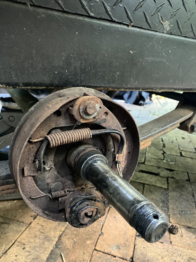

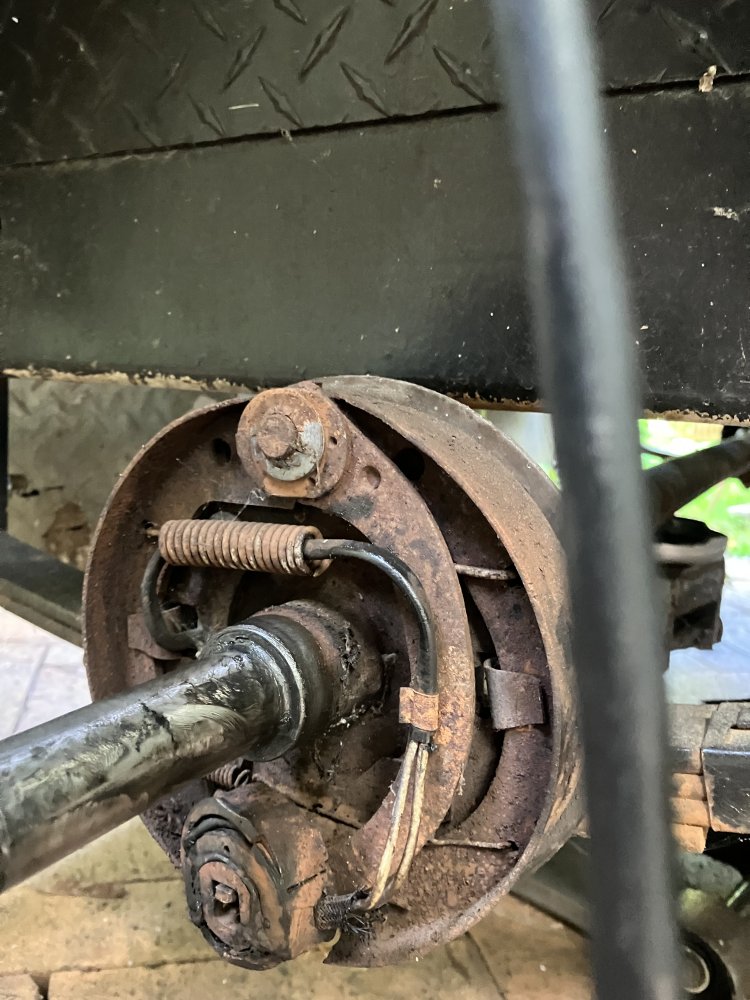

I’ve been working down the list of stuff I want to do before nationals, and once again, I started with about 35 or six items, I’ve done 20+, and now I have 32 items. It never ends, ain’t it great?

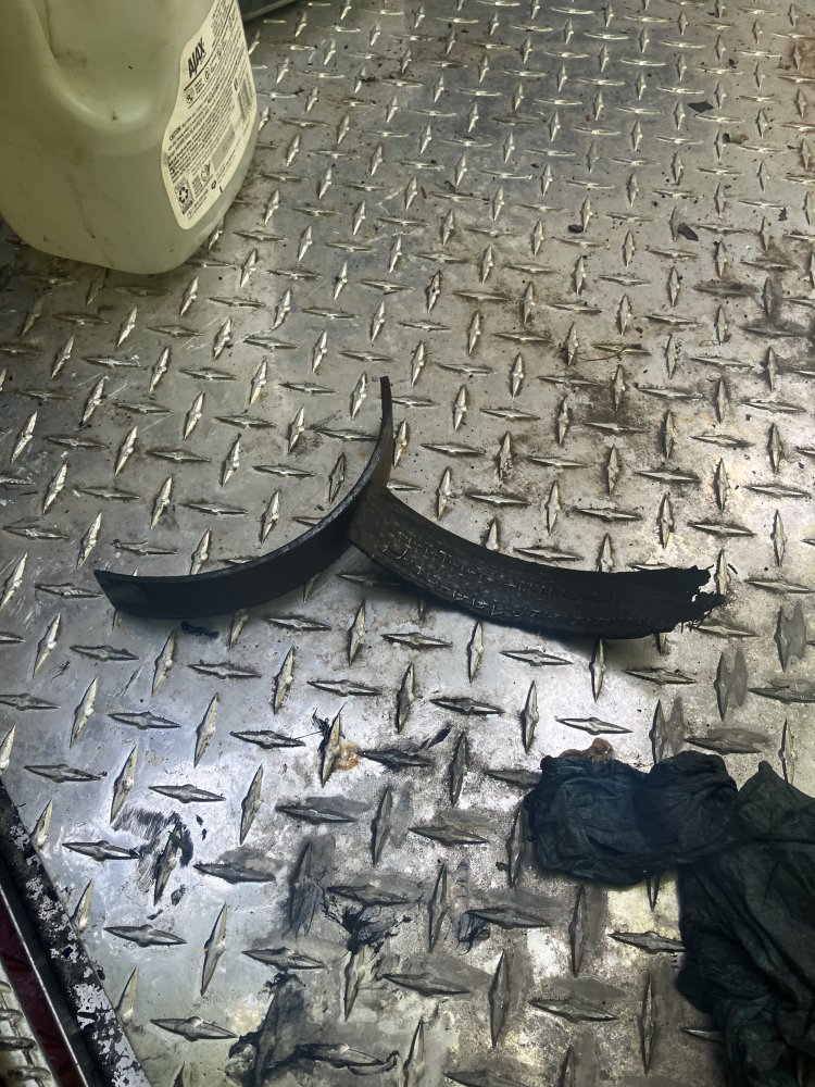

I went through the wheel bearings on the truck with the extra axle, and now I’m working on the trailer. Front axle is an idler axle, and the rear axle is a 7 inch brake axle. (remember it was a Coleman pop-up camper at birth). Idler axles just needed a little cleanup, and I put new grease and seals on them.

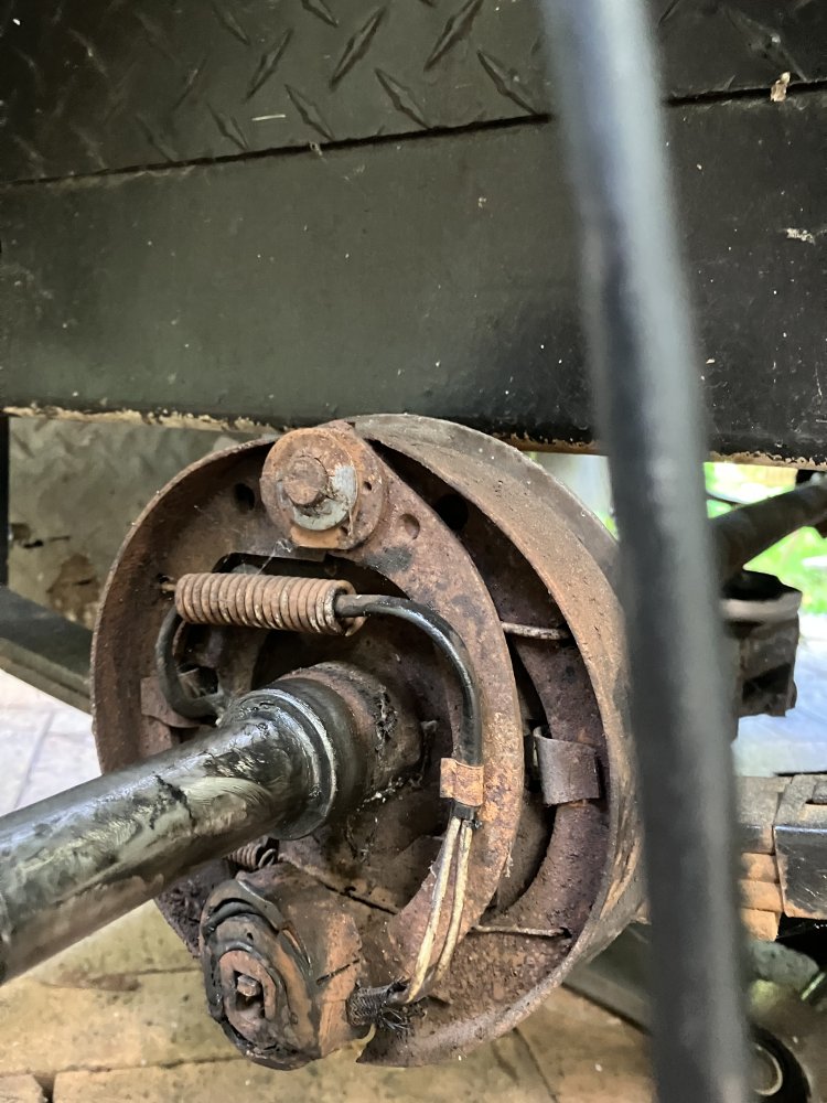

When I removed drums from the brake axle, the mechanism has surface rust, but was actually in pretty good shape. The friction layer of the brake shoes had popped loose on three of the four shoes, and I’m assuming it’s 3/4 worn down. The drums were very clean, no metal to metal, so I’m assuming the friction surface just popped off from moisture, while the axle was sitting for a few years.
I ordered two new complete brake kits, and an extra set of pads to rebuild the existing brakes.
Question: Does anybody have any wisdom on whether I should put the new brakes on the front axle or on the back axle? The existing brakes will be rebuilt, but I’ll be trusting the new ones a little bit more.

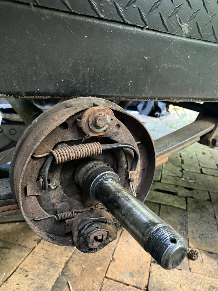

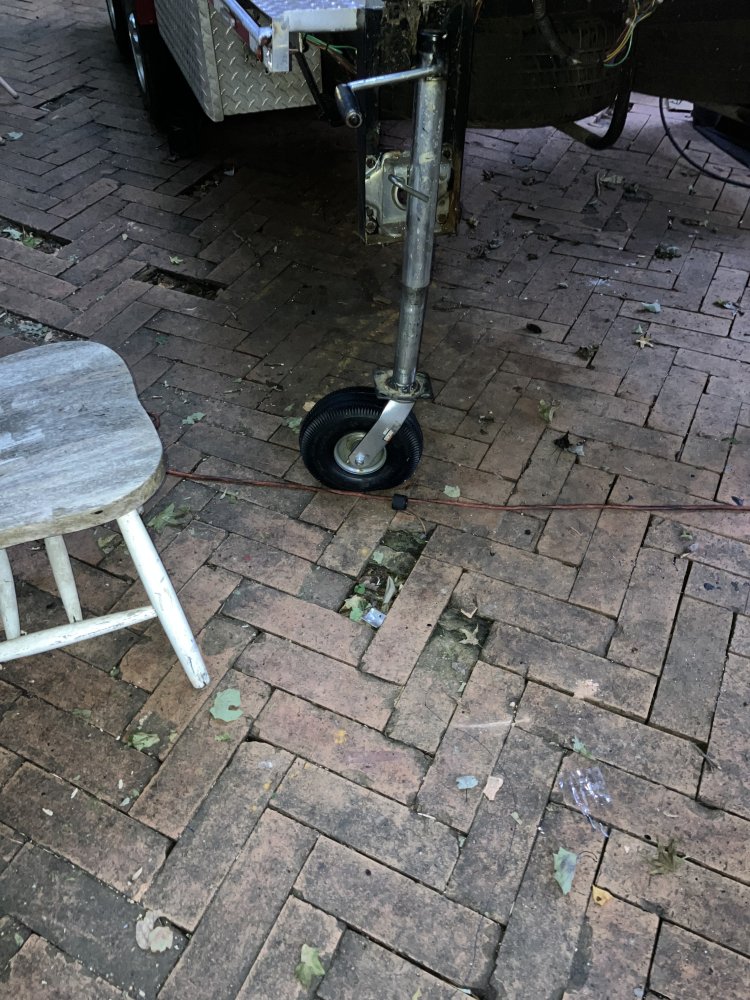

I finished (before the 95° finished me) by modifying my trailer jack legs to use 10 inch pneumatic casters. I also have static legs for when I just park or show it. These casters don’t look exactly right, but I had to have them for moving it around.
I had the 8 inch solid wheels, but they kept hanging up on the bricks or any twig that was in the driveway. I haven’t pushed it around, but I can already tell it’s going to be infinitely better. All I ever have to do is turn it around in the driveway by hand, but I’m guessing the weight is 6 or 700 pounds or more on those legs. It’s not a tongue weight issue because of the way it sits over the second axle of the truck.

I was concerned when those heavy duty pneumatic casters appeared to be under a pretty good strain. Then I realized I had it jacked up so high that I actually had the front axle off the ground! sits much better when you level it out. I also drilled a hole through both of them so I can slide a 1/4–20 bolt through, and I zip tied the bolts to the ear of the caster with a little nylon string so I don’t lose them. I won’t leave them on when I ride down the road, but as I was building it, one of them kept dropping off.

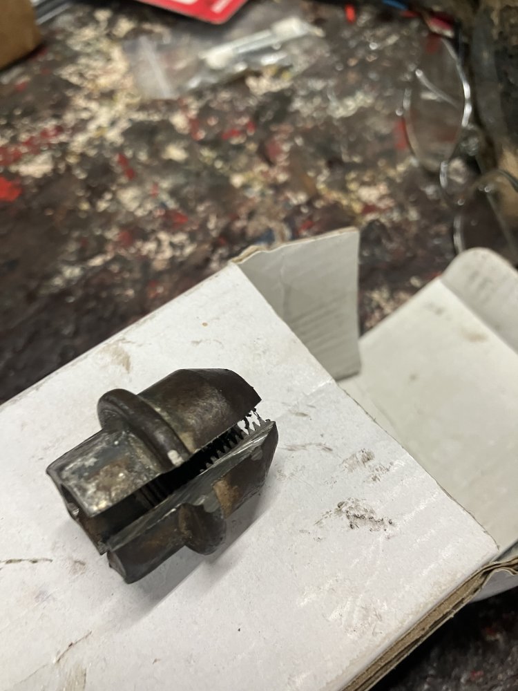

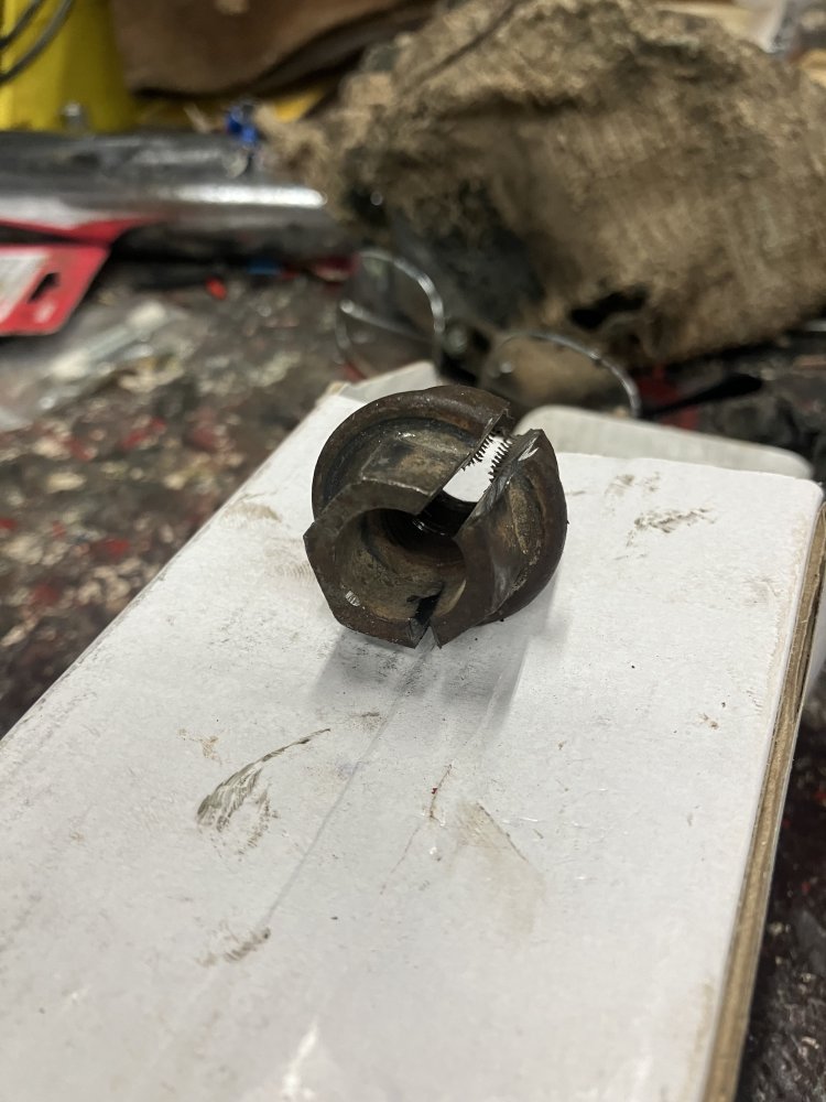

I also had one lug nut cross threaded and frozen on the stud in the brake axle, the stud would come out with the nut. It probably would’ve held forever, just one of those things that makes me nuts.
The Road Ranger.  1997 SEMI
I ran a dye over both ends of the stud, problem solved.

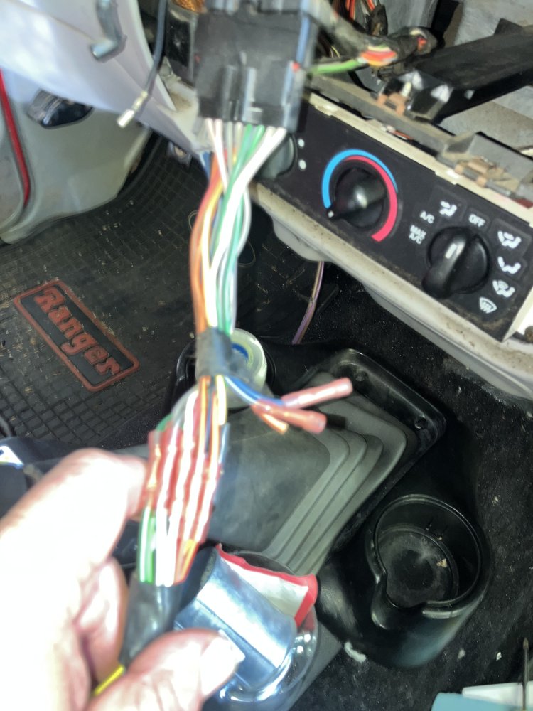

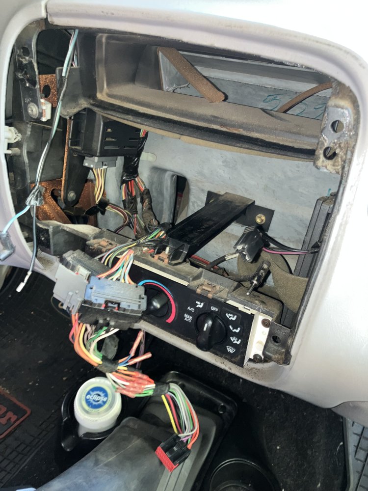

I went out about five, and I pulled the radio out to try to figure out why I didn’t have any lights on the radio. I had looked up the wiring schematics before hand. When I opened it up, they were a few wires that went nowhere, and there were a couple of different adapters.

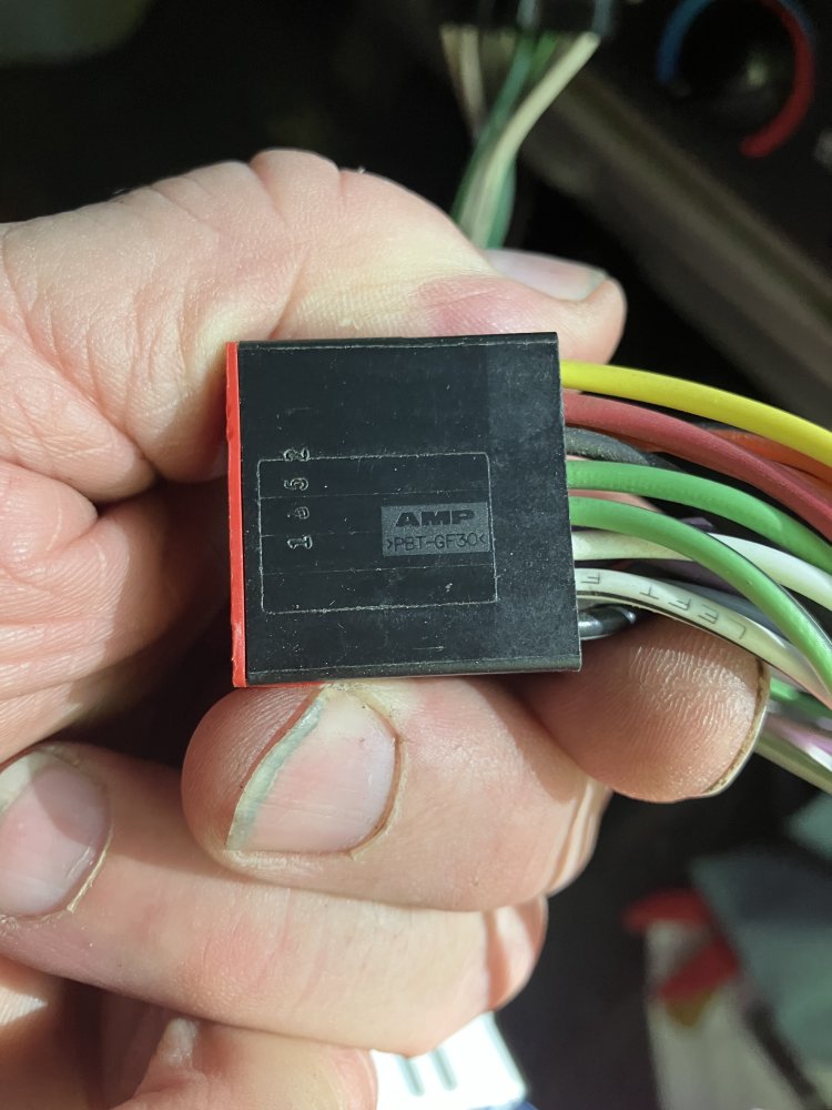

I looked up my “$50 97 ranger OEM AM/FM, cd, cassette,” and it turns out it’s a 2001 head unit. It sounds great and everything works, but the wiring does not go color to color. Everything was working great except the illumination. I did trace down that the illumination wire was broken off of an aftermarket splice.
So I connected it, and it blew a fuse. I almost blew a fuse. I had a Bahama breeze fan blowing right on me and I was still roasting. I went through all the wiring schematics for the 97 truck, and for the 2001 radio, and this little plug that I think was aftermarket that went into the back of the radio, and I finally figured out that the radio ground and the illumination ground were cross wired. I don’t know why a ground isn’t a ground, but when I reversed them and connected them properly, everything worked. I don’t know if I would’ve stuck it out in the heat if it was just the Radio, but when I blew the fuse, I lost all my dash lights.

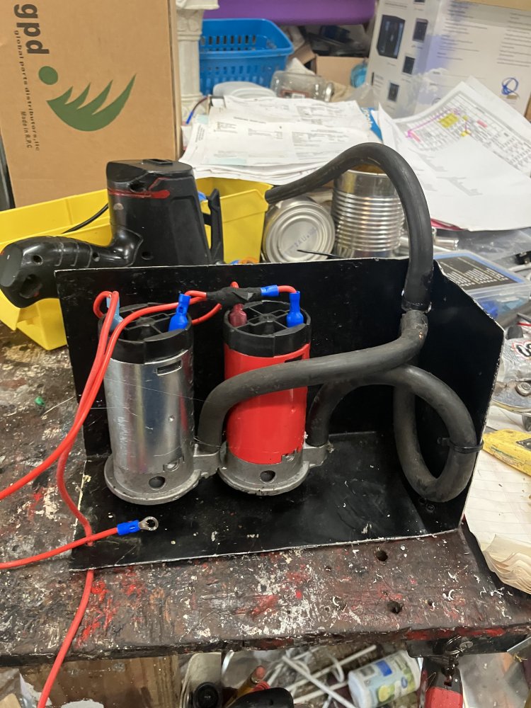

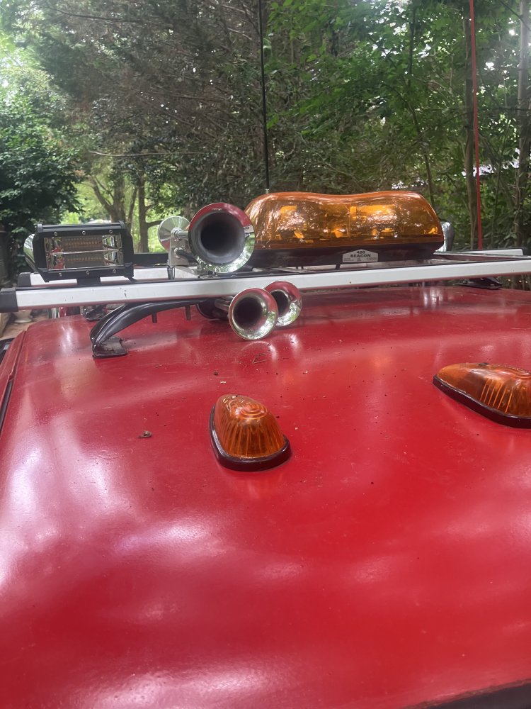

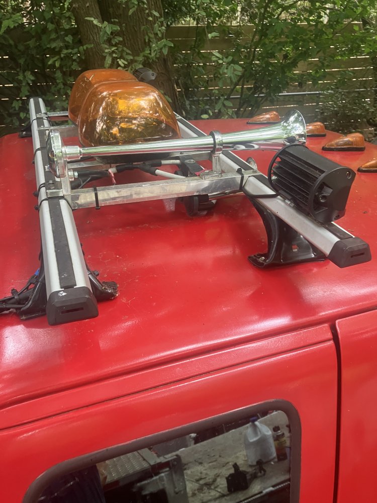

I wired the air horns today. Before now they were pretty much eye candy.

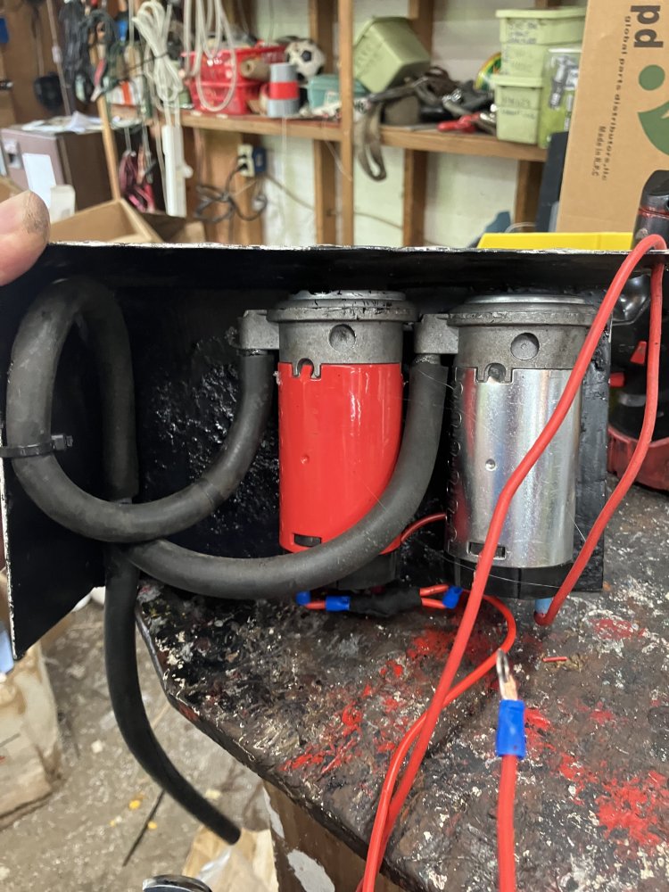

I wanted the deep long horn, and the screech of the short horns, but it’s a mismatched set, and I didn’t want five of them up there. The two little air compressors were identical, but I had to use both of them. Yep, it works now!

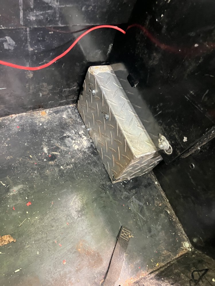

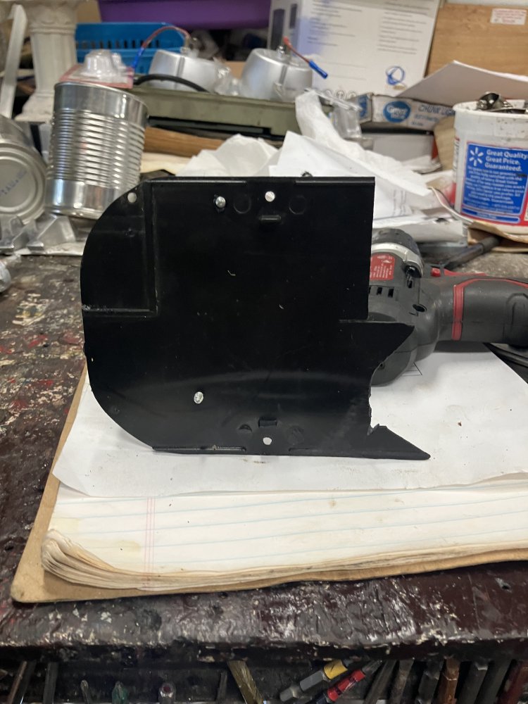

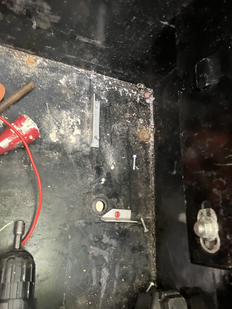

I used the last corner of that original free truck box to make a housing for inside the toolbox. I had already run the airline from the roof down the back of the cab along the headache rack and I just had to feed these through the bottom
I made a couple cleats for the bottom of the housing to hold it in the toolbox so it won’t get bashed around. One of the biggest pains in the butt was getting the hose in the grommet through the aluminum. The housing is open about 1/8 to 1/4 inch all the way around the edge because I didn’t know how much air these things actually needed.

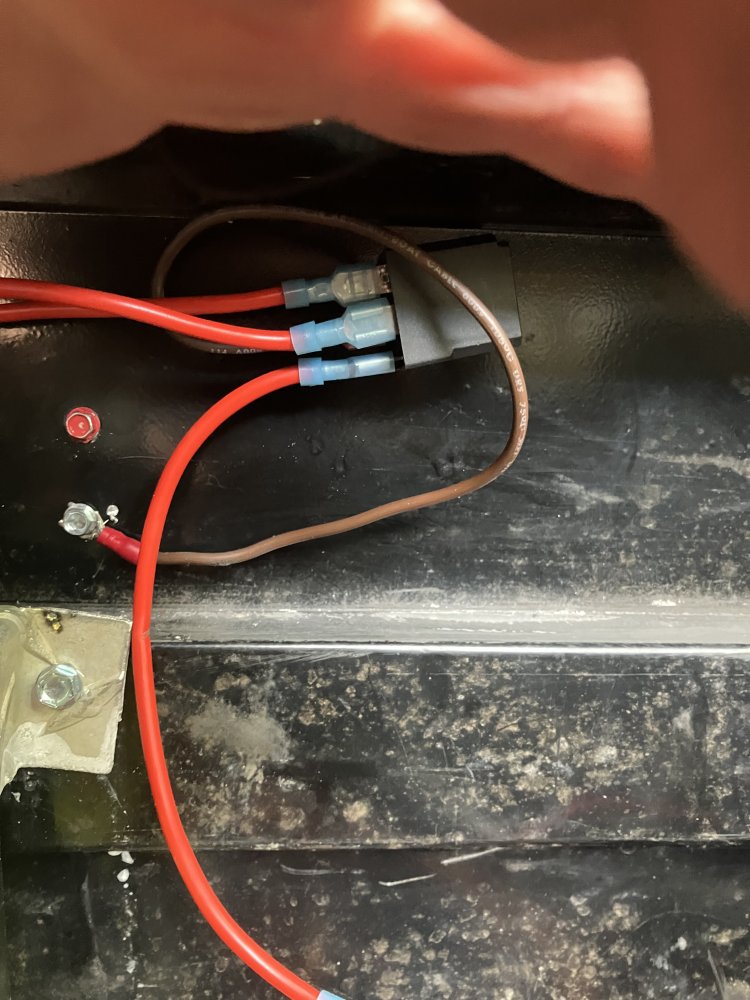

I had already run the wire from the console with the CB by the rearview mirror, but I had to add a relay. Without the relay, it kind of just went “beep.” With the relay, well, except for the guys on the West Coast, you probably heard it….

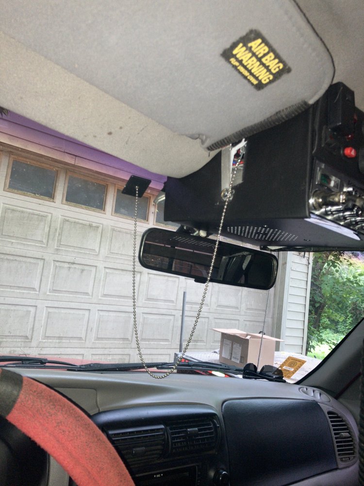

When I did the overhead console, I wired a push button micro switch, facing up, under a home made little lever, sticking out the side over the driver (tiny). Somewhere through the decades, I picked up one of those pens on the chain that are stuck to the counter like you see in a bank. I stuck the little pad to the windshield left of the mirror, and hooked the chain on the lever, so it hangs down for an easy grab.
I was thinking of just hanging the chain with a tassel on it, but having done that trick before, it flopped all over the place. This is right where you can grab it to blast someone off the road (not that I would ever do that).
Are the zip ties on the roof rack UV resistant? If not, they might last about a year before they get brittle and break.
