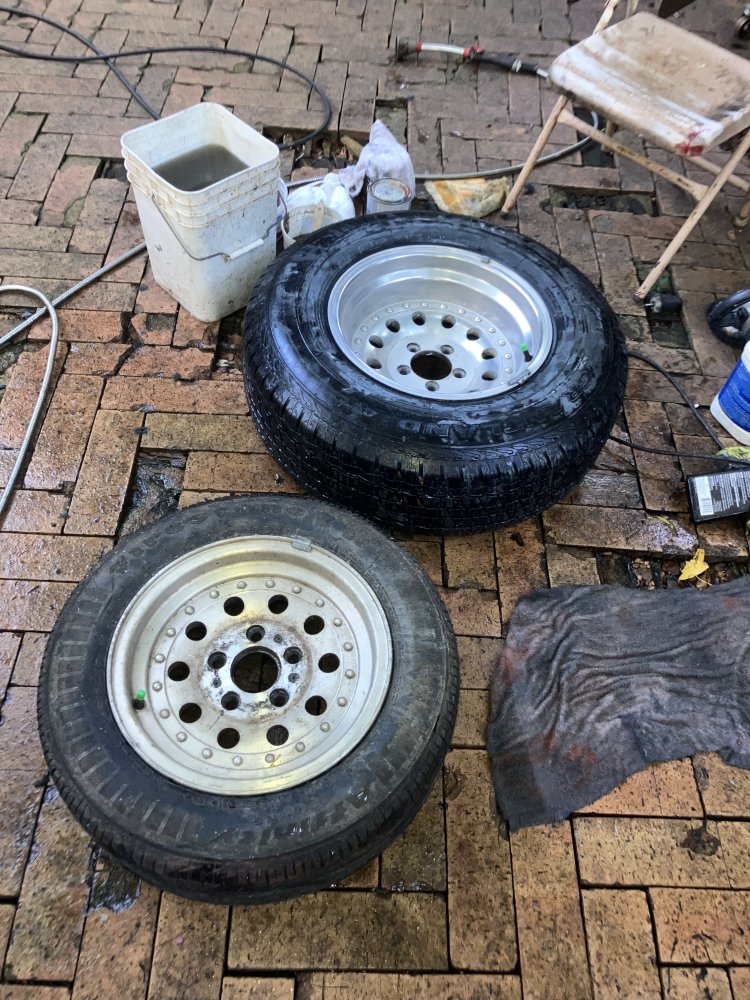

All wheels are as polished as they’re going to get.

It may have ruined the clearcoat on the last two wheels. I had them laying on top of the trailer while the clearcoat dried so it would spread out even. I hope they were dry enough that the raindrops didn’t ruin the finish.

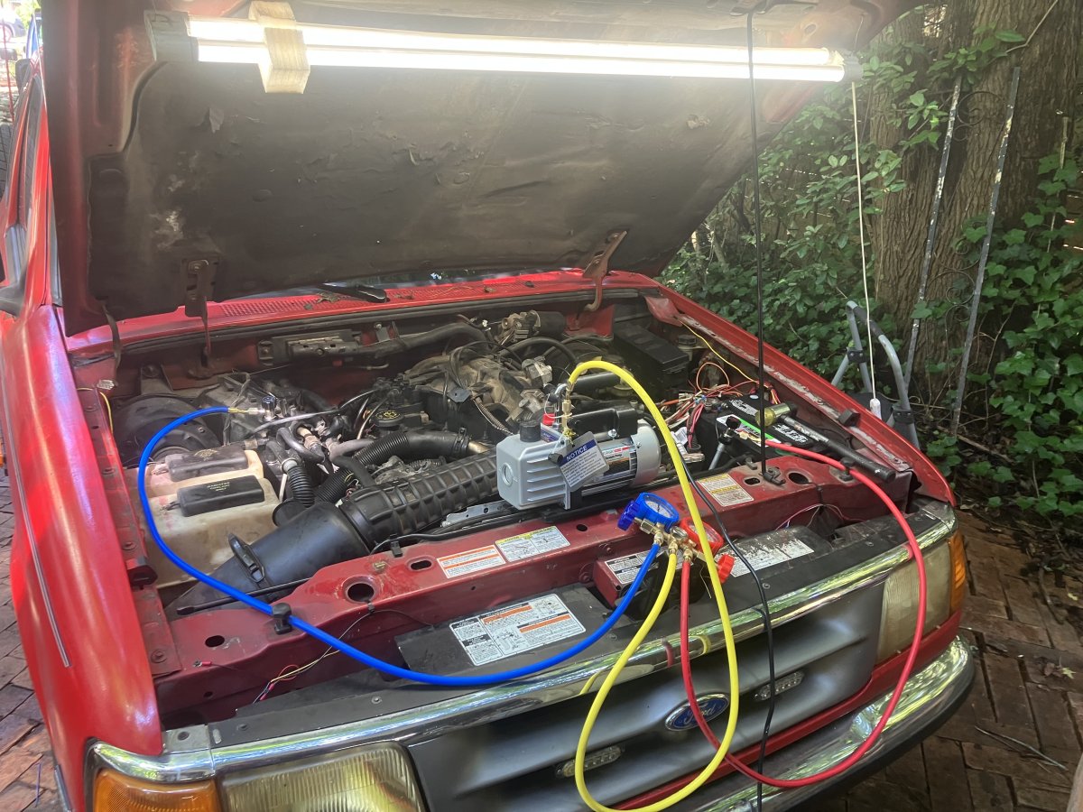

Hose slipped in fairly easily. I prepared my new $30 pump by putting oil in the air side (no owners manual), then spent 20 minutes to figure out if that was OK, it was, and I set up all my gauges without connecting them, brand new set, so I had to use the adapters and such.
I just reversed the procedure from @97RangerXLT, except that I used the first step, cussing out the Ford engineers, first, and all during the process. Here’s a short list

I didn’t take the protective caps off anything until I was ready to connect it. All new O-rings on the parts I disconnected. Zip ties instead of a screw in the bracket behind the engine, but I did tighten the 13 mm so it’s solid.
When I went to put the gauge set on, the high side spring release thing popped on. When I went to put on the low side, I could pull the collar up, but I couldn’t push it down far enough for it to snap in place.
I consulted with Lincoln over a glass of iced tea, and then I slipped the collar up and held the thing down with one hand and gently, but firmly, tapped the top with a rubber mallet, and it popped on without anything exploding.
I turned on the pump and opened all the valves, and immediately pulled about 24, and it went up to 26/27 in the 10 minutes I was cleaning up. I’ll check it around seven.
I like the picture because it looks like a pro was doing it. You can’t tell all the stuff it took to get to that point, you can’t see the kitchen chair, or the fans, or the rags from cleaning the wheels…
The gage set I bought is so cheap, it didn’t have the hook to hang it up
Pop-up thunder showers, so I let the pump run until about 930, 4-1/2 hours. We’ll see if we got a vacuum in the morning, maybe run it some more.

Rick, you can check it by closing the gauge set valves, and then look and see your vacuum stays at the same level. A tiny leak will take a while, but anything else your gauge needle will visibly drop.
Thanks, understood. I’ve had this thing since 2020. When I got it, we put a little Freon in it. It was cold, but it was gone very quickly. So it’s been sitting empty for four years. The main manifold hose had obviously been damaged and repaired with some epoxy, so I’ve assumed all along that’s the issue. First thing I’m gonna do is put in a little can of stop leak and die, and then put the right amount of Freon in, assuming it has a vacuum in the morning. If not, it’ll just get put aside until I get back. If it’s got a slow leak, I’ve got a couple extra cans I could bring with me for this long trip the nurse at a long.

Soooo, I went out this morning to check if I still had a vacuum. My cheap gauge set does not have a third valve to cut off the yellow hose. And I don’t have a way to cap it.
So I turned on the pump, let it run for a minute, and then I opened the gauges. The low side read 20 and quickly climbed to 24. Then I had the thought to simply test all the hose connections to see if they were snug. I was able to tighten up one of the blue connections and one of the yellow connections a little bit.
I would think that if it had a leak, it would’ve taken longer to pull the vacuum down like when I first started. I don’t really have any time to analyze it, so my plan is just to let the pump run a little while, and then put in some leak detector, stop leak, a little more oil and Freon, and then the Freon to the right pressures.
I don’t have any leak detector/dye so I’m going to run to the store and get some before I start. I live with Murphy, so I figure if I don’t put the dye in it, it will definitely leak. If I spend the extra money, and put the dye in it, and my luck is consistent, it won’t leak it will just be a waste of money.

I got the leak dye, left the vacuum pump running the whole time, and when I got back, I took the pump off and tried to feed the leak detector, oil and Freon into the system. I don’t know what was going on with my brand new cheap gauges, but I couldn’t get it to work.
So I went back to one of those $15 quickie hoses with a gauge that I’ve used to top off systems before. I put everything in, and got it to the right low side pressure. Now it’s making icy cold air. Yeah! Buttt…

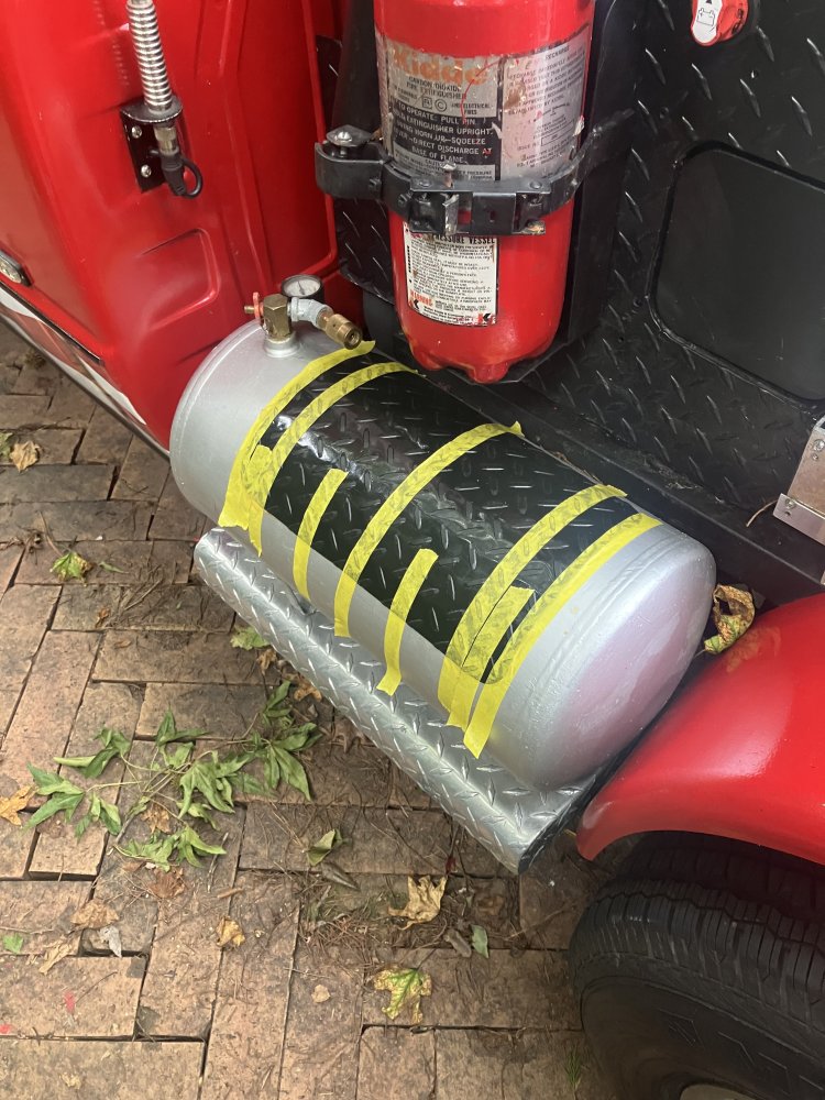

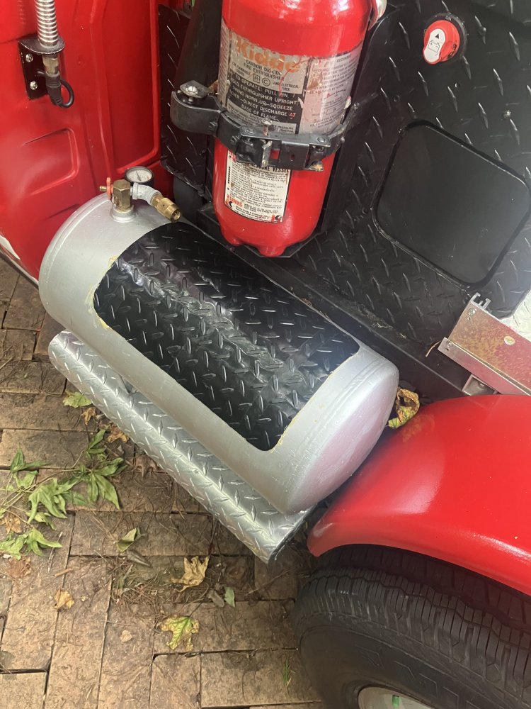

Vinyl tread plate stuck on the air tank with some outdoor carpet glue.
