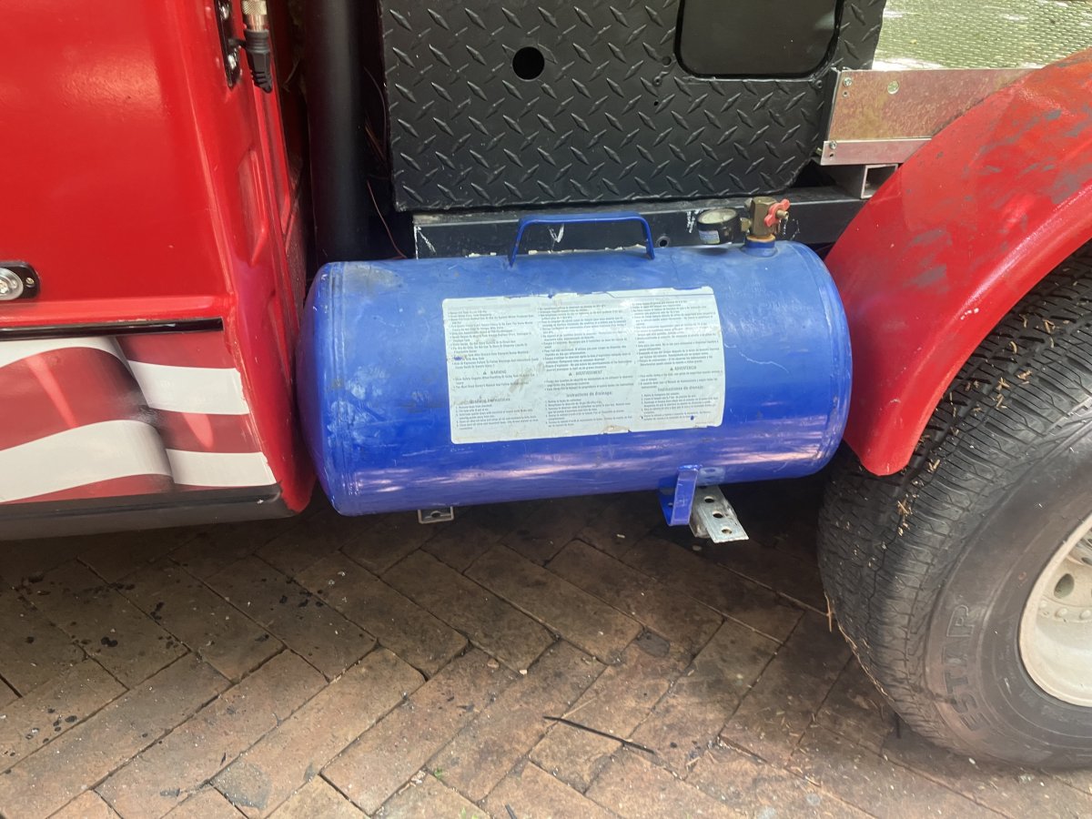

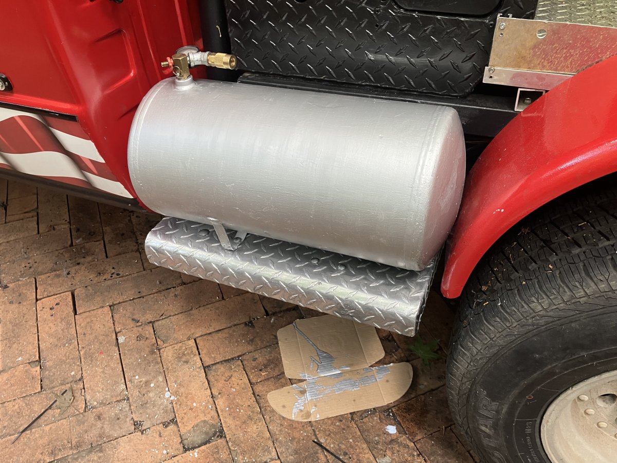

I used the last of my free bed frame stock to try and make a kind of rack to hold the air tank behind the drivers door next to the toolbox. I don’t know if it went like crap because I’m incompetent, but I suspect it had something to do with the 85% humidity and 92°. Even with a fan blowing right on me, I was soaking wet and frustrated and I just couldn’t get it right.

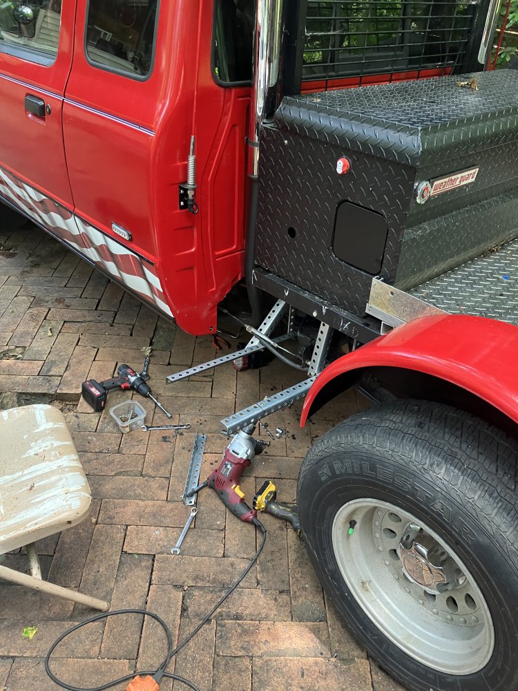

I’m bolting it to the side of the truck frame, one bracket on either side of the spring mount. The driver side spring mount is also where the emergency brake cable splits into two to feed both sides of the truck. And that’s the gathering area for the 20 or 25 wires for all the toys I’ve added that work through the toolbox. Since I can’t get a nut on the backside of the frame because of the gas tank, I decided to drill and tap holes right in the truck frame. Thank God, I took a small dowel and checked behind the frame to see if anything was back there before I drilled the holes. Nothing important, just brake lines and fuel lines. After four or five hours, I was thinking it just wasn’t meant to happen.
Not to be defeated, after a break and cooling down, I took some scrap unistrut angle I had, and basically fabricated the pieces with the unistrut.

Lord knows I am the king of rigging anything with nothing, but I still like it to look good, and it has to be functional. I couldn’t stand the uni strut. Or the third thing I did. Or the fourth thing I did.
One of the biggest problems is the cables and wires in the spring bracket and all, are all crammed right in that spot, so I had to do something that would work around it without damaging anything and getting smashed by the spring.
Second, make me crazy thing is I didn’t want anything to be showing under the tank.
I finally dug up a couple of short pieces of steel angle that would fit between everything, that I could bolt to the frame. I welded on some substantial 1-1/2 in.² unistrut I had, not the flimsy stuff, basically making 6” x 12” and a 6” x 16” angle brackets.
The long one runs under the 2 feet of the tank. I cut it off at a 45° angle, so when you’re standing next to the truck, you can see the ear of the tank but you can’t see the bracket at all. The shorter one’s under the other end of the tank, and it deadends about the middle of the tank.
I’m going to use some half-inch banding that I bought on eBay, kind of like a giant hose clamp. I slotted the 2 x 2” tube that I used to make the truck bed frame, and I slotted the end of the short bracket. I’ll put a little ear off the other bracket, so the straps will hold it on top and the brackets to support the weight.
I’m still not sure I’m going to like it. I love the little tank in that spot, but I’m having a hell of a hard time with the stupid brackets.

A little frustration in my earlier post, forgive me. I am convinced I have turned the corner with the latest brackets. It’s just a matter of buttoning it up now. That is the most time I spent on the smallest item during the whole project. And it’s still not finished, but it’s the last bigger thing before nationals.
I mentioned that I drilled and tapped the truck frame because it was so hard to get nuts on the backside. I took the practice brackets on and off so many times, that I was afraid I wore out the holes. So I re-tapped them to an M5, which is just a hair larger. I went into my metric box of bolts from the junkyard, and I cut off four flange head bolts to about 1 inch (probably grade 8 or close), beveled the end of the threads, and I cut a little notch in the tip so they’d thread smoothly. When I was finally satisfied with the brackets, I put E 6000 on the backside, covered the bolts with it, and torqued them in by hand. Strong as an oak!

I double checked my brackets when I walked Lincoln at six this morning. I can stand on them, so I guess they’re going to be strong enough.
Accomplish in days what used to take minutes…

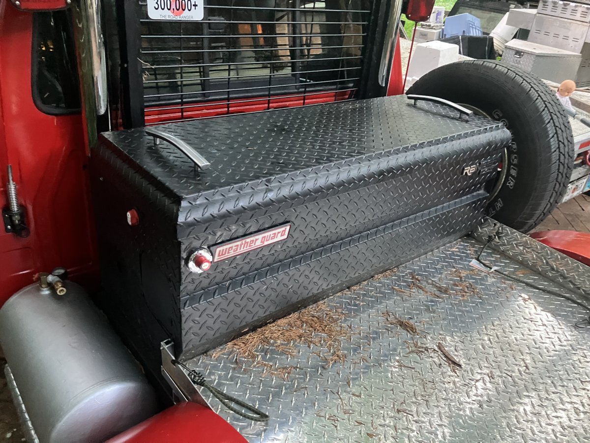

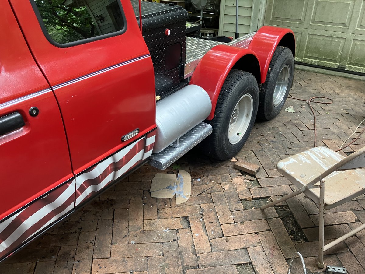

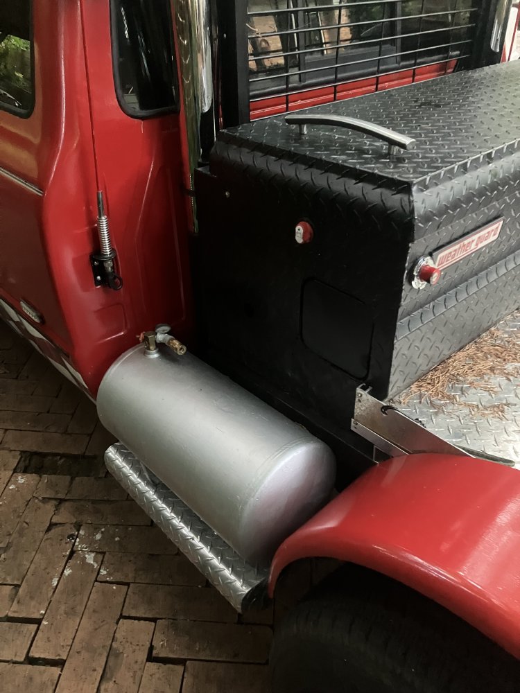

I think I made the brackets for this air tank five different times. I’d make something I liked, but it wasn’t strong enough. I’d put on something strong enough, and even for me, it looked like something wrecked from outer space.
I finally took half of my free toolbox lid, which I was going to put over the tank, and I made a rectangular frame underneath it out of 1 1/2 x 1 1/2 unistrut, welded. I used two pieces of angle iron to bolt to the frame of the truck, and had two pieces of unistrut, sticking straight out from that angle, also welded. I bolted the toolbox lid and frame to those angle brackets,
I could stand on it easily. Part of the plan all along was to have some kind of a little step built into this thing so I could get up into the truck bed when the trailer was attached. The spare tire is in the way on the other side.
I cut the handle off the tank, and I redid the valving. I bolted the 2 feet through the toolbox lid and frame, and on the other end I just put a 2” x 3” piece of tire tread to level it out. When I put the two bolts through the legs, I drilled the holes for the back a little bit offset towards the center of the truck. That way, I bolted the front first, and when I tightened up the rear bolt, it’s not only pulled the tank down, it pulled it/wedged it under the 2 x 2 frame I made for the truck bed. It’s snug as a bug under an anvil.

I’m going to mount a fire extinguisher above those air fittings. I’m going to make a little fill in plate to cover the exhaust stack, even with the toolbox, and I’m debating whether I’m going to run a permanent airline from the compressor which will sit inside the toolbox. The fun never runs out…

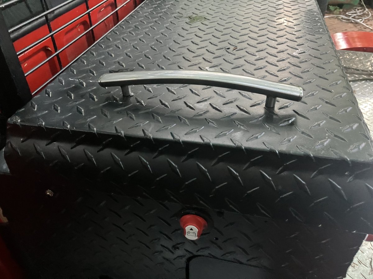

Actually, I needed the one handle on the driver side so I can use the new air tank step to get up into the back of the truck when the trailer is attached. The one on the passenger side is just for show, but it also allows me to tie something on top of the box if I ever want to do that.
The Road Ranger.  1997 SEMI
Does anybody recognize the handles? Yep, they’re from the doors down below a free gas grill I got (not the Jenn air for the ‘Raith). Guess where? Yep, Craigslist!
I positioned them so that when the box lid is up, they slide between the exhaust stack and the headache rack, so the lid will open all the way. On the inside, instead of just using a washer, I cut some very short pieces of aluminum angle and drilled them. They’re positioned so that when I pull on that handle to pull up my fat butt, it won’t bend the lid of the box.

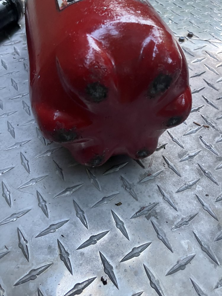

I called around to get the fire extinguisher filled today
@!”#%¥<€! Fire extinguishers services.
Although my tank was vessel tested and refilled in 2022, they no longer fill my style of tank with the flower pedal bottom.

I have a line on another one, but it’s a little bigger, and I’m going to evaluate other ways to get it filled since it’s not really for fire fighting, it’s just eye candy on the Rig
