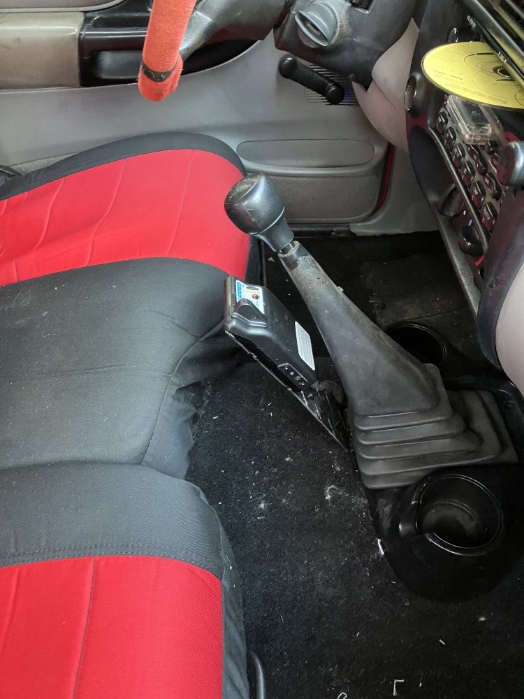

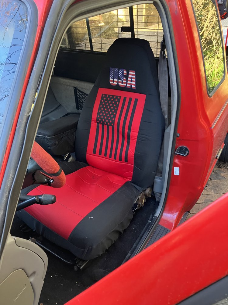

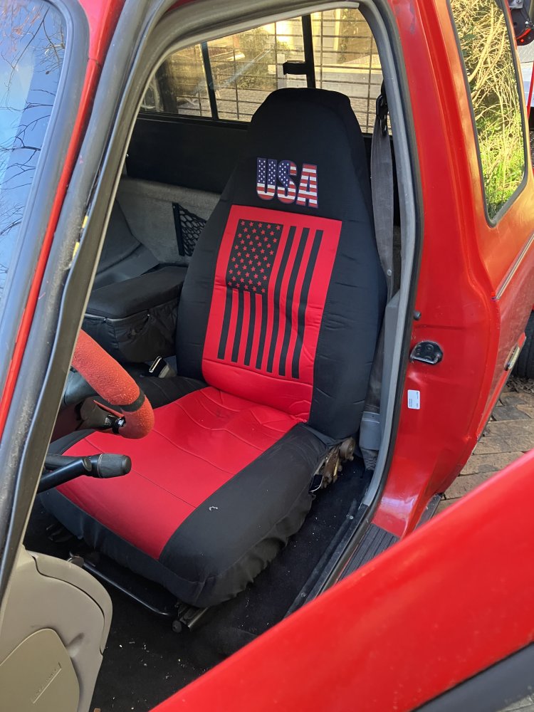

Trying to be disciplined, and not start more projects before I finish up some that are open, I finished putting the interior back together in The Road Ranger.
New carpet, I got the brake controller mounted just off the stick shift, and put the new seat covers on. It really looks good if I do say so myself.
View attachment 107299View attachment 107300
Always something more to do, but now I can drive it while I tinker. I was going to play musical vehicles in the driveway, and I don’t know what I did, but it was dead as a doornail, so it’s sitting on the charger now.

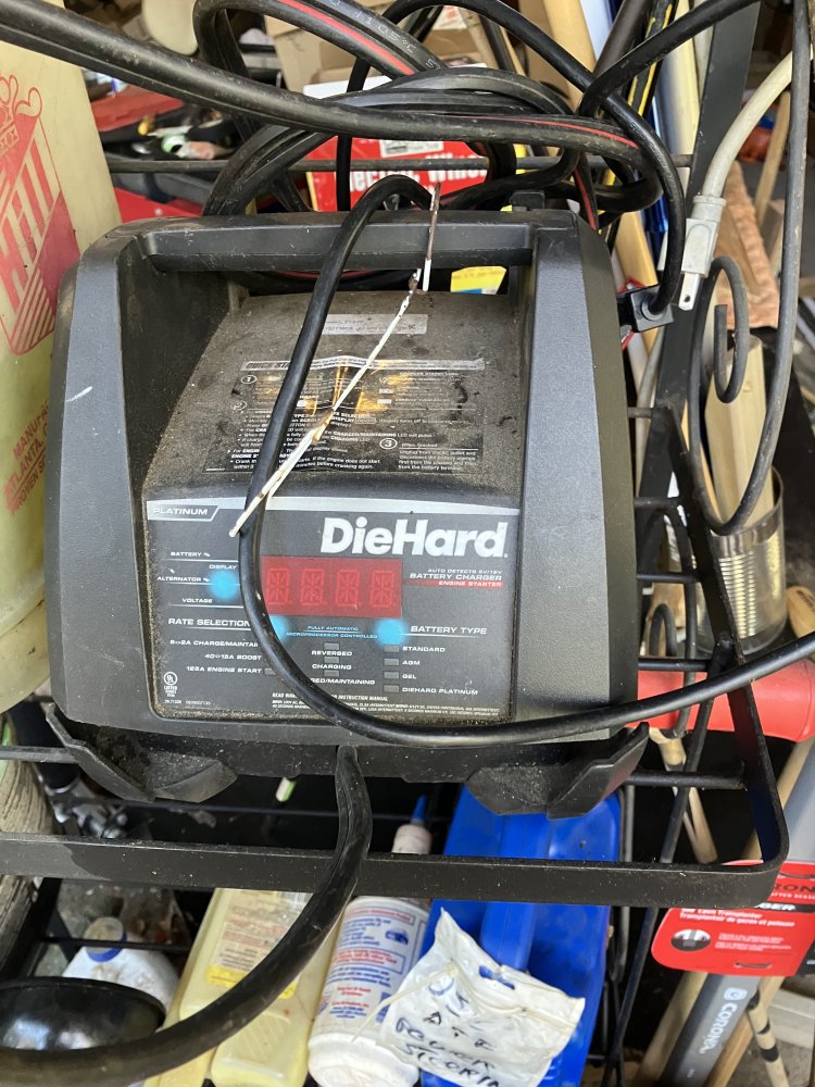

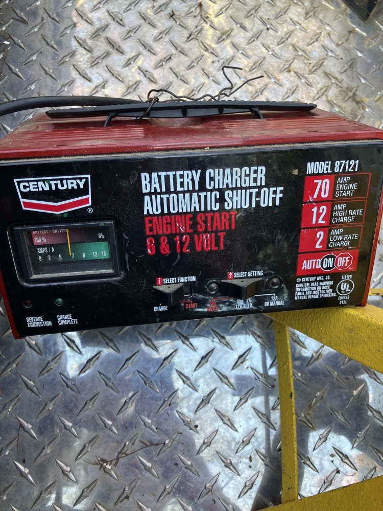

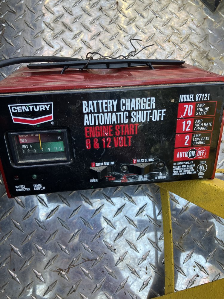

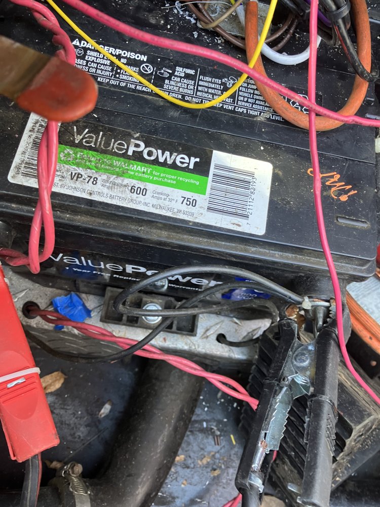

I used this older charger on the 2 amp auto setting, and it charged up the battery a little bit.
The Road Ranger.  1997 SEMI
Then I used my smart charger on the #2 battery overnight. It seems to be bringing it up to 6 V or a little bit more, and then seems to level out with a trickle charge. I think the smart charger thinks the battery is a 6 V battery at that point.
So now I put it back on the old charger on the 12 amp high output setting to see if I can jump it up to 8 or 9 V, and then see if the smart charger can finish it off. Neither charger has a manual 6v/12v select switch.
BTW, I checked the water level, no issue there.
Any thoughts on any of this would be appreciated.
It’s DRT (Dead Right There) Get a new battery. You’re wasting your time and possibly risking a fire trying to charge that.

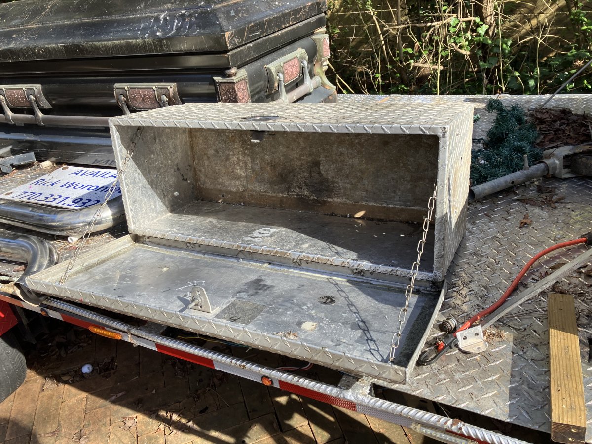

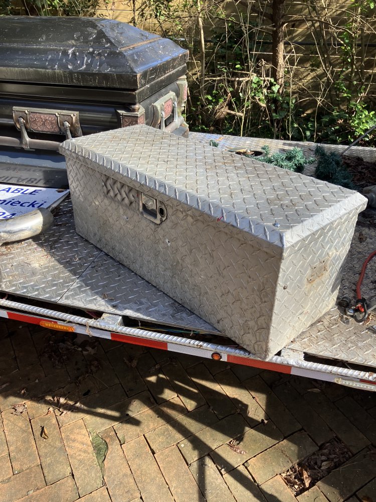

In an effort to clean up my shop, I actually made more progress on the step trailer. I had painted my $15 fold up ramps, but they were still leaning against my workbench inside. And I also bought this 30” toolbox when I bought the tongue box, both with some other stuff for $75 if I remember right, but no keys.
I’m going to turn this box sideways and use it as an under the deck storage box for a jack, and the tongue jack leg wheels, tire iron, etc.
The box had some handles on it, and a few random holes drilled in it, and it had a strut that would only allow the lid to open about 80%. I drilled out the handle rivets, took out the strut and ground out the strut supports, and straightened out a few dents.
I flipped it the way I’ll mount it, so the lid folds out and down. I went into the shed of miracles and got some quarter inch bolts, and a couple short lengths of chain, and I made lid support chains to hold the lid level when it’s down.
If I mount the face of the box flush with the frame, it will sit back about 6 inches from the edge. I plan on making a hanging sub frame, the width of the trailer frame. The box will sit on one side, and the two folded up ramps can slide in from the other side, and I’ll probably just use a chain and pad lock to keep them secure. I checked inventory in the shed of miracles, and I have everything I need to build the frame.
I ordered two 16mm toolbox locks with matching keys for the tongue box and for this box.

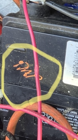

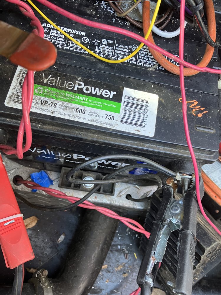

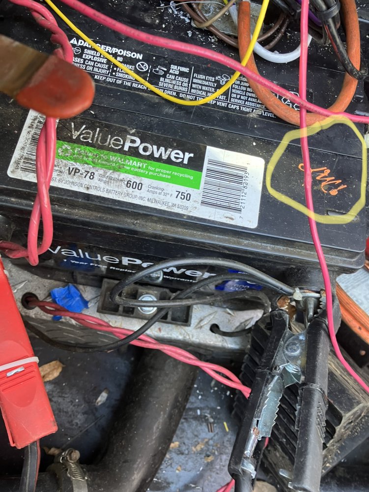

I looked a little closer, and this #2 battery was not my marine battery, that’s still in my garage as an extra. I got this one when I was doing the flying out the window, on the job design, of the whole Road Ranger extra battery in the toolbox thing, and I wanted a battery with the threaded side mounts.
But still, you think batteries just grow in magnolia trees down here?!?!?
I got this battery 3-4 years ago for $26.95 plus a core trade in. I think they’re $29.95 now with a trade-in. Do you think I’m just made of lead?

High light flipped over “PAP” = Pull A Part
If it doesn’t take a charge in the next day or two, I’ll stick the Missing Linc battery in there or the marine which was the original plan anyway. (on the Missing Linc, it still always starts, but sometimes it draws so much current from the old battery that the radio memory goes dead. I’ll get a battery before I start parking on hills to jumpstart it with the clutch.)

Your battery does have a little age on it.
Back when that battery was made, they put a gerbil inside to rub a comb through his fur to make the electricity.
Your gerbil has died.
I know it hurts to spend money, but the battery technology is so much better these days.
It'll be worth it.
It'll be worth it.
