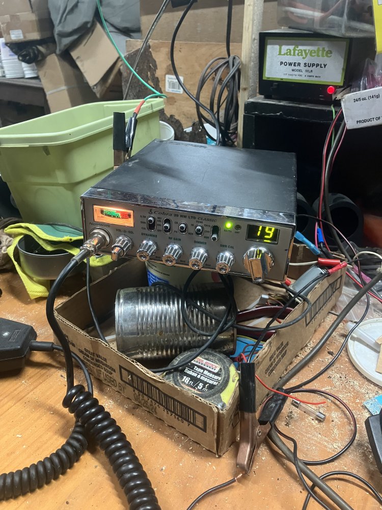

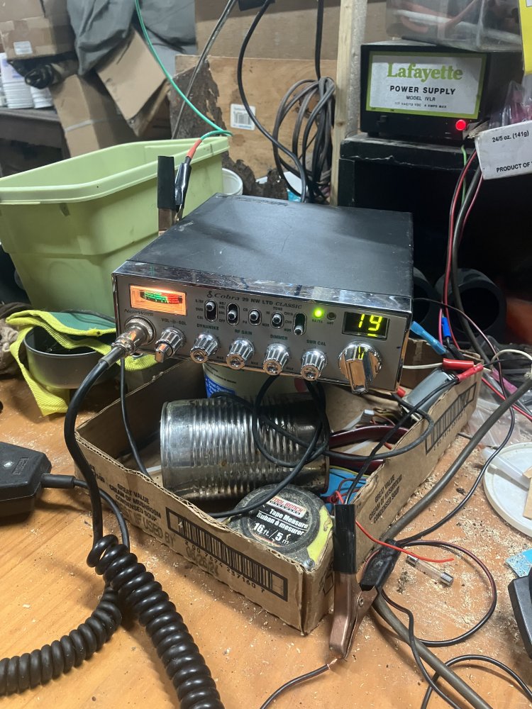

Sooooo, I went and checked the radio again. Before I pulled it out, I powered it up to check this and that. When I wiggled the new right angle antenna connection, the squelch noise would come on and off a little bit. When I held it in place with the noise and keyed the mic, I didn’t get the antenna light. I thought “aha,“ this will be an easy fix.

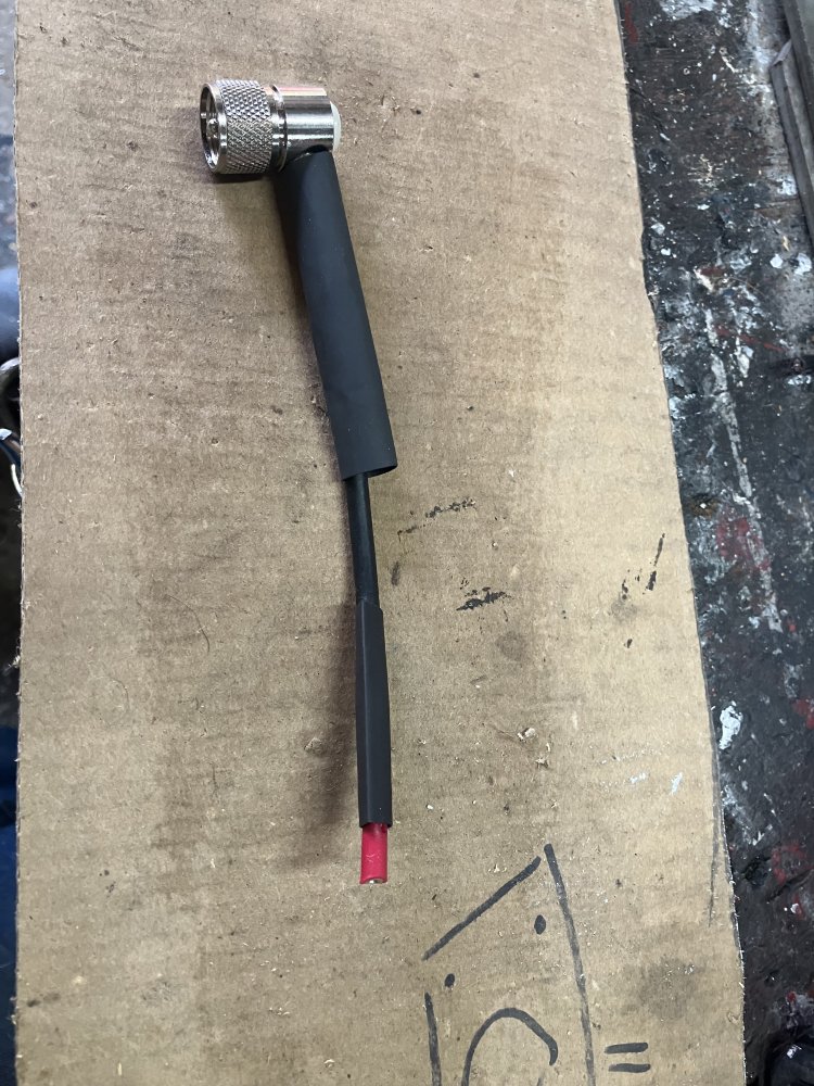

I made up another right ankle connector on the workbench, with more attention to detail than I think I’ve ever done on such a thing.
The Road Ranger.  1997 SEMI
I made the pigtail a couple inches longer than the initial one, so I could loop it around and connect it more easily, never stressing any wire. I know from past experience, adding a couple inches of coax isn’t gonna make a significant difference to anything. So I cut the old one out and put this one in very carefully.
When I powered it up, it eliminated the intermittent contact when I wiggled the antenna jack, so that problem was solved. But I still had no signal in or out at all. Wouldn’t you assume, as I have, that the problem is somewhere right there at that antenna connection?

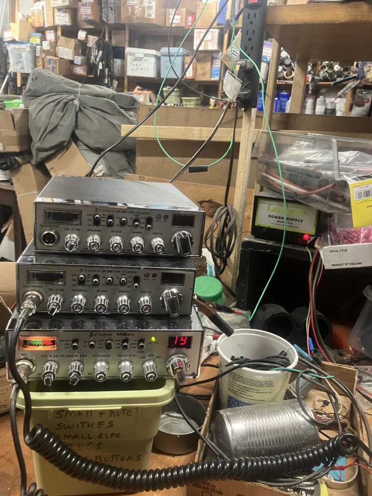

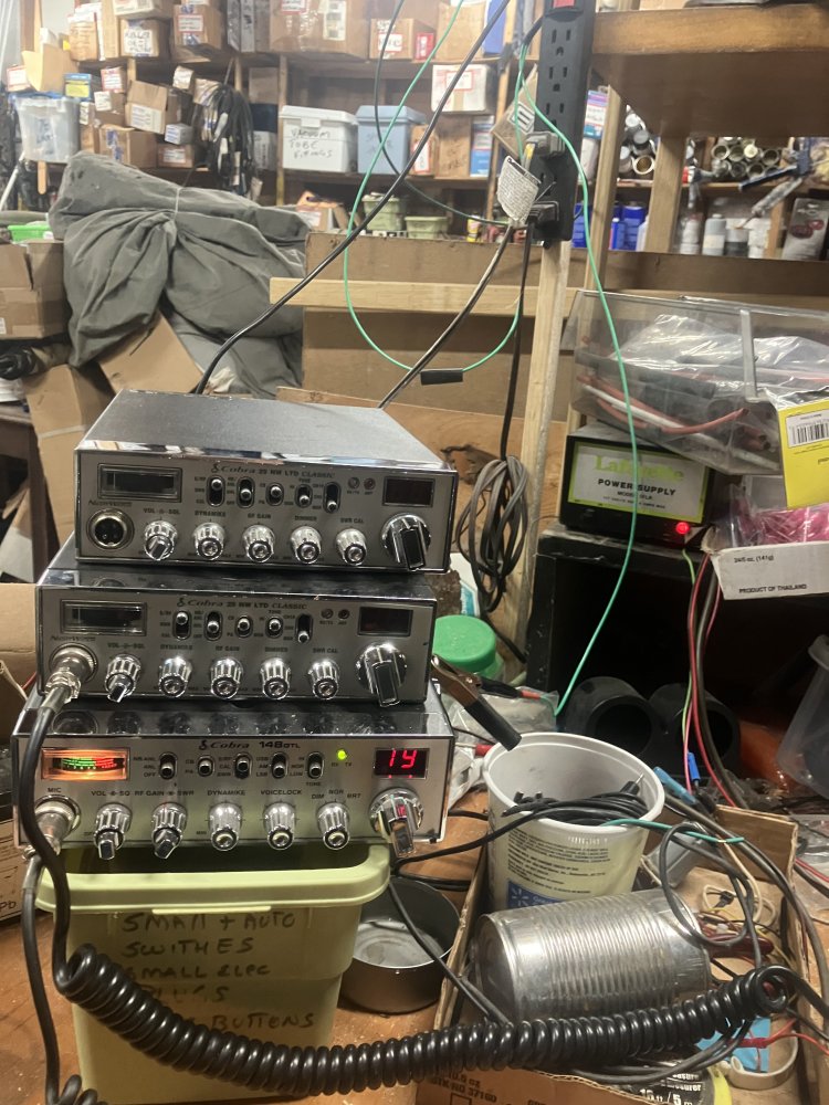

While I have the radio out, I’m going to check it on the test bench again, and wiggle the CB side of the antenna connector to see if that makes any difference. Even if it checks out OK, if I test it with the third antenna again, I’m going to try it with another LTD 29 before I put this one back in.

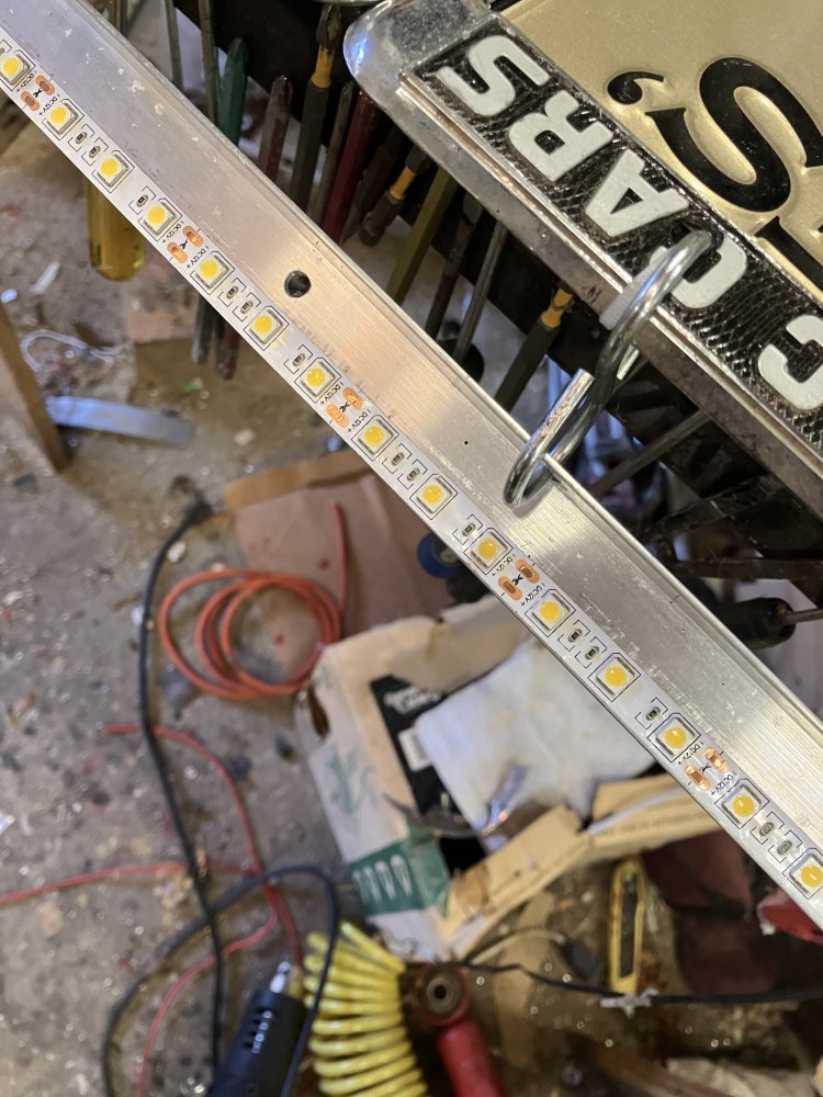

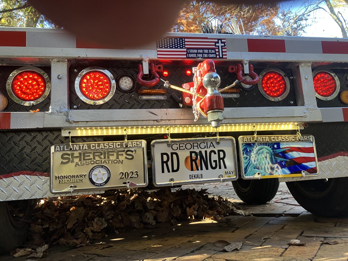

Not to be totally defeated, and it started misting a little bit, I decided to make my license plate hanger for the big trailer. I have the silly idea that I might actually drive this thing again someday and I’ll need a license plate.

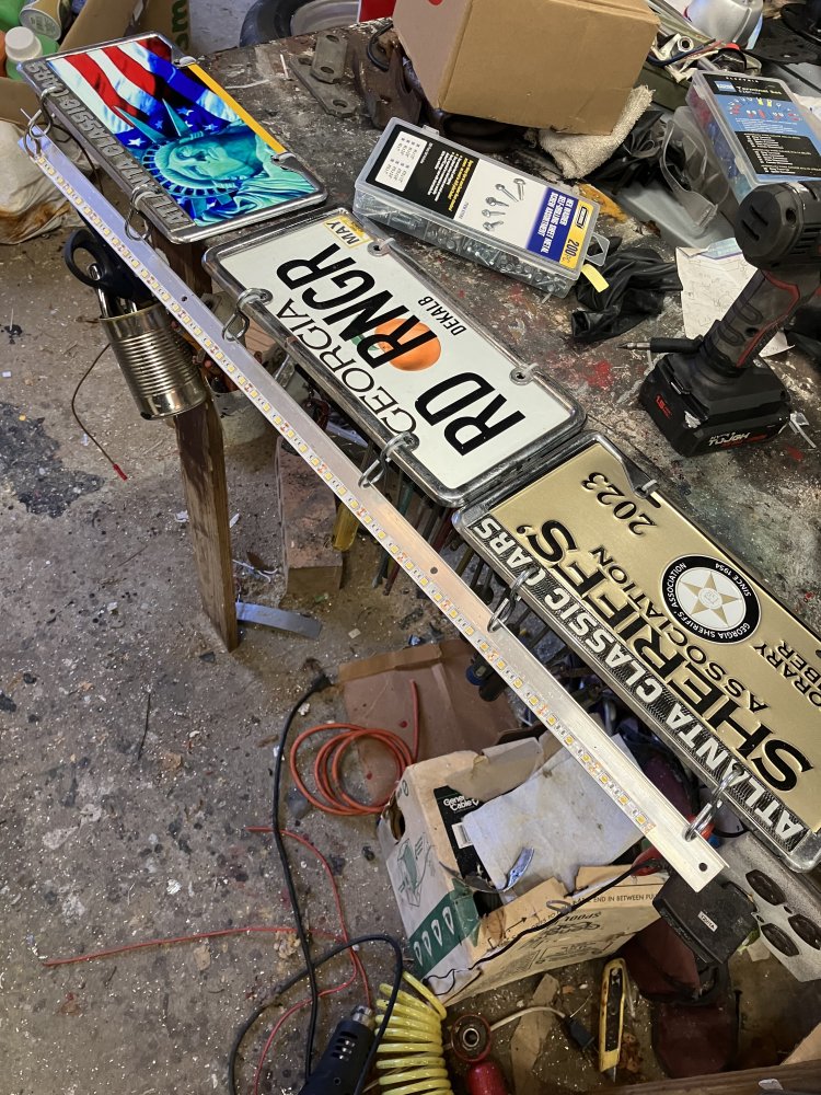

I used a “rattle plate” design I’ve used before, where I hang the plates off S hooks under the bumper. We used to do it on the company trucks were the tail is blind so we didn’t bend them up if we backed into something.
I took a piece of light aluminum angle about 3 feet long, drilled it for the three plates, cleaned it with lacquer thinner, and stuck about 30 inches of LED strip lights across the top. I soldered the leads for the LEDs, and then sealed up/insulated that solder point with some E6000 for installation in the morning. I’ll have a picture tomorrow. I’ll screw it to the bottom of the bumper with some self tapping screws if it’s not too wet.
Tah dah!

Last picture looks like the LEDs are facing backwards, but they’re actually facing down and that’s the reflection when I got way down on the ground to take the picture.
It’s such a bizarre feeling to do something one time and have it actually work the way I planned. I may do this more often.
& BTW, they all work on the bench.

I finally made up a 4ft fiberglass antenna from the communications junk corner with an 18’ cord and temp mounted it on top of the headache rack. LTD 29 worked fine, no antenna light.
The dual cable ohm-ed out even, so it is definitely antenna placement.
