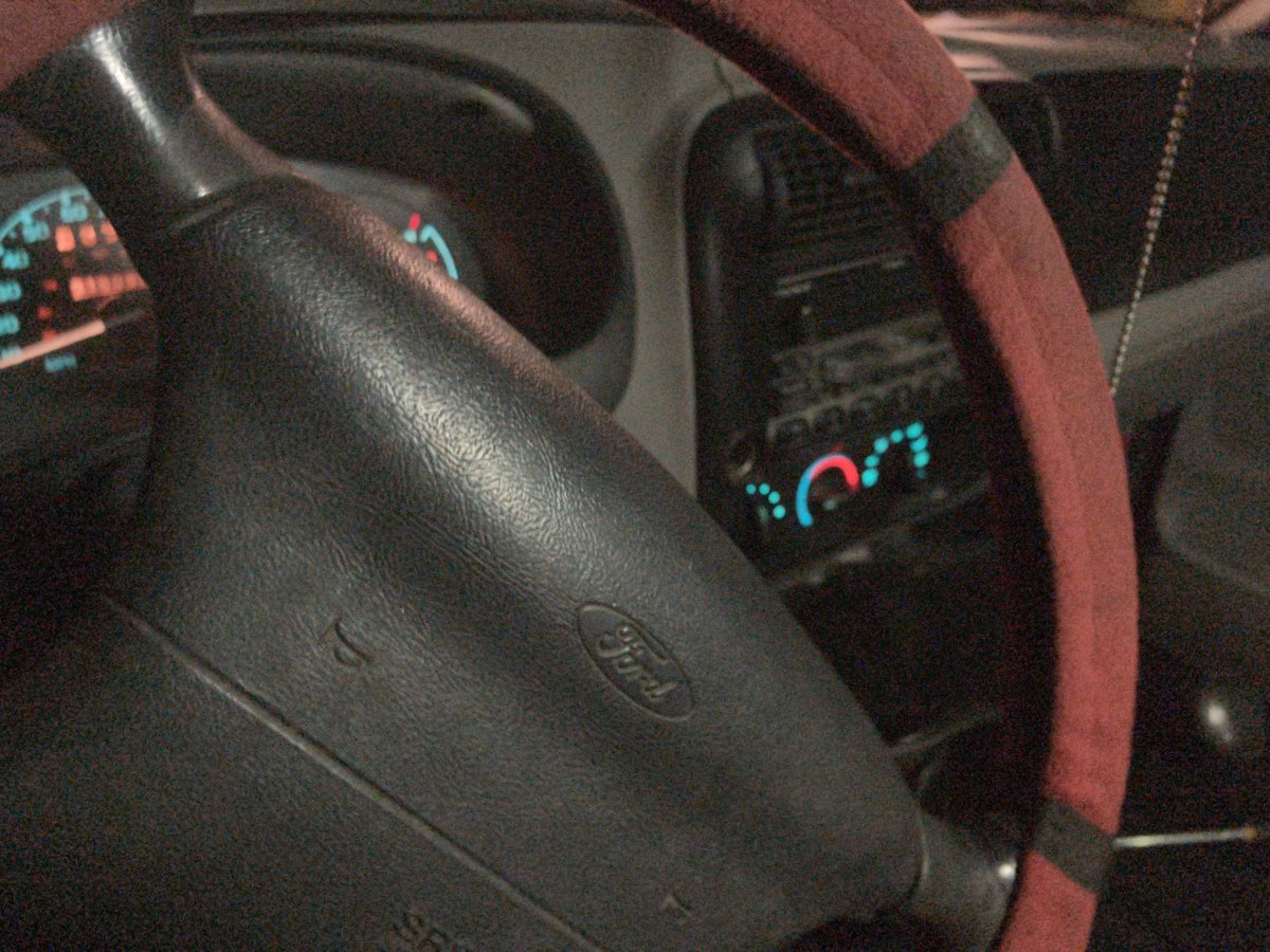

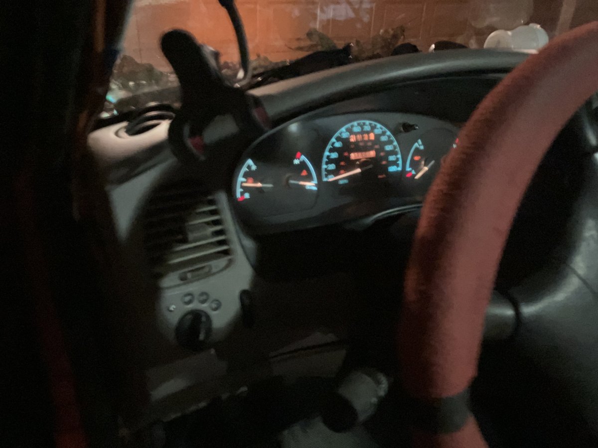

I also scrubbed all the pieces as I put them back in. Check this out.:
Did you guys know there was a turn signal light for left and for the right? Did you know that there are four gauges on that dash cluster? And with the lights, I can apparently drive twice as fast because the speedometer is twice as wide! It’s a silly thing, but you can’t even imagine how happy I am. I had to use a flashlight when I drove up for the 40th.

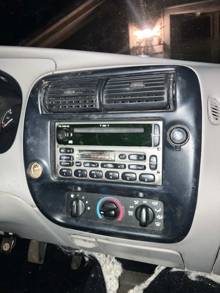

I was so high on excitement and adrenaline, I replaced the burnt bulbs in the HVAC control too:

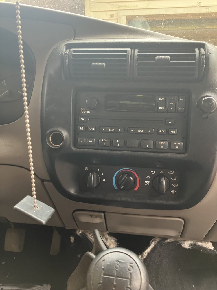

The last thing I did before I popped the center panel back in was to swap the Radio head. It had an AM/FM CD, but the CD didn’t work. I picked up an AM/FM CD with a cassette probably a year ago for 50 bucks with all the speakers. My radio was black to match the surrounding panel, and the new one is that silverish/Argent color, but I don’t think anyone would ever notice if I didn’t point it out.
Then Carrie helped me check out if the CD was working, and a variety of 60s rock groups helped me check out the cassette. 100%! For the second time I was happy the seats were out, because I was so excited about having tunes, I did a happy dance right in the middle of the cab! A little hard on my head.
Only afterthought is I forgot to check if the running lights on the radio are working when you turn the headlights on. That will have to remain a mystery for tonight.

Radio question:
Are the markings/buttons on those ‘97 radios supposed to light up when the truck lights or ignition is on?
Display screen works fine, but all the buttons are dark.
If they are supposed to light up, what should I check or look for?
