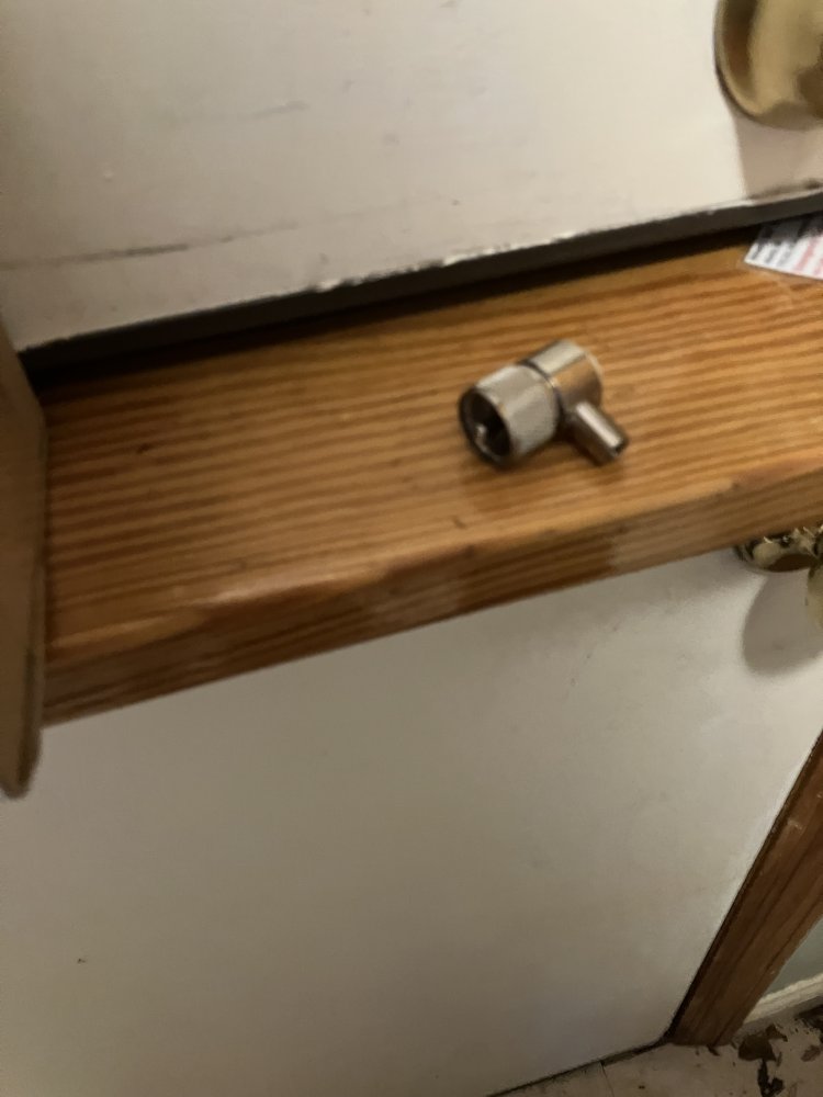

You may have pinched the coax at the PL-259. I know that you used to be able to a 90" adapter to help depth issues.

and I ordered three of the right angle PL-259’s last night
