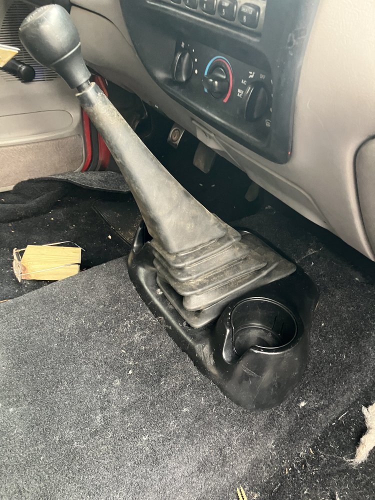

I’ve been misted/rained out for a few days, so no progress in the driveway. The next step is to trim the carpet around the stick shift and around the edges and put all the trim back in.

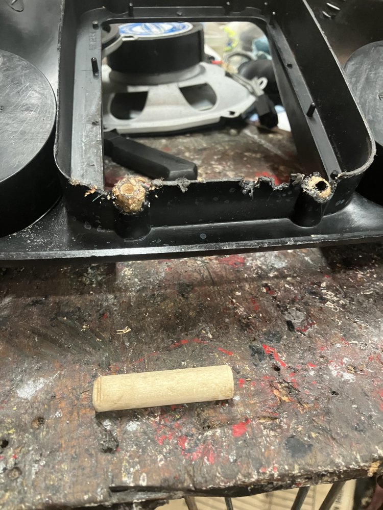

The front holes in the cup holder/shift boot were all torn out on the bottom side. So today I drilled them through at 3/8 inch, and I used super glue gel to glue in some 3/8”furniture dowels, the ones that are soft wood with the fluted sides. I’ve done it before, they stick like iron.
When the glue was dry, I drilled out the center the same diameter as the back holes, and used a little semi gloss black (yep) Rustoleum to make them disappear.

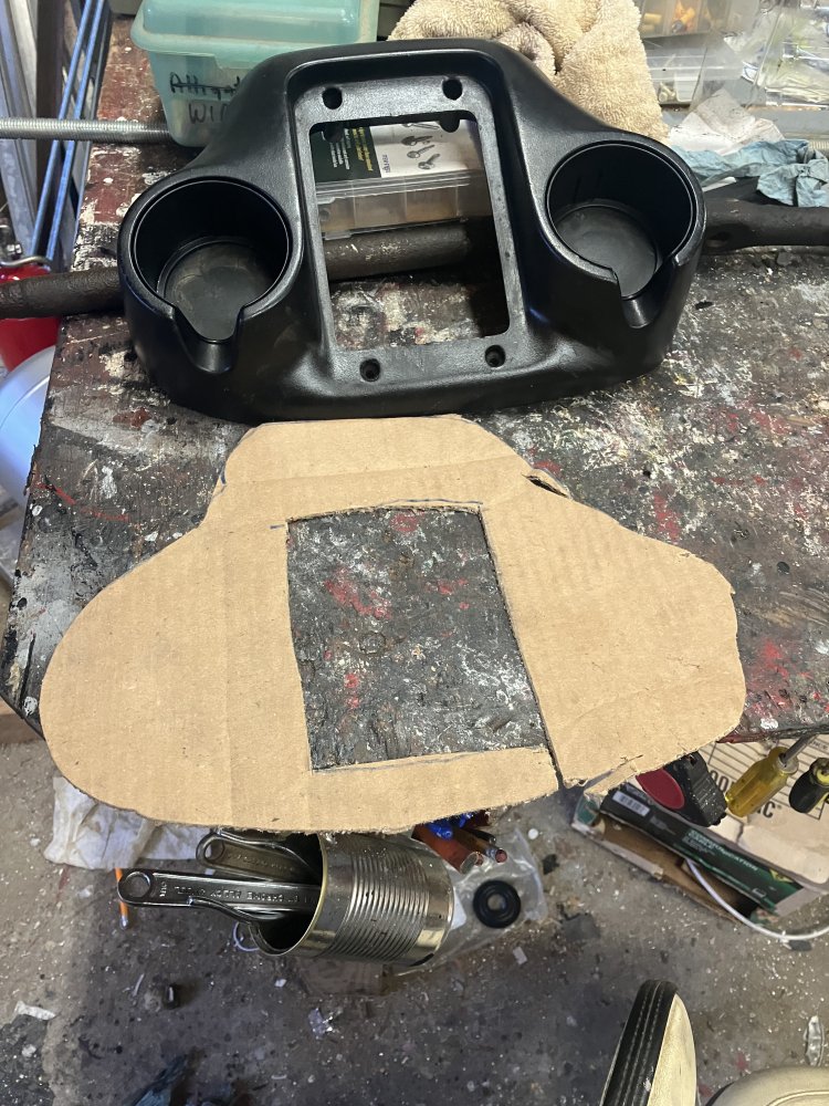

Then I made a precision template of the stick shift/cup holder piece (accurate to within 1 inch in any direction).

Ok, maybe one and a half inches.

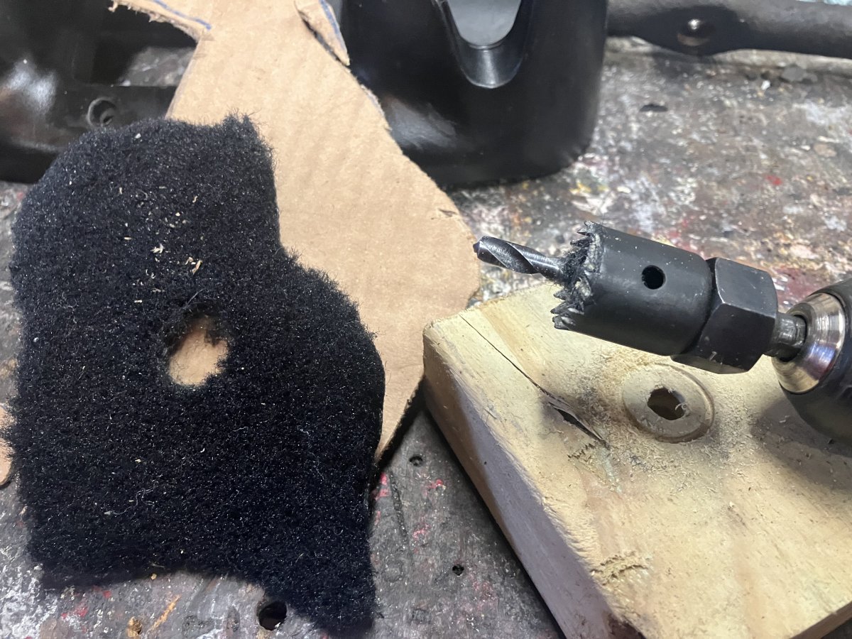

Then I started to cut out the carpet around the stick shift. Biggest challenge I had was to find something to cut the carpet (without cutting off my fingers). I ended up with a regular utility knife with a new blade in it.
The next step would be to set the seats. Positioning the seats, and then bolting through a new carpet, has always been a headache. I came up with this. I used an ice pick to locate the bolt hole underneath the carpet. Then it’s easy enough to mark both sides of the front of one seat. My plan was to then take a small hole saw, but run it in the drill backwards, to basically burn a hole through the carpet without pulling on the threads. I tested it with a scrap, and I was amazed to find out that I could just go slow in the correct direction. This will give me holes small enough to mostly disappear under the seat brackets, which are under the seats anyway, but still big enough to pull the carpet into the right place before I do the final tightening.
The Road Ranger.  1997 SEMI
I drilled a bigger diameter hole in a piece of 2 x 4, and then went slow with the hole saw. The plan is to do the same thing in the truck. Mark the hole with the ice pick, then a piece of chalk, then slide the 2 x 4 underneath, and then cut the hole. Put loose bolts through the two brackets in the front, and then use the ice pick to locate the holes in the back and do the same thing. It’ll take a little while, but every time I’ve done this (actually years ago) I always ended up with a couple of wild cuts. I guess a little patience has come with my old age.
Didn't know there was supposed to be a cutout for the cupholder doohickey. I just screwed mine down on top of the carpet.
Yes, the cup holder Doohickey actually sits on top of the carpet. The reason I made a template: if you look at that center square on mine, there is an elevated round rubber gasket dome thingamajig around the stick shift on the hump. The reason I wanted to mark it all with chalk was because I was having such a hard time cutting the carpet, I wanted to make sure I didn’t make any cuts that wouldn’t be concealed by the cupholder Doohickey.

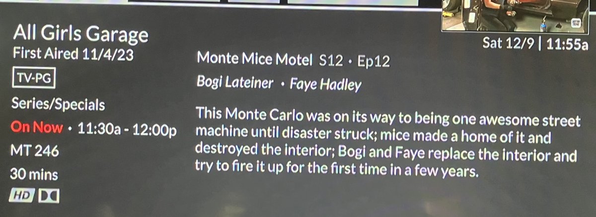

Lincoln was flipping channels while I was trying to nap, and ended up on “all girls garage” on MotorTrend. The episode had a very good section on replacing carpet, mostly on how you cut the bolt and wire holes so they look good and don’t fray, showing several different techniques. Maybe my luck is changing, but it was exactly what I needed to know. S12 E12:
EDIT: season 12, episode 12

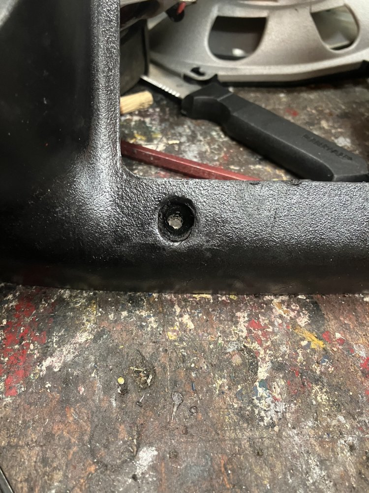

I patched up the drink holder with the baking powder/super glue trick a little while ago. Cutting the carpet proved more tedious than I thought, mostly because I couldn’t find a sharp enough knife to cut it easily. Once I solved that problem, the four holes through the sheet metal were so hogged out, I would’ve had to use lag bolts (Maybe a slight exaggeration).
On three of them, I used larger screws, but I had to drill out the drink holder thingy, and then also drill down from the top a little bit, where the screw head sits, so the bigger screws would sit right.
Those three were plenty snug, so on the big hole, I used the trick where I take a sharp point nail set, and I worked around the four corners of the round hole to drive the metal in a little bit. I gently put the screw in and it held, but it probably would not have held long if the other three didn’t hold it so firmly.

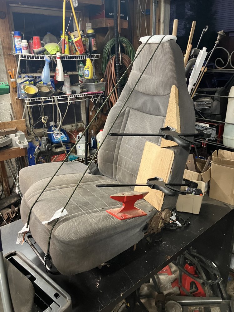

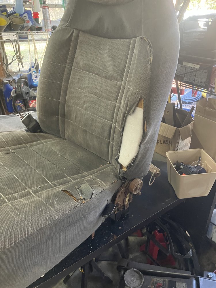

Today was more thinking what I was going to do next, but I took the seats and put them on the work table and checked them out. The passenger seat is an excellent condition.
The driver seat mechanically is in great condition. It had a little bad spot on the outside of the bottom cushion, and there was a chunk out of the bolster on the vertical cushion about the size of a pack of cigarettes.
I got a few pieces of high density foam from the shed of miracles, and used my bandsaw to shave them into oversized plugs, the same shape as the holes, after I cleaned up all of the rough edges in the holes. Then I used some of my highly sophisticated upholstery equipment to hold them in place after I glued them.
The hole in the seat was about the size of a half dollar, so I just used the anvil to hold it down until the glue sets. I used the E 6000 stuff, and I have a couple of pieces of fabric similar to the seat fabric that I’m going to glue over the holes before I put the seat covers on. Hopefully that will be tomorrow.
I took the plastic caps off both seats, and I painted them with satin black Rustoleum. The carpet is black, and the sides of the seat covers are black, so that seemed to make sense.
Patching and plugging came out okay.

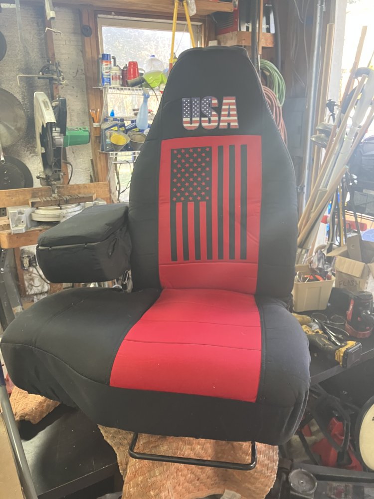

Then I focused in on the recliner mechanism, and that bar that keeps the seatbelt right if you move the seat back-and-forth. Driver side was fine with just a little bit of WD-40 and white lube.
On the passenger side, I had to take it all apart, fix/straighten some things that have been creatively engineered in the past, and put it back together. You never know, but I think he was a skinny dude, and she was a fat girl. I thought it was going to be a one hour job to put the seat covers on, and like everything, it turned into four. But…
It looked great when I got it together. The suicide seat even looks better than the driver seat.

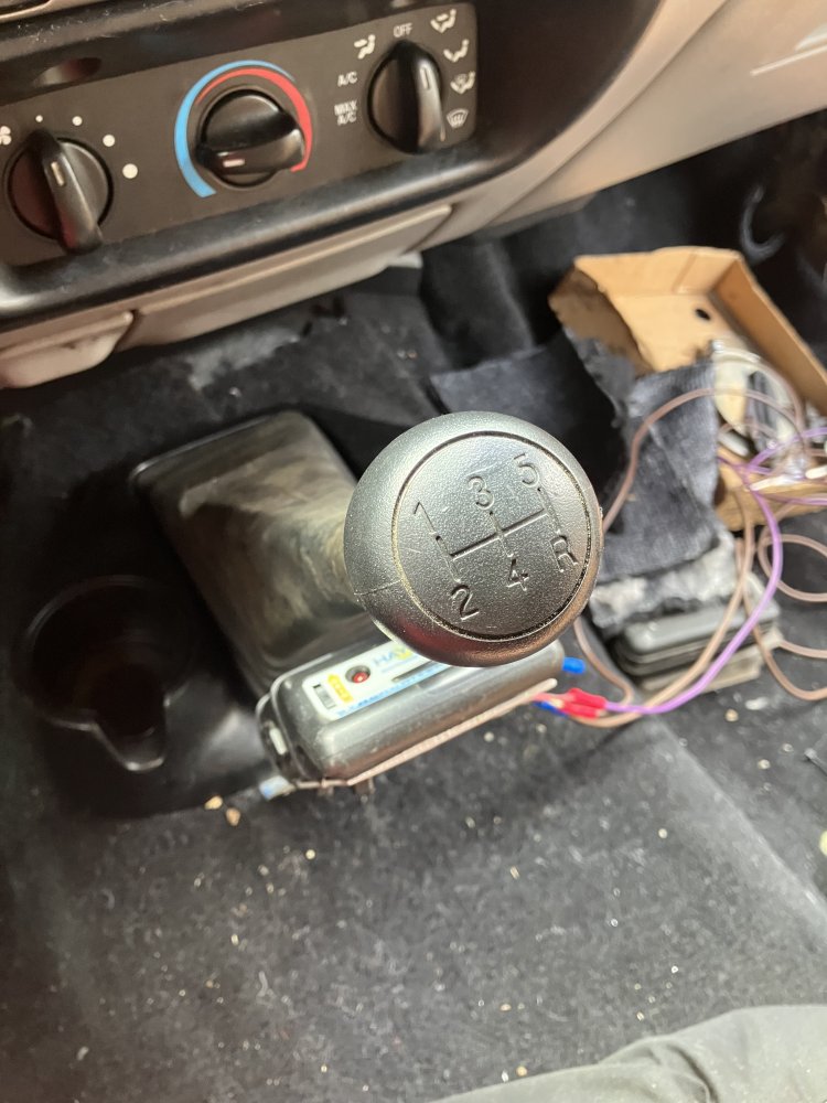

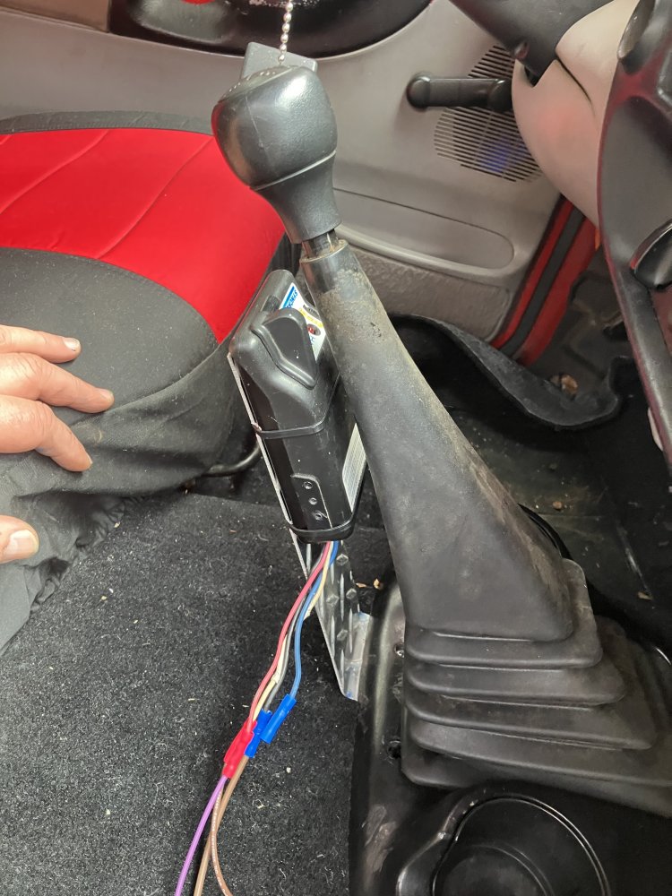

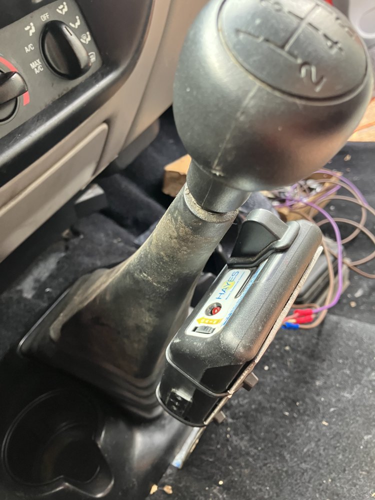

I also spent some time on the brake controller for the trailer. I can’t find a good spot where I’m comfortable using it, while I’m driving a stick shift. I even thought about mounting it on the shift handle, but I can’t figure out how to do it so it would be at my fingertips, which is what I want.
In that 97, there is a fold-out 12 V socket next to the pull-out ashtray. I’m thinking of putting the brake controller there, upside down, tied into that 12 V power source. I would love to hear ideas and suggestions from anyone who’s done it.

Depending on how your center dash is setup, could you mount it on the bottom in front of the stick shift? There was room enough to mount my GMRS radio there but that area changed a lot over the years.
Great idea, I’ll check that

The judges have voted, and Rick W and Lincoln are in third and second place, respectively, and the highest award, the blue ribbon goes to
@sgtsandman !!!!!!
for outstanding achievement, in assisting the design of the brake controller bracket!
I still have to adjust it a little bit. I want to make it just clear the shift boot when I’m in second, fourth or reverse, but it’s exactly what I wanted. I have to bend it a hair, and paint it black, otherwise a done deal.
THANK YOU SIR!!
