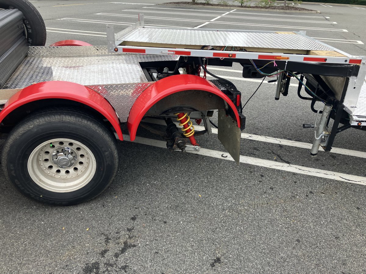

If you make the shock geometry worse by moving the top pivot forward and lower, it'll take less force from the axle to cycle the suspension, that's my only cheap idea for the moment :)
Are you saying if I angle the top of the shock forward over the axle, it would still work, but it would give me my 8 inches of axle travel?

Again, the problem is not to hold anything up, but rather to keep the axle down when there is no load on it.
The 8 inches was picked out of the blue anyway with the concept that if I backed over a curb, the rear axle would raise up, and I wouldn’t lose traction on the drive axle. After thinking about it, I probably don’t need that much travel. If I ever get hung up, I could simply let the air out of the back axle tires. So 3-4” is probably plenty.
Right now I’m thinking of grabbing a shock I can just bolt in, and playing with it
Changing the angle of them won’t do as much as you think. A coil over mounted at a 30° angle is 86% effective, and if mounted at a 45° angle is 70° of it’s effective rate.
It looks like you’re already at about 30°, even changing that 45° won’t amount to much of a change in spring rate.

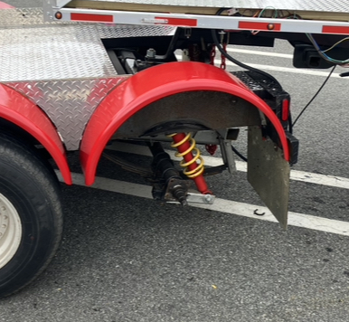

I’m thinking that instead of a light spring, you would need a real heavy shock.
A shock will not support any weight unless bottomed out, just keep the axel from bouncing.
I would think a heavy shock like from a half ton or so would be heavy enough that even when you hit a pot hole the axel wouldn’t be able to bounce around.

Thank you, but again, that is academic. The only purpose of the spring in this location is to hold the axle down, not to hold the truck up. The axle is on a leafspring below, a pivot arm above, with shackles between the two, and the two are mounted at different points on the forward size (4-link that floats).
My goal is to eliminate the bounce of the axle when it is not loaded. There is no problem when it is carrying a load.
That makes sense. When I hit a big bump, I don’t care if it bumps a little, but before I put these coil over, shocks on, it was bouncing all over the place. It pulled straight, but was constantly bouncing up and down.
That’s exactly the purpose of a shock, to stop the car from bouncing around when going over a bump.
The springs are just there to hold the car up off the bottom of the suspension travel.

The current coil overs I got from the Toyota crossover are about 20 inches long. I went hunting all over the Internet for some inexpensive shocks that were of similar length.
Turns out coincidentally that the rear shocks on a lot of full size Ford products from the 80s are 21+ inches long, 12 compressed, with about 8 1/2 inches of travel. Those numbers are from memory, but that should put it in the range of what I’m looking for. Very close to what’s on my 87 and 88 town cars.
Rock auto had some closeout shocks for under 10 bucks each, so for a little over 20, and no effort, a pair will show up in my mailbox.
