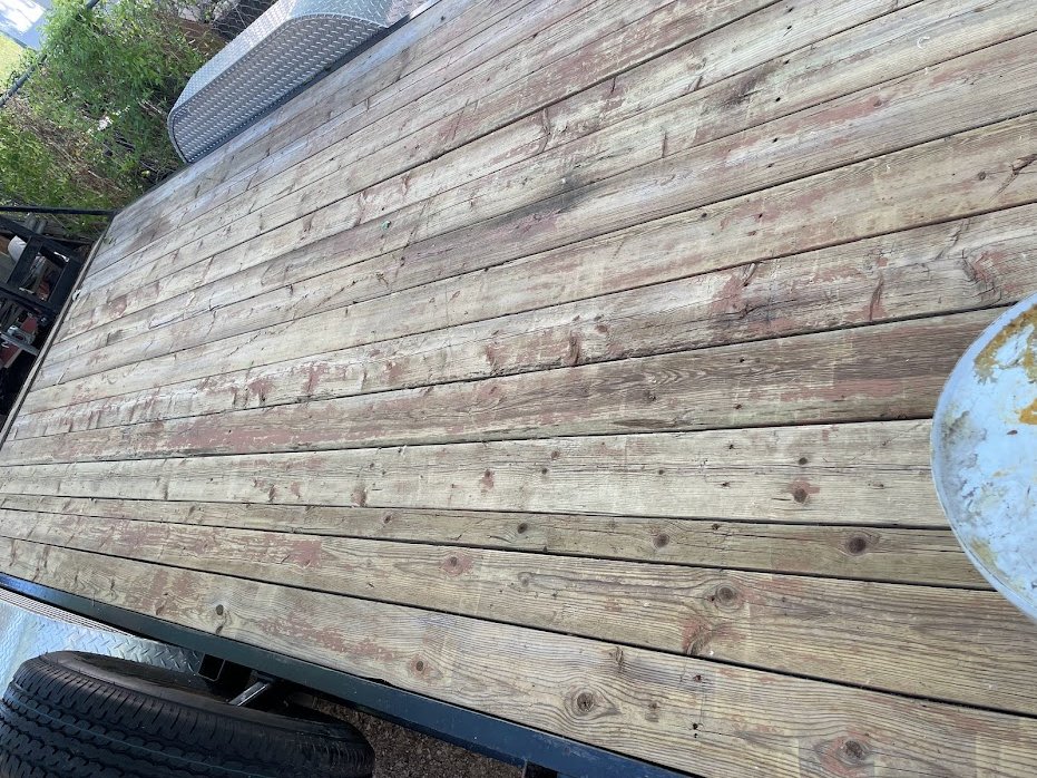

Just cuz I like talking about it, here's some pics after I brushed a lot of linseed oil on my trailer. After pressure washing, 2 days of drying:
The Road Ranger.  1997 SEMI

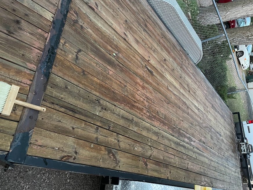

Linseed oil applied:
There is a joke about wood and oil in there somewhere...
