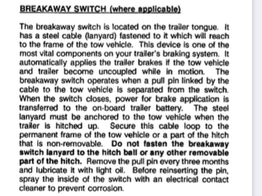

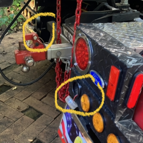

Ok. I’ll bite. If the coupler comes loose and the trailer is sailing off into the woods, where are the lights getting power from?
I was researching the trailer core’s origin. It’s a 1995 Coleman pop-up made by Fleetwood who subsequently went bankrupt in 2009. Only the name survives.
But I found the original brochure, and I also found the owners manual.
@ericbphoto, read over the emergency break away section, and then re-read my post above where you were mocking me! I believe an apology is in order…

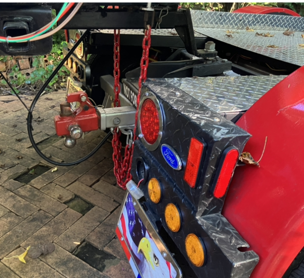

That’s the answer, as long as everything is connected properly. I’ll go through my photos and make sure you had the cable lanyard secured to some non-removable thing on the truck.
Everything is removable… it all depends on how much effort you wish to exert and what tools you have at your disposal.
If this case, if you would look at my welding skills, @ericbphoto would be correct…
Hey. It held together from Atlanta to Carlisle and back. Your welding can't be too bad.
My welding, and my welds, are like living in the wilderness with a woman after the apocalypse. Pretty would be nice, but even with the bumps and cuts and ugly, what’s important is that it holds together, gets you home, does what you need.
I still want to get underneath and look if anything has shaken loose. I’m going to check the truck and trailer too…

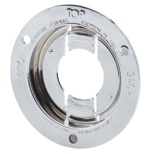

The holes I drilled were too big for the rubbers I had, and this happened:
The Road Ranger.  1997 SEMI
Does anyone know where I can get some reverse light Viagra?
