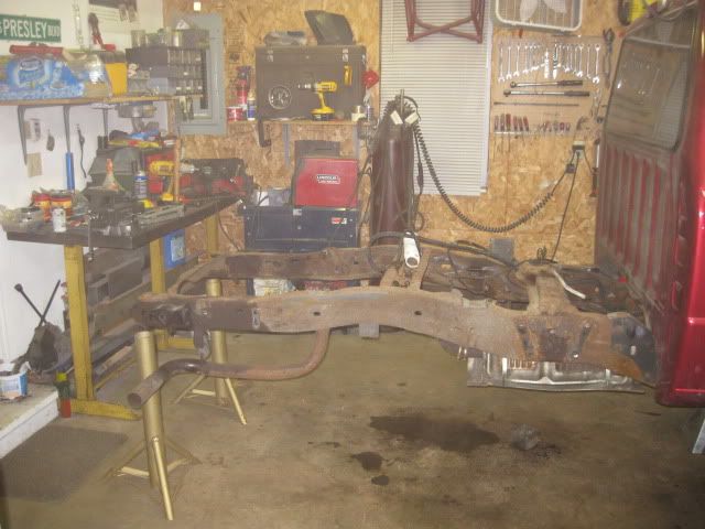

Flipped around 3/10/11 looking like this:
The Lone Ranger – Kage’s ’94 X-Cab Leaf SAS and Bed Bob
Now it gets to gaze out of the garage into the neighborhood:

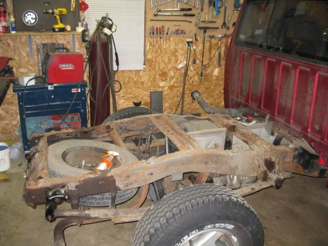

Then it was time to start attacking the rear, which stared out looking like this:

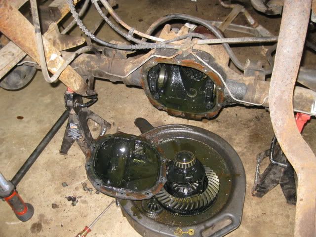

Pulled the carrier out of the 8.8 for the 3.73’s (the moostang is getting a gear swap in the future):

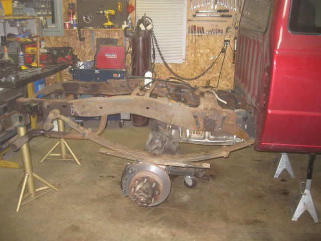

Rolled the D60 roughly into place around 115” WB:
And placed a spring on top of it to get a feel for where it wants to live:
I need to do some more reading on the 63/64” springs. It seems like there is more arc on these than I was thinking. Unless they flatten out quite a bit with some weight on them, I’ve got a feeling I’ll be hacking up my rear body mount :annoyed:
I’m still somewhat optimistic that I can get the rear mocked up enough this weekend to figure out spring placement. If anyone has any good links about using these springs and running around 4” of lift, feel free to share them.
