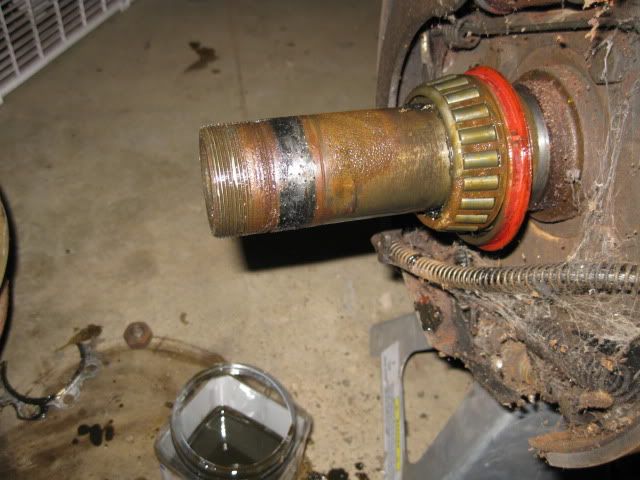

At some point in its life, it apparently spun a bearing and destroyed the spindle on one side.

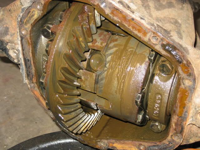

While this can be fixed, an inspection behind the diff cover revealed that the pumpkin was full of water for awhile:
The Lone Ranger – Kage’s ’94 X-Cab Leaf SAS and Bed Bob
Which at that point, I cut my losses and scrapped this one out. (Lesson 1 learned).

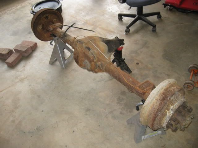

The second axle looked pretty good on the inside and on the spindles:
But once I started hitting the housing with a grinder, some sever rust damage started to show its head. This made me decide to go ahead and scrap this axle (Lesson two learned).

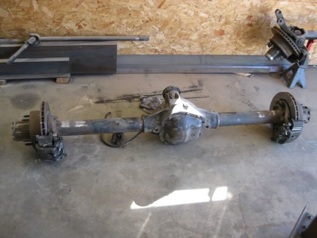

Axle number 3 came out of a ‘99 E-350 van that a friend had bought for his project (he later wound up going 14 bolt so this axle was taking up space). ’99 was a changeover year to the metric bolt pattern. Thankfully, I got lucky and this is one of the early ‘99s as it has the standard 8x6.5 bolt pattern.
As an added bonus, it already had disc brakes from the factory. Unfortunately, it did not have the calipers (which weren’t cheap!). This is actually a Dana 60U, the U denotes a smooth bottom of the pumpkin. The axle also has the larger through bore spindles, so if I find myself snapping the 32 spline shafts, I can upgrade to 35 spline shafts without the hassle of boring out the spindles. It also has the larger (and thicker?) tubes over a standard Dana 60.
When I brought it home:
I went through, cleaned it up and slapped the calipers on it Everything looked good other than a leaky wheel seal:

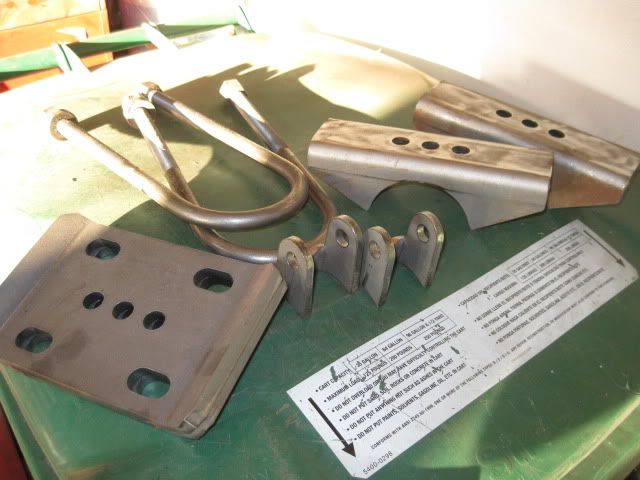

I picked up the Ruff Stuff Dana 60/70 swap kit as I was feeling kinda lazy and didn’t really want to fab up the leaf perches. Plus what Dan charges for some of this stuff, it isn’t worth it to make it myself. Pre fabed stuff means projects go faster :icon_thumby:
(Ignore the rust on there, I bought it back when they were having the end of the year sale, so its been sitting awhile):
Eventually I’ll weld it onto the axle after I get the doubler installed so that I can set the correct pinion angle.

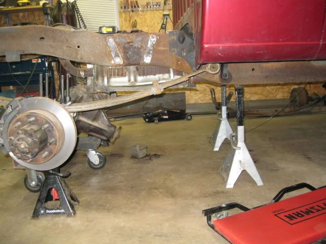

Rear Test fit and Chevy 63’s

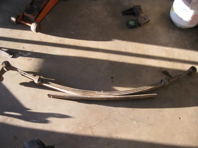

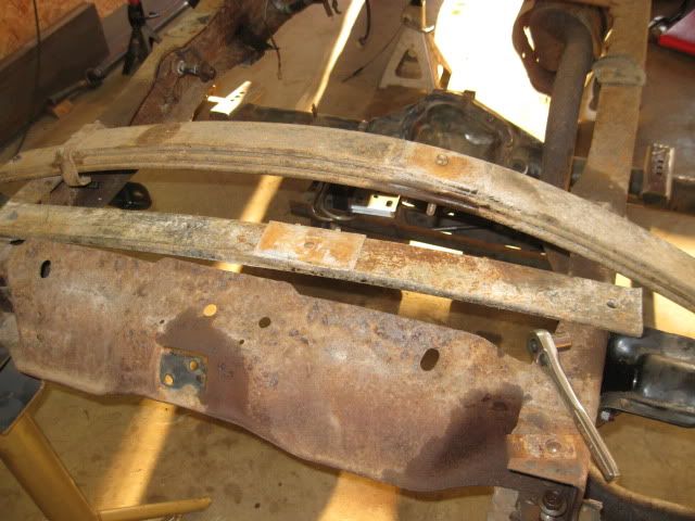

For the rear, I decided to ditch the standard Ford springs and go with the Chevy 1500 rear leaf pack. These are a cheap way to lift the rear 3” when left in the stock location. Not that it matters since I’m moving everything around anyway.
I grabbed the stock pack off a 2wd which has 3 leaf’s and a overload:
Pulled the overload off:
And now the pack looks like this (The overload is about .75” by itself):

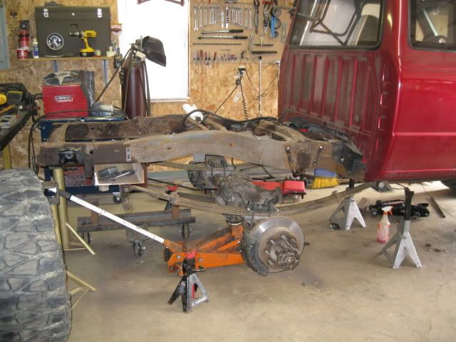

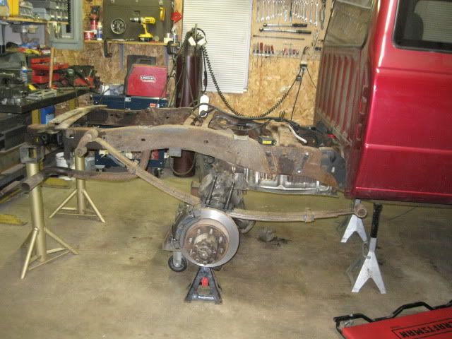

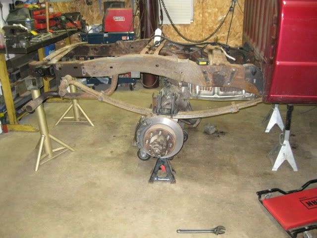

After that was sorted out, I played around with where I wanted the rear springs to live. Thanks again for all the suggestions guys!
All of the following photos are with the WB set to 115”
At first I played around with how much angle I’d be comfortable running on these springs as Ideally, The spring eye’s should be about level with one another (From what I understand). So I laid things out like that:
That got me a little nervous as it looked like that rear body mount was going to have to change quite a bit and I’m just not real excited about that prospect (Probably because it took waaay to long to get the dang cab lined back up).
So I tilted the springs so that I could clear the body mount which netted me more of an angle than I liked:
At this point, I realized that trying to fit leaf’s with no weight on them isn’t getting me anywhere fast. So I went ahead and tightened up the U bolts and put some weight on the springs. At which point I had a “Kyle M” setup going on.
Hub center is at ride height:
Much to my surprise, this looked pretty dang good, but gave me to much lift in the rear though not enough that I couldn’t tweak it to where it needed to be. But then I got out of my brain fart and realized that I need to stuff a BII fuel tank between the rails so that idea was nixed. :icon_twisted:
I think I’m going to do a hybrid of the ideas. That being out boarding the spring to the stock spring width, but mounting the front spring eye low enough to not interfere with the cab mount. I’m going to sleep on that tonight, but I think that’ll work.

Quick update for today (I'll grab more photos tomorrow and throw out alittle more information).
It appears that I was worried for no reason, once I had some weight ont he springs, the spring pads leveled out enough to make me happy with the angle they were sitting at.
Everything else went out the window though. I wound up mounting the front of the springs like this (further foward than I thought it would be):
Then I put a piece of C channel under the frame to support the rear springs (where the shackels will go):
Somehow everything worked out. It looks like I'm not going to be able to do a shackel flip at this time (no time/budget to get the leaf's re-arched). The rear shackel needs to be about 7" long, so that makes life stupid easy for getting the shackel done.
Nothing is burned in at this point, but I'm fairly happy with it so it may stay like it is.
