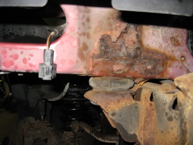

-Had some rust repair to do on the rad core support (not bad enough to replace the support, but annoying) also had to fix one of the front body mounts.

Core support Rust Repair:

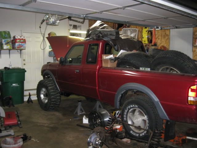

I jacked up the Rear of the truck to get some measurements off of it:
The Lone Ranger – Kage’s ’94 X-Cab Leaf SAS and Bed Bob
Frame rails should be 22 - 1/4"
Front Frame rail looks to be 27 -1/4" (1/4 too high)
Rear Frame Rails 30" (1" too high)
So I'm really close, and not doing too bad seeing as how I started on 2/15 with this, and I'm working alone.

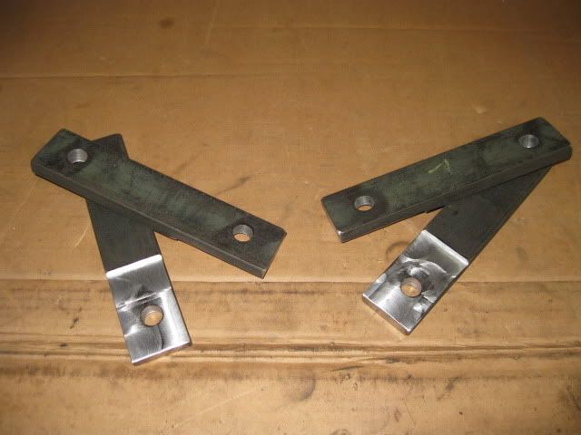

The front shackles wound up being a bit overkill. I used 1.5 x ½” thick material to make them. The holes are at 5” center to center, and I milled out 1/8” per side to get the correct offset (Waggy bushing measures 2.75” and the YJ bushing measures right at 3”). There was some .120” 1 ¼” Tube laying around that I made the middle spacer out of.
Parts:
Welded up:

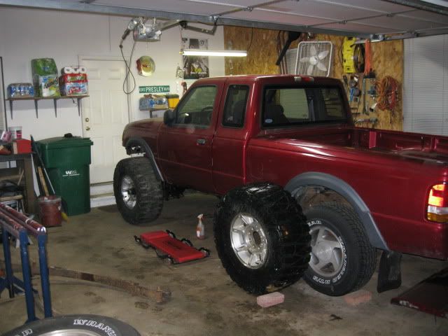

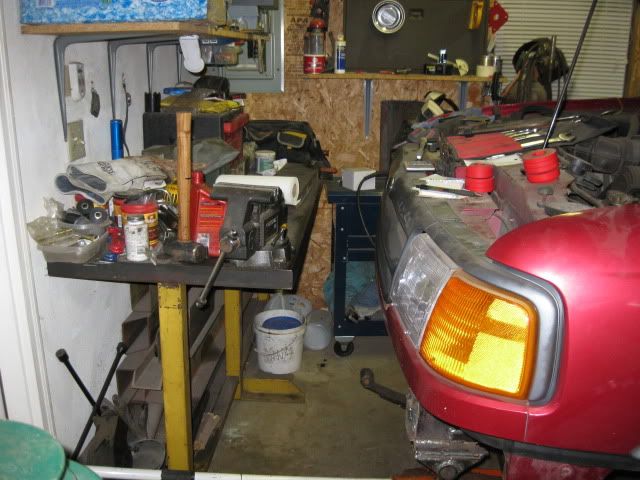

At this point, I can wheel the thing around the garage some, which is awesome, as I’ve been working with this much space in the rear:
And this much space in the front:
Needless to say, I’m itching to get on with the bed bob just so that I can easily walk around the thing with the garage door closed (its been cold and wet here lately).

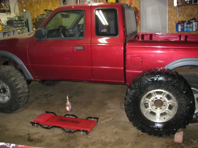

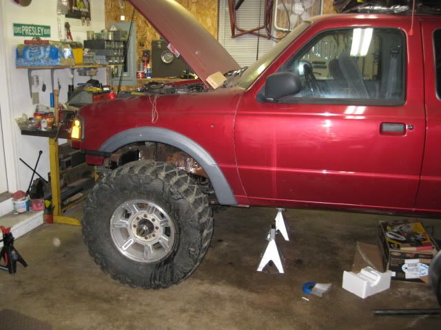

So we’re sitting like this as of right now:
I jacked up the rear to take a few measurements (see above one post) to see if this thing is going to be close to legal when I’m done. Thankfully, I’m pretty dang close.

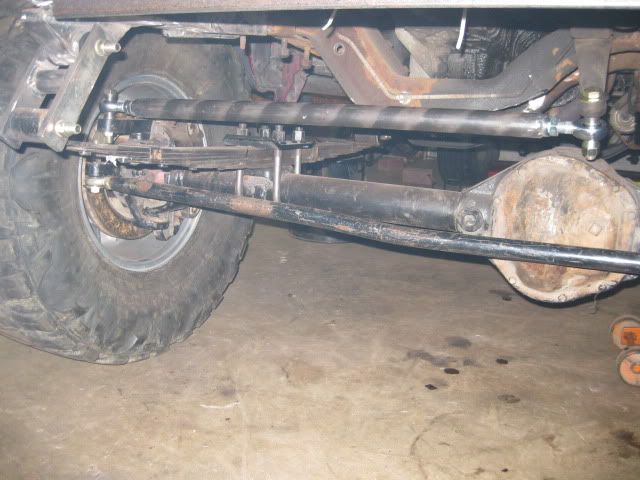

Then things started going down hill. I cut my Drag link and got it welded up. Unfortunately I cut the dang thing shorter than I wanted to :annoyed: So that's $40 worth of wasted parts and material. At least the angle looks good
With the drag link in place, I cycled the steering around some. It looks like I might have some interference between the Drag link and how I was planning on running the tie rod. Not real sure what I'm going to do about that just yet. I need to do a little more looking.
It also looks like I fat fingered my order from Poly Preformance, as they shipped me the wrong steering arm for the 44. Not a big deal as I can still move the truck around, but just another annoyance.

are you going to move the tirod up top once you figure the draglink/tirod interference issue out?
That's the plan. The tie rod that's on there now came with the 44 when I bought it. Its scary flimsy. The tubeing is thin enough that I can literally bend it over my knee. But it'll work well enough to spin it around.
i figured you were, just wanted to be sure. It does look a little skinny lol

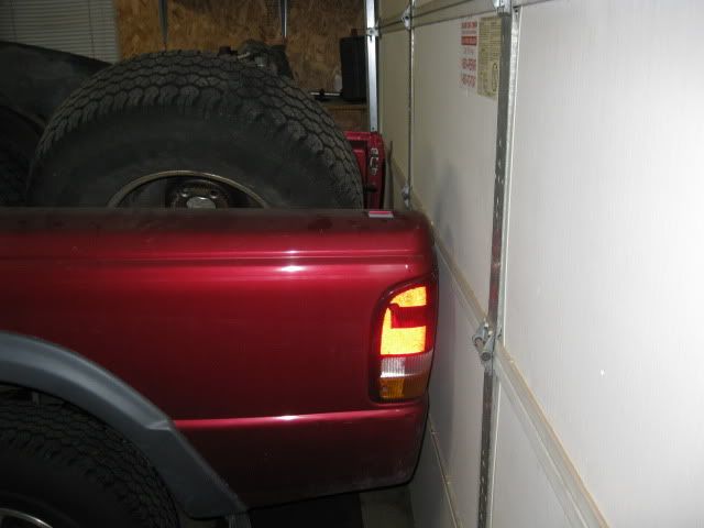

Before pulling the bed, I took some measurements to try to figure out where I want the rear axle to wind up sitting, as well as what my final wheel base would be. Ideally, I’m shooting for 110-115” WB when I’m done, time will tell what it winds up being. Note that the truck isn’t sitting level in these photos so that screws up the perspective some.
115” puts me here:
110” puts me here:
I’m still really hoping 110 will work, but I’m not sure if the rear cab corner is going to play nice.
After I got done zoning out while looking at my pretty tires/wheels, I kicked the wife’s car out of the garage to pull the bed off. With some help from a good friend, we managed to rip off the bed without much effort..
