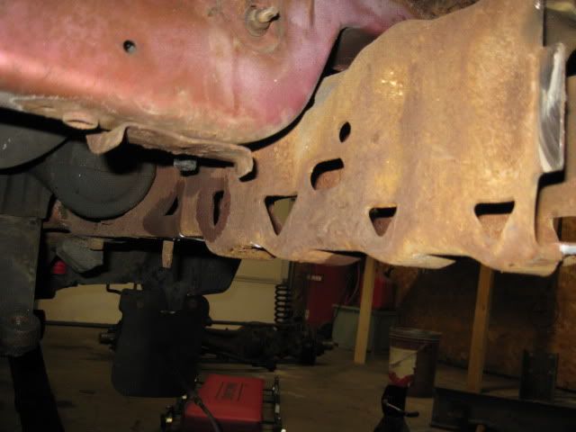

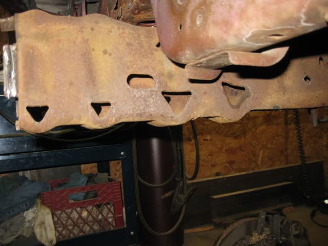

Front SAS – Plating the Crumple Zone:
This is one area I wanted to document as best that I could as there seems to be varying opinions on how much to plate over this area. I’m of the belief that the more the merrier since you’re turning an area that wasn’t designed to be a load bearing area into a load bearing area. :icon_twisted:
That said, even with the crumple zone as it is, that area will take a fair amount of abuse before it crumples.
What is the crumple zone? It’s the area that is meant to give way during an accident to absorb some of the impact. We’re going to modify the heck out of it, so do so at your own risk :thefinger:
Before:

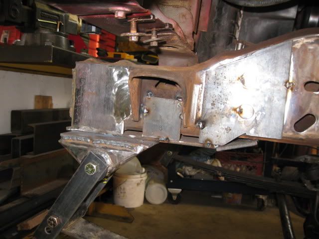

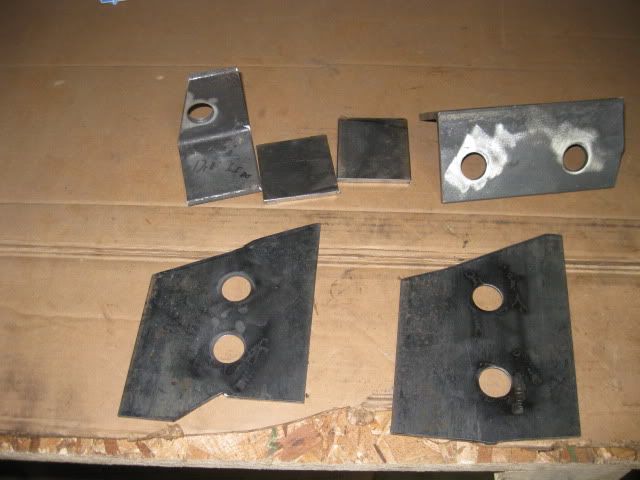

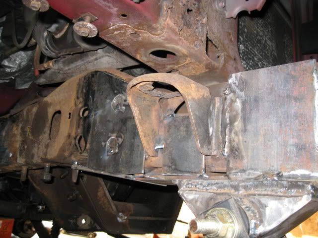

Most of the plating consists of some 3”x3”x ¼”angle iron, ¼” plate, and 3/16” plate with some additional angle and plate to span some of the gaps.
Some of the Plates:
The Lone Ranger – Kage’s ’94 X-Cab Leaf SAS and Bed Bob

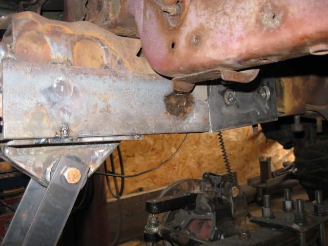

Cleaned off as much rust as I could and tacked the plates on (I had already welded on the 3’X3” angle so that I could mock up the front leaf mounts):

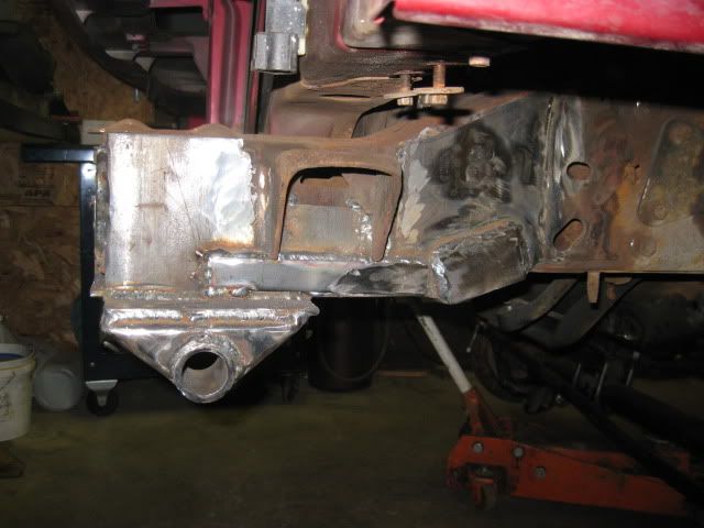

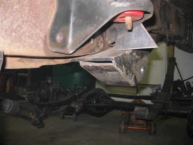

I then burned the plates home and added some additional support to finish boxing in the front further. Probably a bit overkill, but I figured the more metal the mo-betta it is :icon_thumby:
Disclaimer: Welding upside down sucks… Also, I will add some guessets to the front leaf hangers, I just haven’t decided yet if they’re going to be part of the bumper or not. Same goes for the front cross member. One is going on, I just haven’t got that far yet (need to figure out how my winch is going to work out in there).
I'm pretty happy with the outter frame rail platint. on the inside, it should be more than beefy enough, but if I find myself pulling the radiator out (and power steering box), I'll probably add some more plating in the inner frame rail areas just for a little more peace of mind.
Up on deck next is the finial welding of the rear leaf mounts, then some rust repair one the rad core suport! Yea! :annoyed:

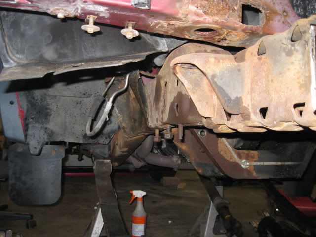

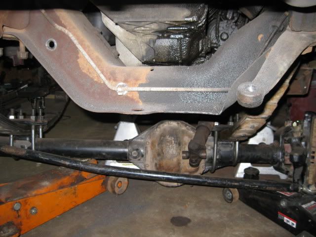

Front SAS – “K” Member Trimming:
As with most SAS’s, the K member needed to be trimmed up some to make room for the high steer linkage as well as some clearance for the pumpkin under full compression. Since I’m running full width axles, I don’t think I’ll have to get too crazy with the trimming. While I had the axle out of the way, I figured I’d take a whack at it to get started on it as it was easily accessible. I won’t know if I have to trim some more until I can really put some weight on it and flex it out fully.
Before:
Light Trimming:
The brake line is going away, so no worries about cutting it up :icon_twisted:

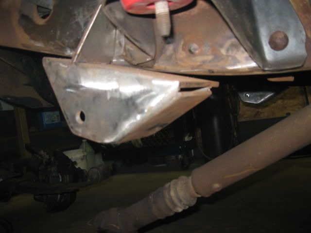

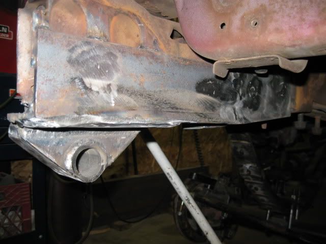

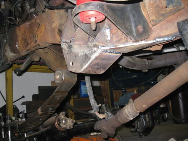

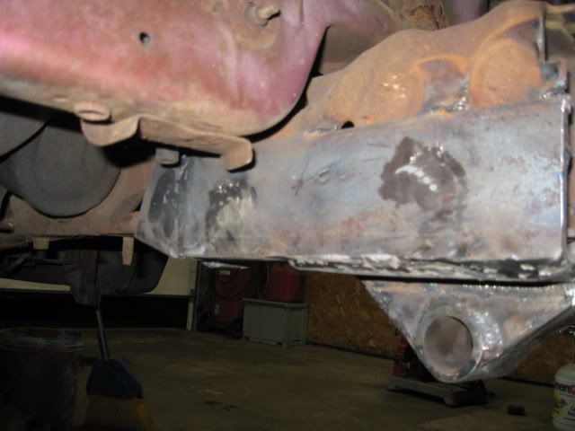

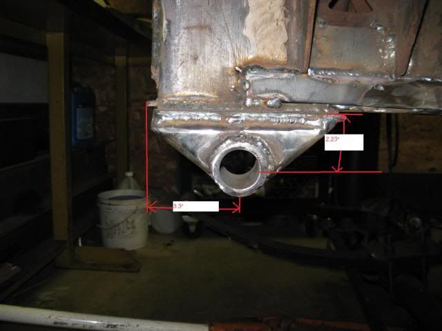

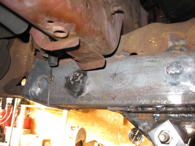

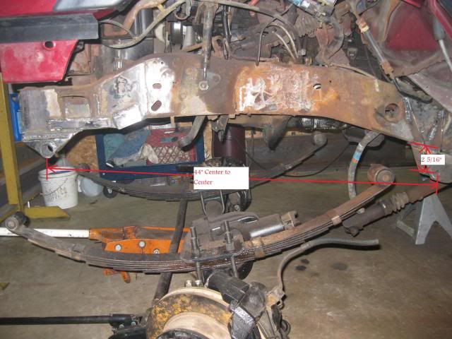

Front SAS – Final Leaf Mount Burn in:
Well I passed two milestones tonight, the leaf mounts are fully burned on. And I somehow managed to lay some decent beads upside down :D
Locating the mounts was a bit of a pain since I’d moved (or removed) just about every item that I could use as a good reference point on the frame. So it took a few tries to get it right. So if anyone is looking for numbers in the future, here’s what I wound up with…
Front mounts – Center of the hole is 3.5” from the very front of the frame horn, and 2.25” down from the lowest part of the frame (the bumps in the crumple zone):

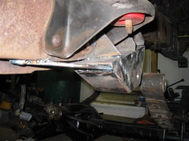

Rear Mounts – The center to Center measurement of the holes is 44” (I’m using stock Waggy springs, so your spacing may need to move). The center of the hole is 2-5/16” below the frame (Measured perpendicular to the frame):
Font Mounts:
I’ve already shown the majority of the front mount welding in a prior post, so I wont rehash that here. I’ll update this post when I finish the gussets on those mounts though.

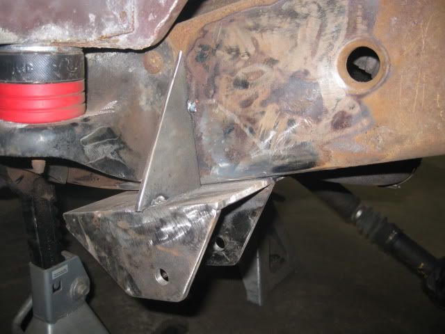

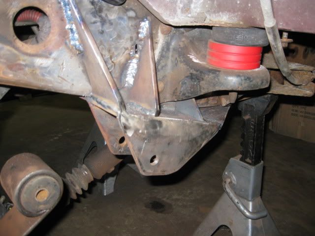

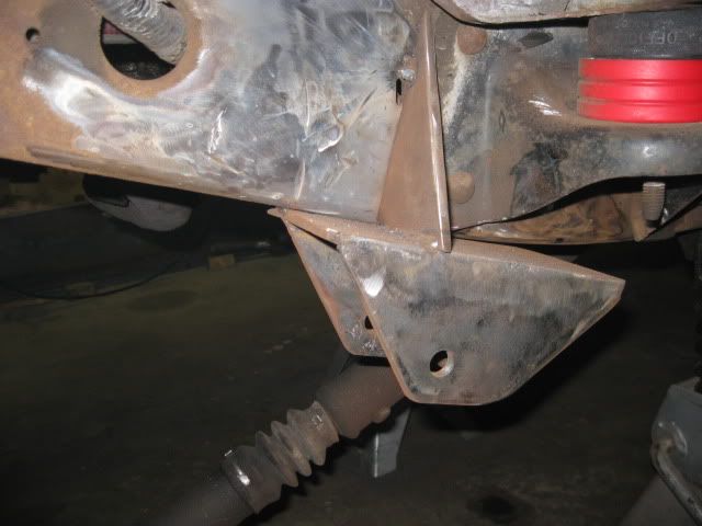

Rear Mounts:
I tacked them in place to make sure everything was happy..

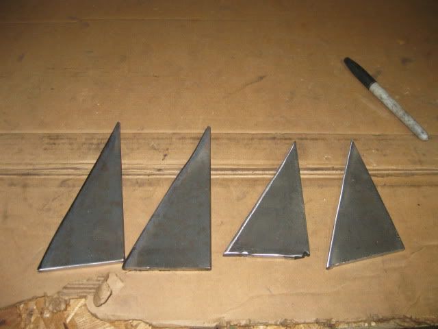

Then I cut out a few more gussets (Cutting gussets by hand SUCKS!):

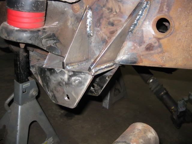

Then it was time to burn everything home: (Don’t forget to move your brake lines and fuel filter! They live on the other side of the frame rail in the below photo).
And I’m semi proud of this. I actually managed to lay down some pretty beads upside down. Maybe practice pays off? :icon_welder:

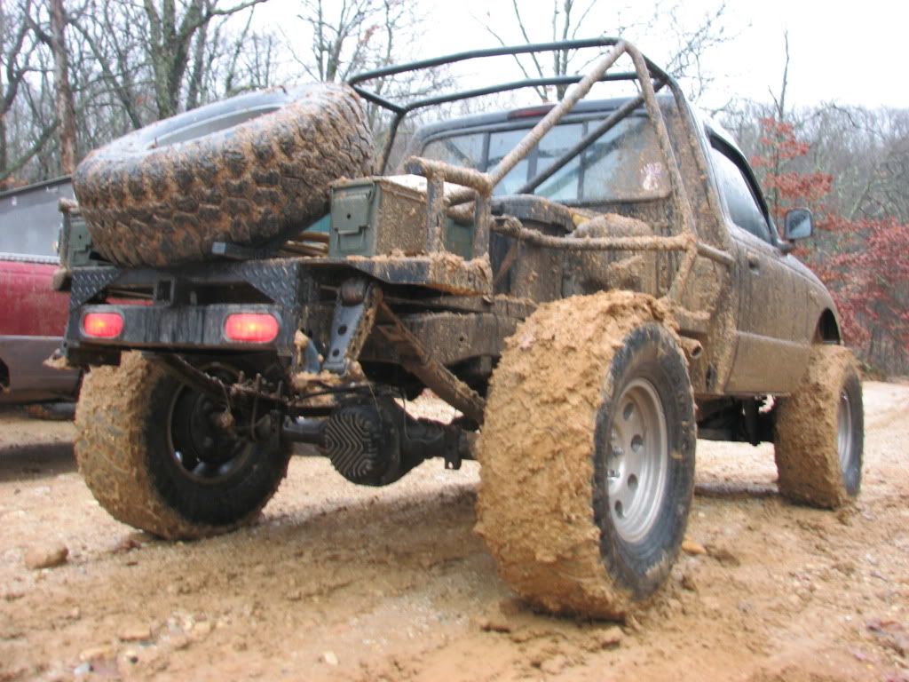

hey buddy, not trying to tell ya how to build your Ranger or anything, but i personally had to cut more out of the engine crossmember. If you look in my build thread, you can see the pics where i still have the factory crossmember, but its just cut way down. I also kept my brake line running in it too, just had to make custom ones. Just my 2 pennies.

it throws quite a bit if you get into some deep mud, but wouldnt be hard to add some fenders.
that was at the end of the day on a pretty muddy trip to turkey bay
I’ve gone through your build thread (and just about every SAS thread I could find as well) prior to pulling this thing in the garage. And you’re right, I will most likely windup hacking off a bigger chunk of the K member, later on. I guess I was just feeling a bit gun shy about hacking more off than I did last night :icon_rofl:. Comments are always welcome, especially from people that have gone down the SAS road before.

it throws quite a bit if you get into some deep mud, but wouldnt be hard to add some fenders…..that was at the end of the day on a pretty muddy trip to turkey bay
Thanks for that photo Slo-vo. While I dig the look of your bed like that, I’m going to try to bob what I have as I need the truck to still be able to carry some stuff. Though with my poor body skills, we’ll see what road I wind up going down in the end. :beer:
