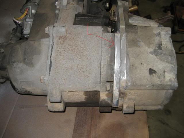

As I was unhooking the drive shafts, I noticed that the t-case to backing plate was loose (not the joint where the two Duffy Plates meet, but where the Duffy Plate meets the Rear T-case) Marked with an L in this photo:

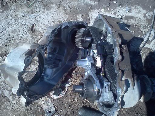

So I dropped the craw box and t-case (on my damn chest), and tore into it finding this:
I’m pretty sure it went down something like this:
-T-case works itself loose over time
-Loose case puts additional pressure onto the crawl box shift fork
-Nylon ‘fingers’ on the shift fork get worn away, which lead to metal on metal contact with the shift fork. In the process killing the fork and allowing it to slip into and out of gear (this explains the slipping I was feeling, and why I would have forward gears sometimes, and reverse sometimes).
So in the end, the t-case coming out of alignment with the crawl box looks to be what killed it. I’m not sure why it loosened up (I might have forgot to put lock tite on it or something).
