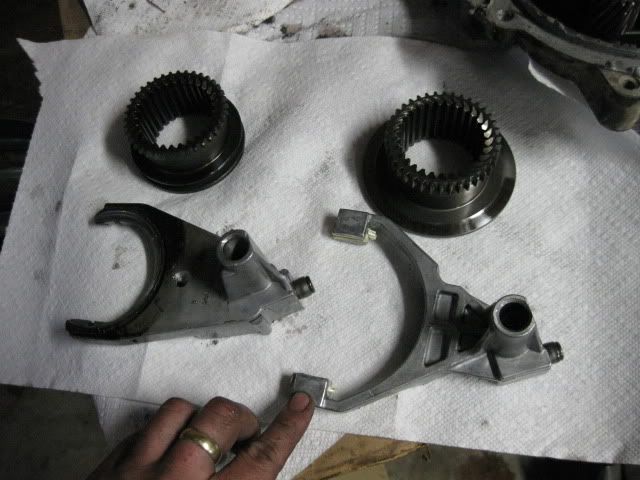

When the rear t-case came out of alignment, it put enough side load on the crawl box shift forks to kill the nylon that was there, and gave it some metal on metal contact. Eventually killing the fork and letting the box come out of gear:

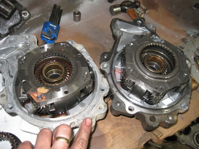

So I looked at some diagrams and it looked like the 1354 electric shift fork might work in its place (the 1350-1354 guts are all interchangeable, so long as you swap everything). With nothing to lose at this point, I tore into the electric 1354 I had to see what’s what. And much to my surprise, the Electric junk will work just fine. So this is an easy to find upgrade for you folks running doublers as the electric 1354’s are everywhere.
1354 Electric case stuff on the Right, destroyed manual 1350 stuff on the left:
The Lone Ranger – Kage’s ’94 X-Cab Leaf SAS and Bed Bob
The big bonus of the upgrade is that you get go to from a 4 planetary gear set to 6. Not that I expected to destroy the 4 gear set, but hey, why not upgrade?:

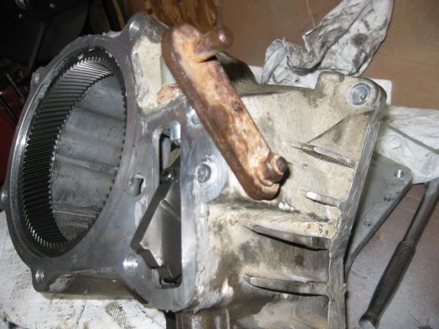

I do need one shift levers badly (and the other shift linkage that goes withi it would be swell too):
If anyone has one laying around, please let me know. Otherwise I'll be shifting the 1354 by hand for a bit until I can find what I need in the bone yard (or make one up)

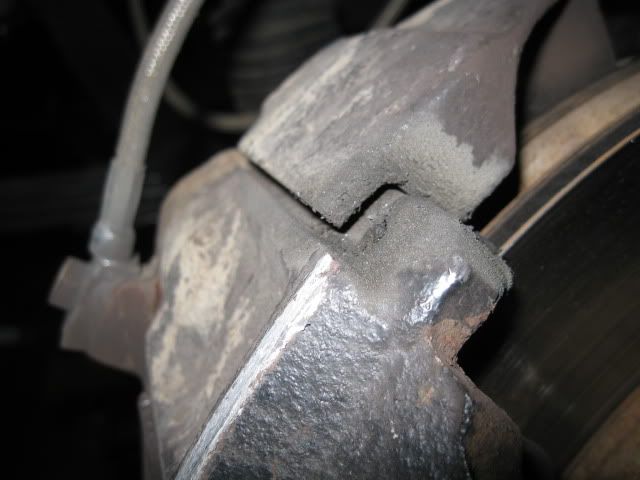

It took awhile, but here’s the photos from my brake issues. It looks like the caliper bracket that mounts behind the spindle is either worn out, or has managed to spread apart over time. This extra distance gave me some slop in the mating parts:

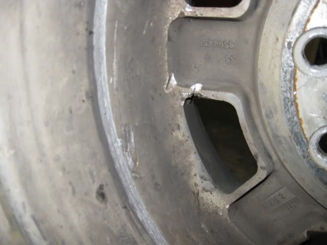

When that would happen, the key would get beat against the outer portion of the rim and get ejected. This would allow the caliper to start to come out of its home:

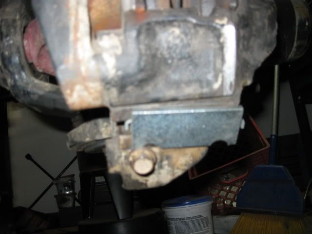

So the solution I came up with in Bozeman MT was to get a piece of steel from the fencing section and jam it in there to take up the slack. It looks hacked, but it worked quite well:

When I got home, I pulled everything apart and confirmed my suspicions that there was something up with the bracket itself. It turns out that the upper tang is a bit more narrow than the other side:
I scrounged around my parts pile and grabbed a combo that seems to fit tighter (Still more loose than I’d like it too) so hopefully that problem has been taken care of. If not, I’ll need to do some junk yard hoping to see if I can find some tighter fitting parts.​

Hey Kage my 78 dana 44 actually has a piece that fits where you put that spacer. I will take a pic of mine. It acts kinda like a spring against the block to make everything tight. If you dont have one on the other side I have no idea how its not goin crazy on the other side. I lost one for my passenger side and drove for a while and it would make a hell of a pop.
Heres the link to the part on advance auto site. Hope it works.
http://shop.advanceautoparts.com/we...ake_5310393-P_1055_R|GRPBRHWAMS_20756140____#
Hey Kage my 78 dana 44 actually has a piece that fits where you put that spacer....
Yup, the link worked. That gap is with the spring in place :icon_surprised: So I'm pretty sure something is just opened up a bit more than it should be (Or wore out). For now, its staying put so I'm ignoring that issue in favor of other pain in the butt projects.
