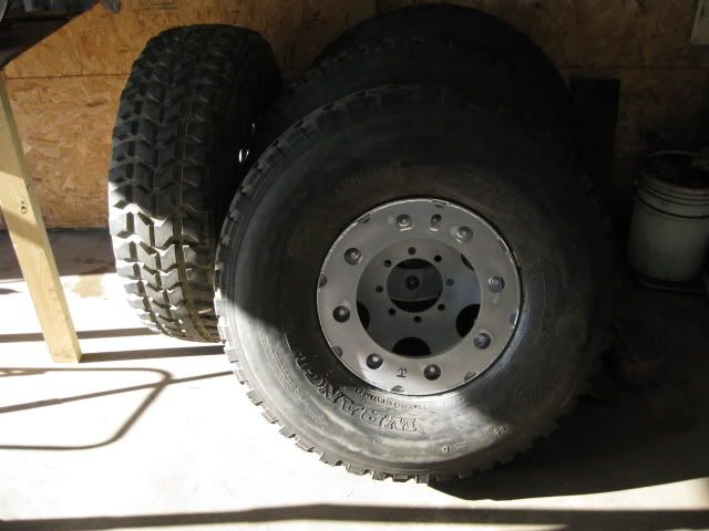

Re-centered H1’s and 37” take offs
I have been running on these used Nitto’s and H2’s for about the past 3k miles or so. While they worked pretty well, two of the Nitto’s were getting a bit thin so I wanted to replace them. I got a bit of sticker shock at how much the dang things were going for (about $400 per tire to my door for the 37x13.5xR17 mud grappler). I’m a little bit too low dollar to be running tires that pricey.
Once I became aware of that price road block, I started searching for an alternative to my tire needs at which point I became aware of Trail Worthy Fab’s re-centered H1’s with 37” take off’s. On the surface, it seemed like a good deal, and the end, I feel that it was worth it. However, my dealings with TWF has left me with a bit of a bad taste in my mouth. Nearly to the point that they were very close to having CC fraud charges filed against them for non-delivery of product. I’ll post a little more about that saga at the end of this post, but for those skimming this post, buyer beware.
Onto the good stuff. I went with the flat centered 8 bolt rims as I felt that the 12 lug wheels weren’t necessary for my ‘lightweight’ rig. I had to go with the flat center as I wanted the most backspacing that I could get (4.5”). I also opted to get the PVC bead locks as well so that I would have a true double bead lock wheel setup.

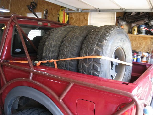

Bringing them Home:
Off the Truck:

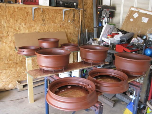

Primed:
Painted (you can see the PVC inserts):
Assembled (torque the lugs in steps, 65 ftlbs, then 75 ft lbs finial, there should be a maximum spacing of .0015” between the wheel half’s at this point):

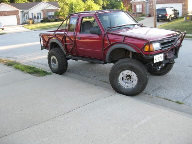

And then on the truck:
It definitely changed the look of the truck going to these wheels. I’m not sure I dig the color, but I doubt that I’ll have time to change it any time soon. So far I’m very happy with the on road ride (very low noise compared to the Nittos, and balanced pretty good though I need to add a few more bb’s). I’m also digging the fact that these are steel, so no more worrying about killing one of those H2’s on a rock.
It might also be my imagination, but they seem to roll easier as well, even though they’re heavier than the other wheel and tire combo (currently about 150 lbs a wheel).
