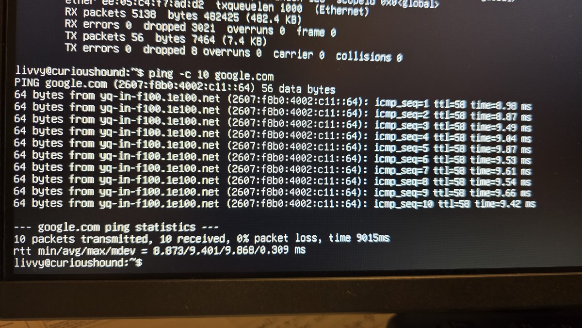

I don't want to encourage you to work on it if you need a break (I know how that goes) but if you get a chance could you post a pic of the output of "ping google.com" ?

Yep, as I suspected, your system is either defaulting to IPv6 or doesn't even have IPv4 support enabled.
By any chance did the setup routine offer you a choice where you may have disabled ipv4? I'm out of the house on my phone right now but it's easy enough to switch to ipv4 if for some reason it's not enabled
sudo sysctl -w net.ipv6.conf.all.disable_ipv6=1
sudo sysctl -w net.ipv6.conf.default.disable_ipv6=1
sudo sysctl -w net.ipv6.conf.lo.disable_ipv6=1
Those 3 commands should temporarily disable ipv6 for testing your ipv4 config
