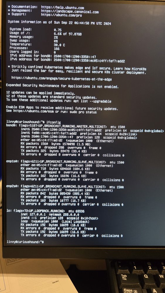

I got ubuntu server set up on the "permanent" computer. I have the external ssd mounted and the system sees it. I installed Apache and got to the verification step where it says to type in my ip address and I should see the temporary welcome web page in Apache.
Trying to figure out exactly what my ip address is. Where do I type it in? Haven't gotten anything to work yet. I went into my router settings (AT&T fiber) and I see all kinds of info about devices on my home network. I see the ubuntu server machine. But ip addresses are eluding me IPv4, IPV6, etc. Wondering if there are router settings I need to set or verify. But I don't know what everything means. So, we'll come back to this in a few weeks and I'll ask some specific questions.

So, here is the output of ifconfig. I might need to back off and configure just one port right now. I have 2 ports on the computer and they are aggregated to be one. "Bond0" should be my aggregated connection. Eno1s0 and enp2s0 represent the 2 physical ports being used.
What gets me is that nothing but the loop back shows a normally formatted ip address. I have even designated static ip addresses to the 2 ports (192.168.1.64 & 192.168.1.66). But typing them into a browser does nothing.

Yeah at first glance it looks like you're only being assigned an IPv6 address by your router.
Just curious, why did you decide to use a bonded connection with multiple ports?
Edit: did you set up your network configuration manually or is it set up to get its config automatically with DHCP?
Edit2: it looks to me that all the MAC addresses for all your interface are the same so I'm curious how you went about setting up the link aggregation.
Edit 3: I don't want to push unsolicited advice on you but as far as simplifying getting things up and running, it would be easier to set everything up and get a grip on what's going on without bonding/link aggregation unless you really need it.
Bonded connection sounded like a good idea for faster communications, since the whole idea is large file sharing.
Originally dhcp. As a troubleshooting step, I assigned static addresses for those 2 ports.
MAC addresses aren't even displayed in the ifconfig output. They should be
84.47.09.32.ce.a8
84.47.09.32.ce.aa
Agreed on going back to single connection.

I take it your little box has 2 ethenet ports? Nice feature. Are they gigabit? Or something else?
Thing is, if they're gigabit, unless you have better then gigabit upstream on your home fiber connection, you won't really gain anything. I would argue that even if you did have multi gigabit upstream at home (lucky you 😀), serving your files through a gigabit connection would still be plenty fast for most situations. Not trying to twist your arm, just brainstorming.
Edit: in your screenshot, your mac addresses are shown next to where it says "ether"
There are a couple reasons they may not reflect your actual hardware
I may work on this more later this evening. I set up the bonded connection during Ubuntu installation. Now I need to remember where or how to disable it. Weird thing is, I'm communicating. I can ping google.com and it works perfectly.
