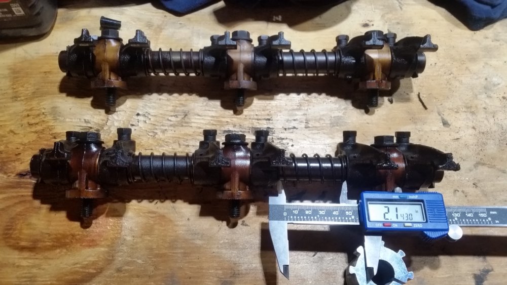

Here are some measurements from a pair of '89's. One thing I've wanted to know since reading about these spacers, is what do you do about the gap between the spring clips and the outside rockers? Leaving the spring clips in would defeat the purpose of the project in regards to the outside rockers.
Based on the wear marks where the rockers meet the valve stems, Ford didn't think it was too important to precisely position the rockers. But like Uncle Gump said, shims appear to be a necessity due to the varying dimensions. I haven't looked into this in too much detail, but I assume that the pedestals are pressed on, which is going to have a lot to do with the gaps on either side.

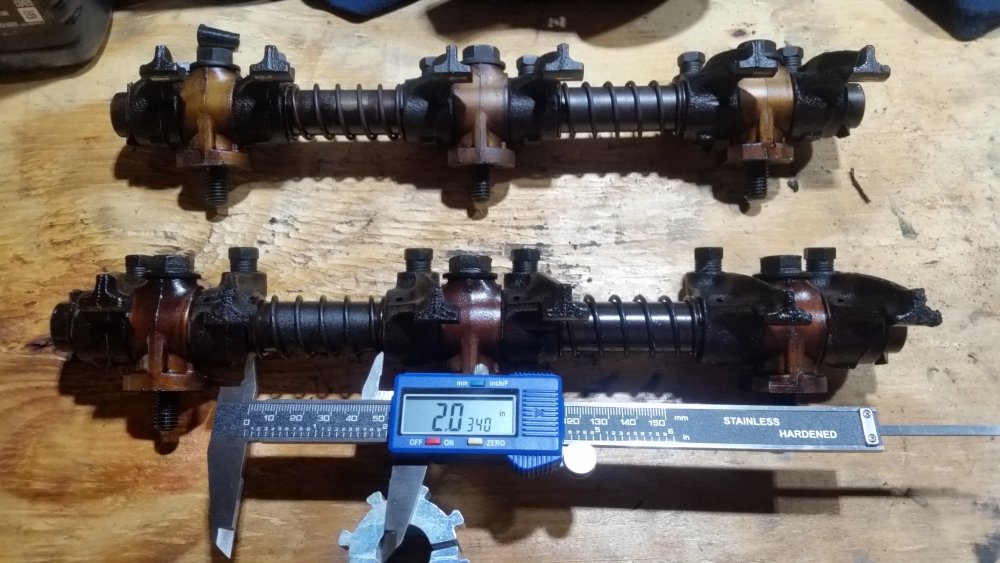

My old 86 TM heads, rocker shafts installed -
2.055
2.150
2.190
2.031
Shaft diameter at all four spring points roughly 0.880"

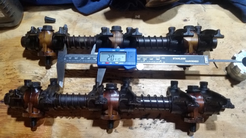

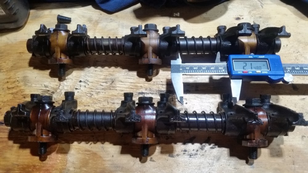

Paulos' 86TM Rocker assemblies, not on heads -
2.041
2.148
2.034
2.143

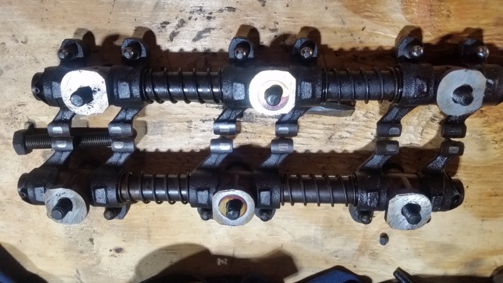

So the pedestals are free floating on the rocker shafts, believe it or not. They feel pressed on due to the spring pressures and galling issue.
Not sure about the spring clips or outside rockers. I can see the utility of aluminum bushing there, though.
My fear with the spacers and shims would be wear. I need to look into how the V-dub guys do this.
