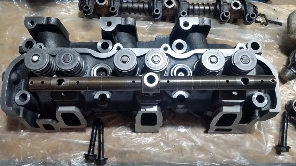

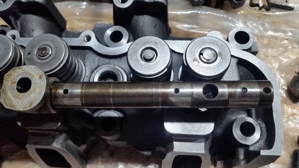

I haven't had much time to check measurements this weekend. But I did dismantle an old rocker arm, and discovered why this particular engine was apparently noisy.
The four lower oil galleries in the rocker arm shaft that supply oil to the lower side of the rockers (where the tension is) were plugged up, like the second hole on the right of the shaft. I had to stick a piece of wire through each one to break up the deposits. The deposits were thick enough that I don't think any type of oil treatment would have dissolved it. It's probably a good idea to change the oil once in a while to avoid this :unsure:. An occasional can of Sea Foam or equivalent wouldn't hurt.
The top side of the rocker shaft is not worn at all, so I suppose it may be possible to flip the shaft 180°. The pedestals are not pressed on, but they were pretty snug on the shaft.
I did bolt the rocker to the head first though, and with the rocker assembly slightly loose there was side-to-side movement between approximately 0.005"and 0.010". So, it appears that it would be a good idea to re-assemble the rocker assembly without the springs (roll pins installed without clips), center and tighten each pedestal, and then measure for the spacers. Using old pedestals and rocker arms is where the shim kit will come in handy due to different wear on different engines. I'll get some measurements without the springs and clips in the next day or so.
