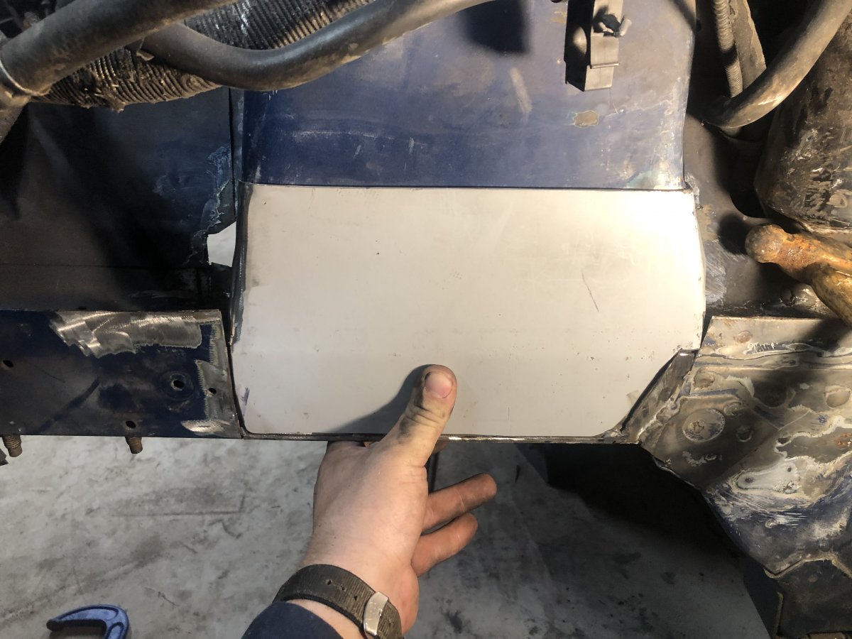

This piece required way more geometry then I was prepared for. Giant PITA, and wasted more metal then I wanted to. I wanted it to wrap around into the fender well as one piece, but buggered up that too many times and decided to make that part separately.
I wish I had your skills and your patience
