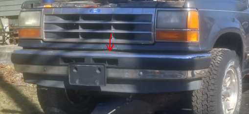

Oh my its inescapable. Got a picture from a friend who recently got a Bronco...
58464
This photo actually gives insight on how the bumps are created and how to remove them. Seems if you pull the grille, you can massage the dent down with a mallet while pulling the corner of the bumper in the forward direction supporting Rick's theory.
