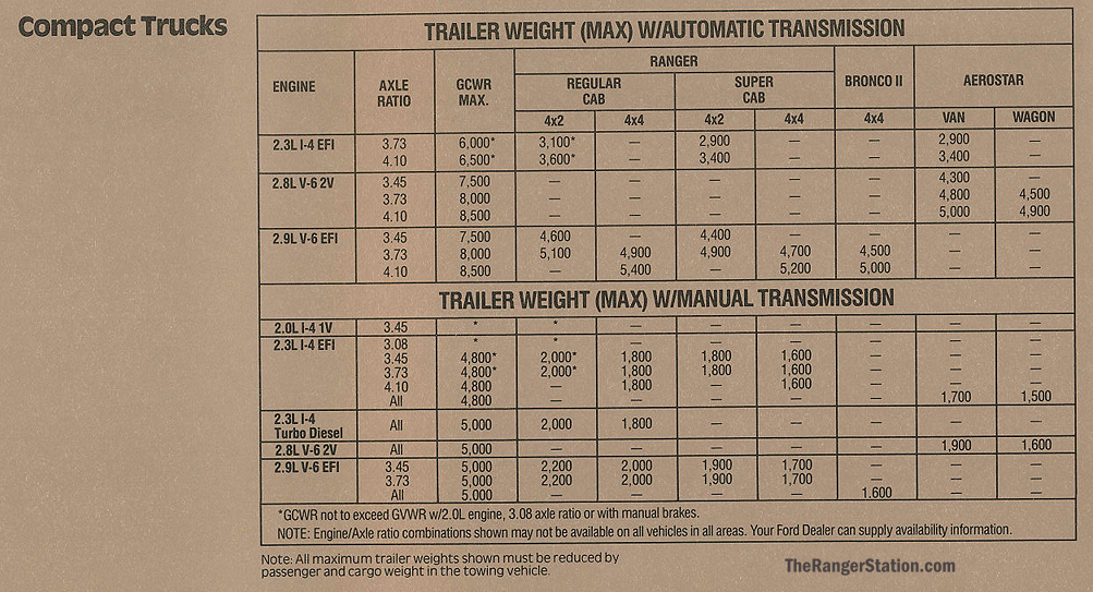

Your owner's manual limits the '85 Ranger to 2,200lbs trailer towing for the 2.8/manual/4x2.. (It's really 5,000lbs GCWR, as the 4x4 tows 200lbs less) See the attached Towing guide - its a copy of a copy but the best I have.
Note: The 2,200lbs is based on the truck having 3 - 150lb occupants* in the cab and full tank of gas, no junk stuff behind the seat/in the box, etc. The 3 occupants is derived from the number of seatbelts, 150lbs was (still is for J2807 trailer standard) the average weight for an individual. So, in theory you could tow a little more than the manual, legally. Just no sandwich maker in passenger's seat(s), etc...​
Arizona trailer law requires truck with trailer having less than 3k lbs. GVW to be able to stop within 40'; a number of other states (Pennsylvania, Washington) add a caveat; the trailer needs brakes if >40% of the GVW of the towing vehicle ('85 Rangers start at 3,800lbs GVW = 1,750 lb. GVW trailer). The fine print: The trailer weight is the GVW of the trailer, not the actual weight of the trailer. (There is an assumption that you might fill up to limit but not overload the trailer.)

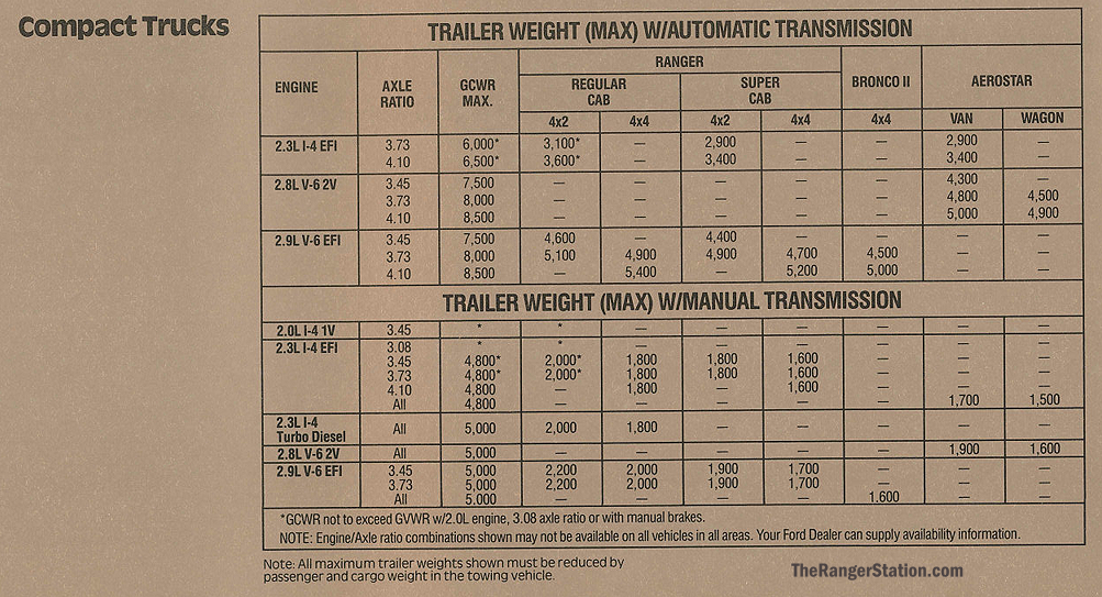

Here's Ford's 1986 Towing Guide. It includes the Ranger and the different specs for the 2.0, 2.3, 2.8, and 2.9 (page 14).
Can I tow with 1st gen ranger?
wow, the difference between stick and auto
It's always been like that. The difference is still there in my 2011 manual.
