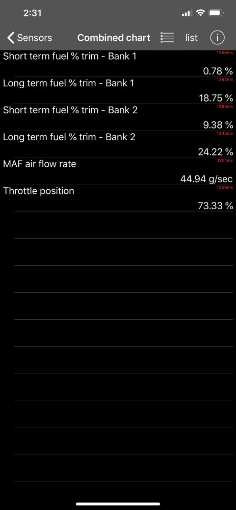

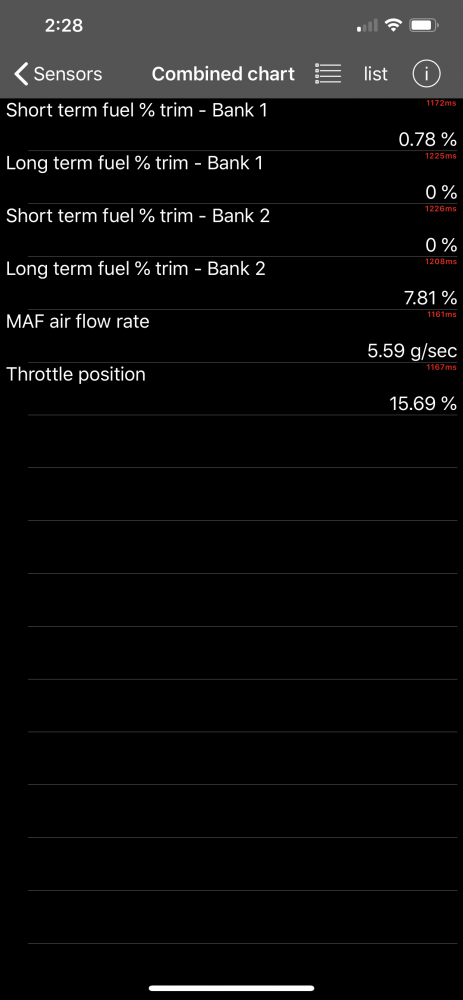

I’ve got some images of live data and I’m hoping someone can help me decipher these and see if I can track my gremlin down.
I’m leaning towards a vac leak but I can’t seem to track it down.
Thanks in advance yall!
FYI... first image is at idle.
Second is 4th gear, low speed high throttle input

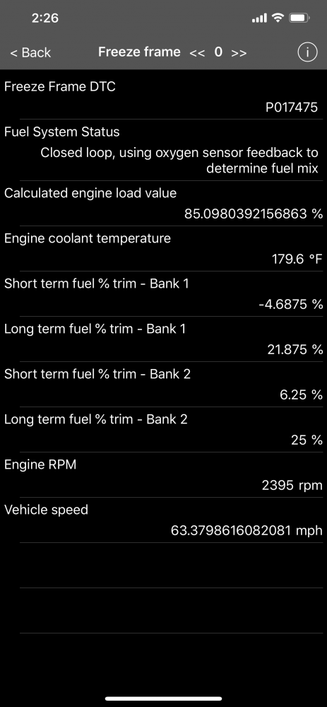

Final image is freeze frame from pending p0174 code

Your fuel trims show normal at idle and high under load, this is pretty much the opposite of how a vacuum leak should show up. At idle the manifold is under high vacuum so the leak is very strong, when you increase the load on the engine manifold vacuum drops and so does the negative effects of the leak. I'm just guessing but it seems more like a fuel delivery issue to me. Being on both banks I'd throw a fuel filter at it to start since it's a cheap 5 minute job...
Your fuel trims show normal at idle and high under load, this is pretty much the opposite of how a vacuum leak would should show up. At idle the manifold is under high vacuum so the leak is very strong, when you increase the load on the engine manifold vacuum drops and so does the negative effects of the leak. I'm just guessing but it seems more like a fuel delivery issue to me. Being on both banks I'd throw a fuel filter at it to start since it's a cheap 5 minute job...
Is +7 at idle normal?
I thought it should be >+5?
+7% is perfectly fine. As engines get older the numbers change. That's the whole point of the fuel trims, to be able to compensate for wear. The issue here is the amount the fuel trims change from idle to load. For example my truck runs around +10 to +12% but it does this through all throttle ranges and engine loads which is perfectly fine. Don't focus on the numbers themselves, focus on what they do.
Generally speaking when you have very high long term numbers at idle and they drop under load it points to a vacuum leak. When you have lower long term numbers at idle but very high numbers under load it points to a fuel issue. Very general rule of thumb though.
