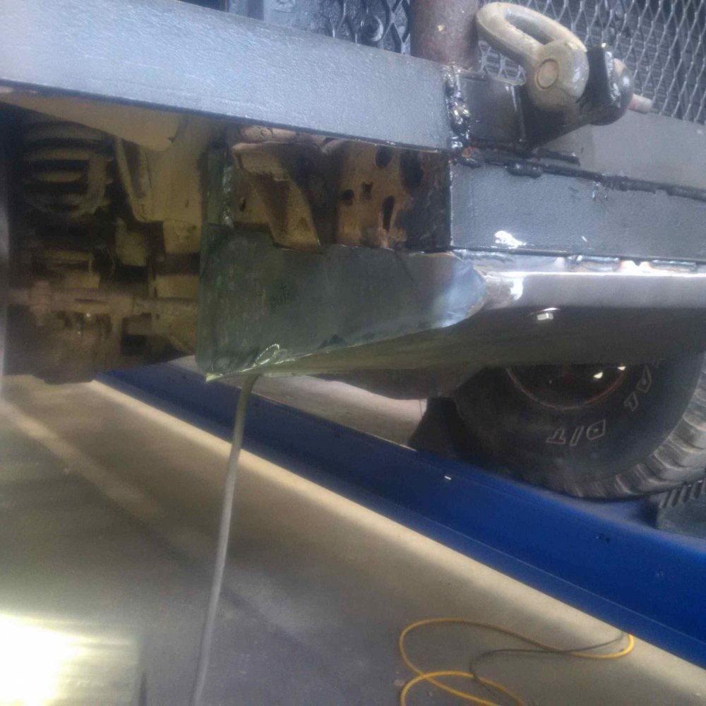

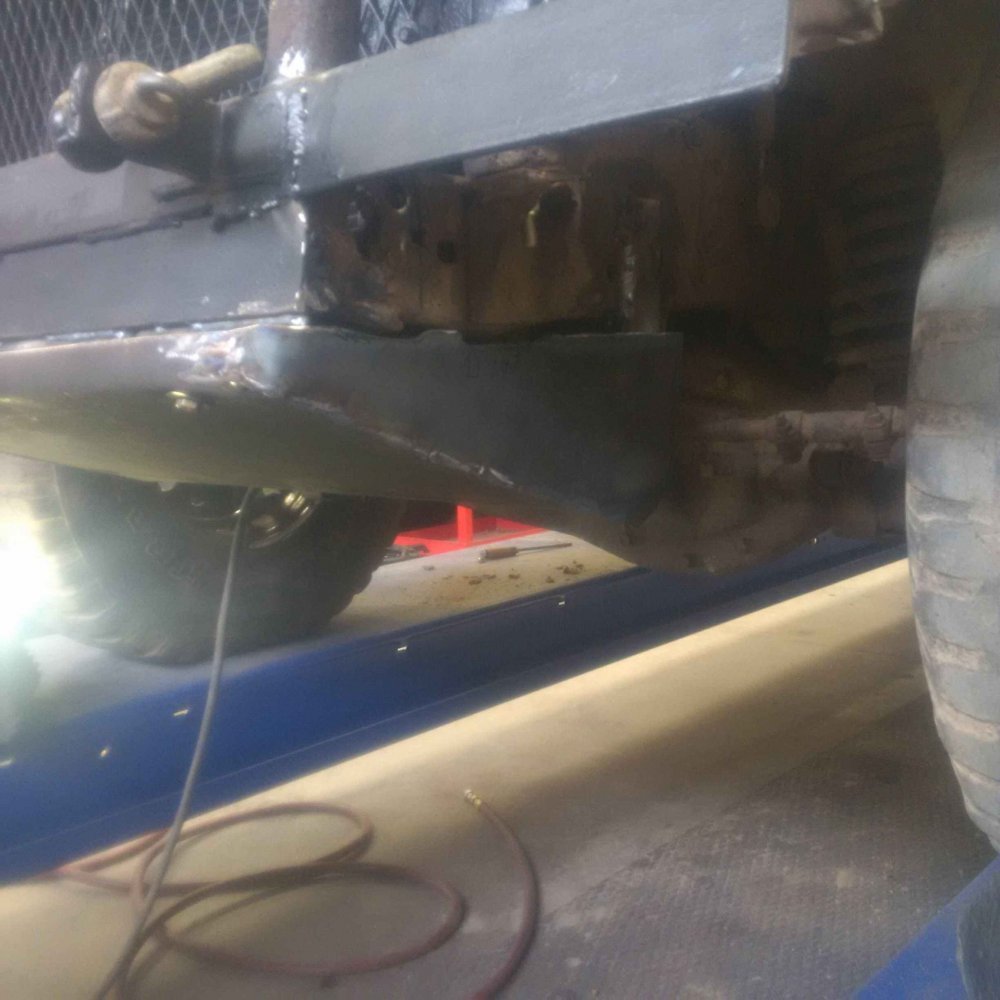

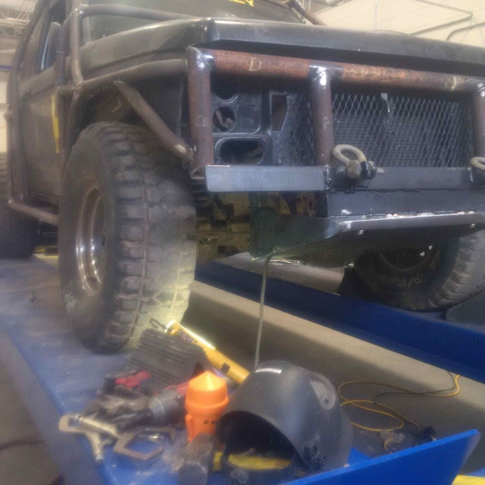

I'm laying in bed and I'm thinking.....I don't like that front skid plate...it looks unfinished....maybe tomorrow I'll add wings or something to fill it in or "finish it off"
So;
39018
39019
39020

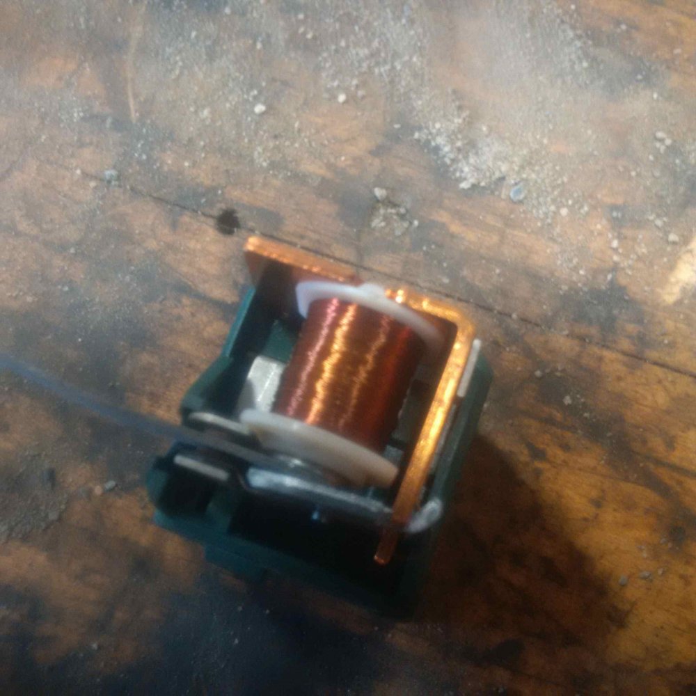

Then I decided to start the light bar. I need a relay..I wonder how bad that fuel pump relay is, why buy new when you can fix old right??
I pulled the top off the relay and the points were burnt like I thought. So I grabbed a points file (it's for filing the points in an older vehicle for you young 'uns lol)
Anyway, filed the points and tested it and voila! it worked. 12v in and out on the large leads (the small leads run the coil) wired a light to it and it flows amperage as well, all good!
39021

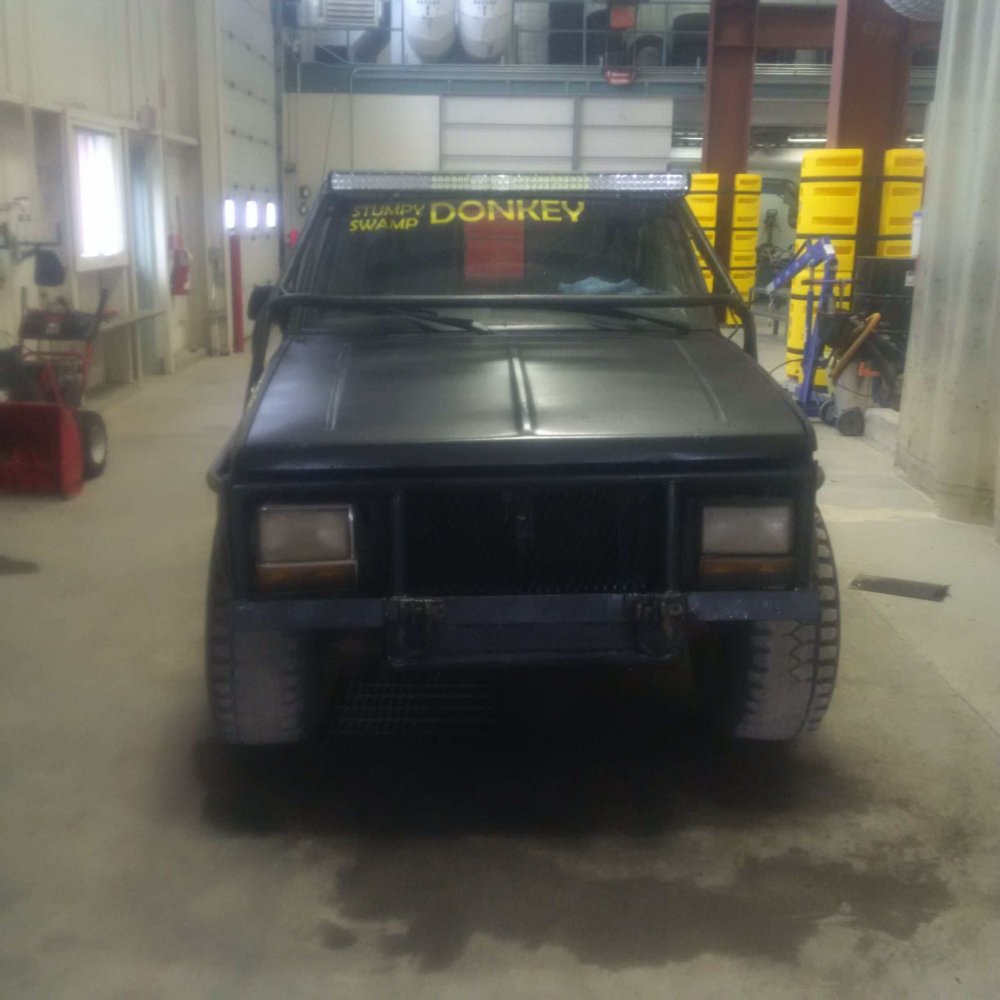

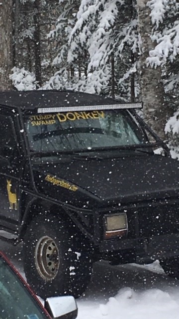

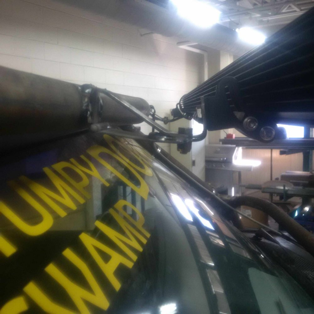

Next was the light bar, I was concerned that with my height restriction (to get into the back of the toy hauler) I couldn't go above the roof. So I decided to grab a couple of old hasps I had laying around and make a "drop down" type of mount. Then I could drop it down for transporting and then raise it up and bolt it solid to wheel. Take the bolt out and the bottom part hinges down (with the light) and the top part is welded solid to the cage.
39022

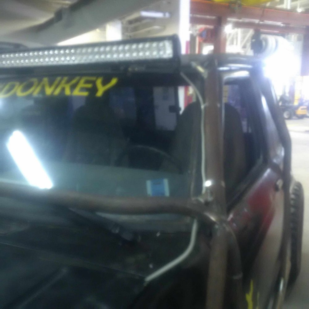

I was concerned with the wires getting caught and ripped off as I drive a lot in the woods with very tight clearances. So, I used brake tubing to make an armoured wire protector. Now the wires can't get ripped off!
39023
Wow, that was a crappy picture...anyway, you can see the tubing hose clamped to the cage and entering between the hood and the firewall. (I thought I would have to cut/fit it but the truck was tweaked quite well in the accident and the tubing slide right in. LOL!!)

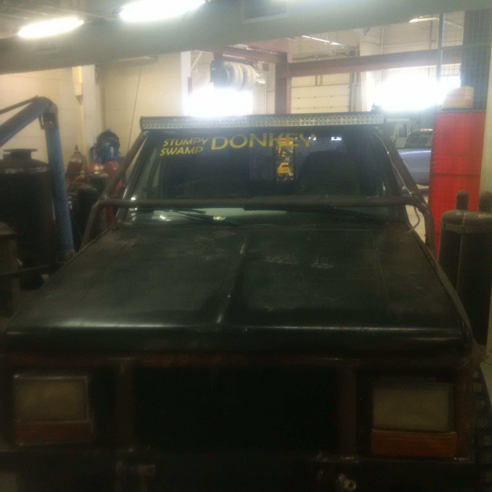

And here's a picture from the front. I tried with the light on, holy crap is it bright!
39025
Oh yeah, I did some hacking and slashing and got the headlights bolted in and hooked up too. Now I have high/low beam plus blinker/4 ways for driving on the side of the road. I have to put tail lights on next as well as a box/flatbed/something. For now though, I gotta get it out of here as my kid is coming home from his helicopter course in another province which means I won't be allowed at work. (must self isolate at home)

Air holes in the skid plate for cooling? Otherwise, I think the skid plate looks good. You can't make it go back any more with the axle design.
Actually, the rad (out of an explorer) only sticks down an inch or so cooling won't be affected. I was more concerned with clipping the bottom rad support on something more than cooling. Thanks for the feedback though.

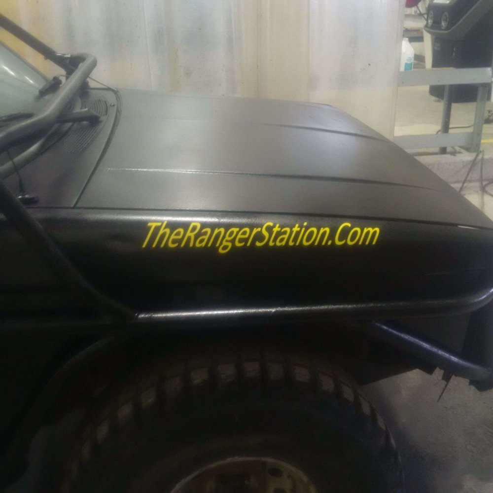

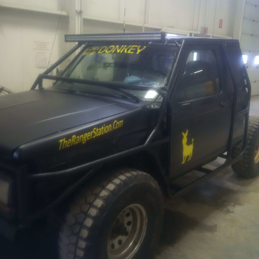

Anyway, I painted the truck and used a clip board to keep the overspray off the windows (and you think YOU'RE redneck??) and this is how it turned out;
39056
and of course, since I got help in here I had to give credit where credit is due...
39057
and a side pic
39058

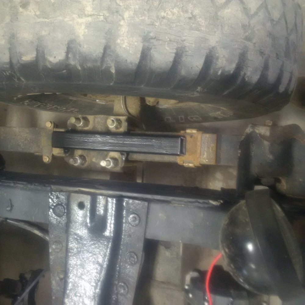

Oh yeah, I forgot, I was moving it around in the shop and noticed a bit of axle wrap when I popped the clutch. So, after seeing how bad it appeared to be, I decided to make a set of simple "slapper bars". On cars they go underneath and come up and stop the axle from twisting the spring/axle wrap/wheel hop. On a 4x4 you want clearance so I went on top and to the rear. I gave about an inch or so clearance so the suspension would still function normally. A couple of rev's/popped clutches and yup, it works! Oh, it's just 2" square stock with a hole drilled in it for center bolt clearance and welded to the top of the saddle. Nuts are still accessible.
39059
Not sure why the picture came out sideways, but anyway. Oh, and the plate with the two bolts in it at the front are not connected, just an optical allusion.

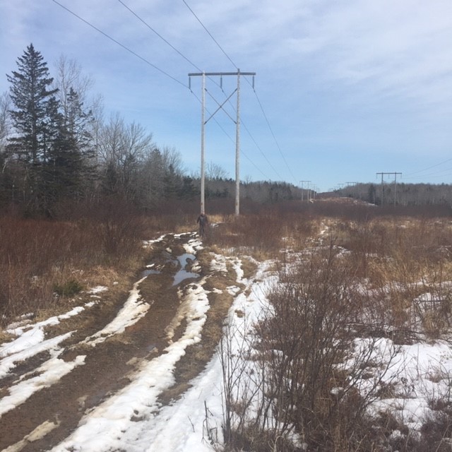

Cleaned the interior out and took mama for a cruise up the power line. 1st gear low, crawling along as it was a "test drive".

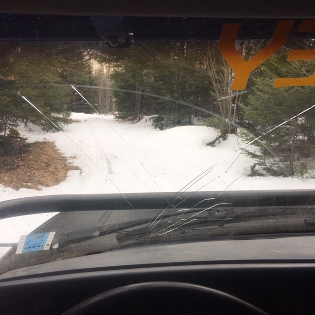

Following a snowmobile trail, the donkey loves the snow!! (windshield got busted in the previous "mishap"...)
