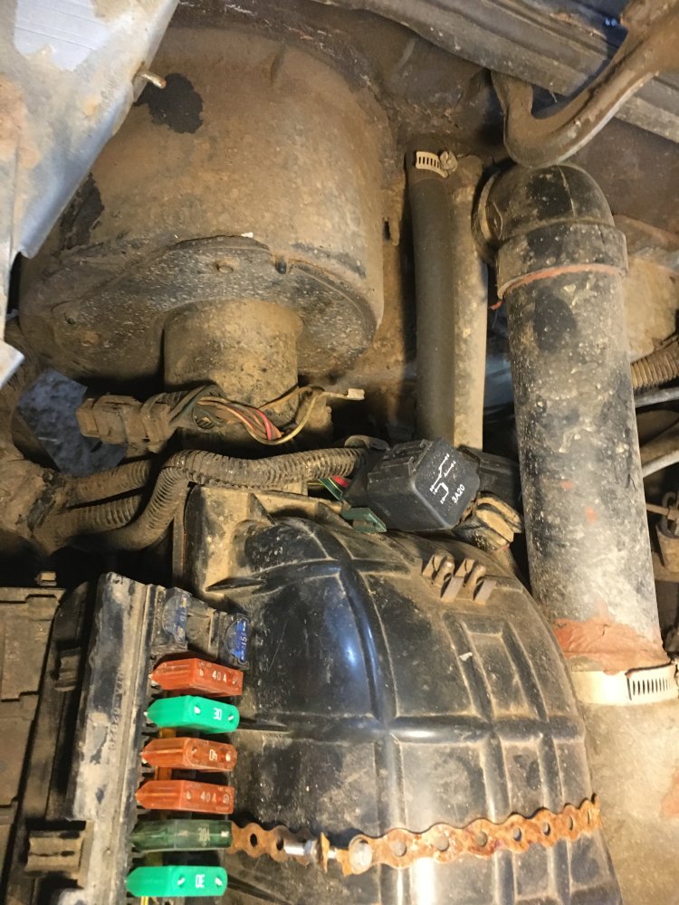

Anyway, started looking over the wiring and what the issue could be;

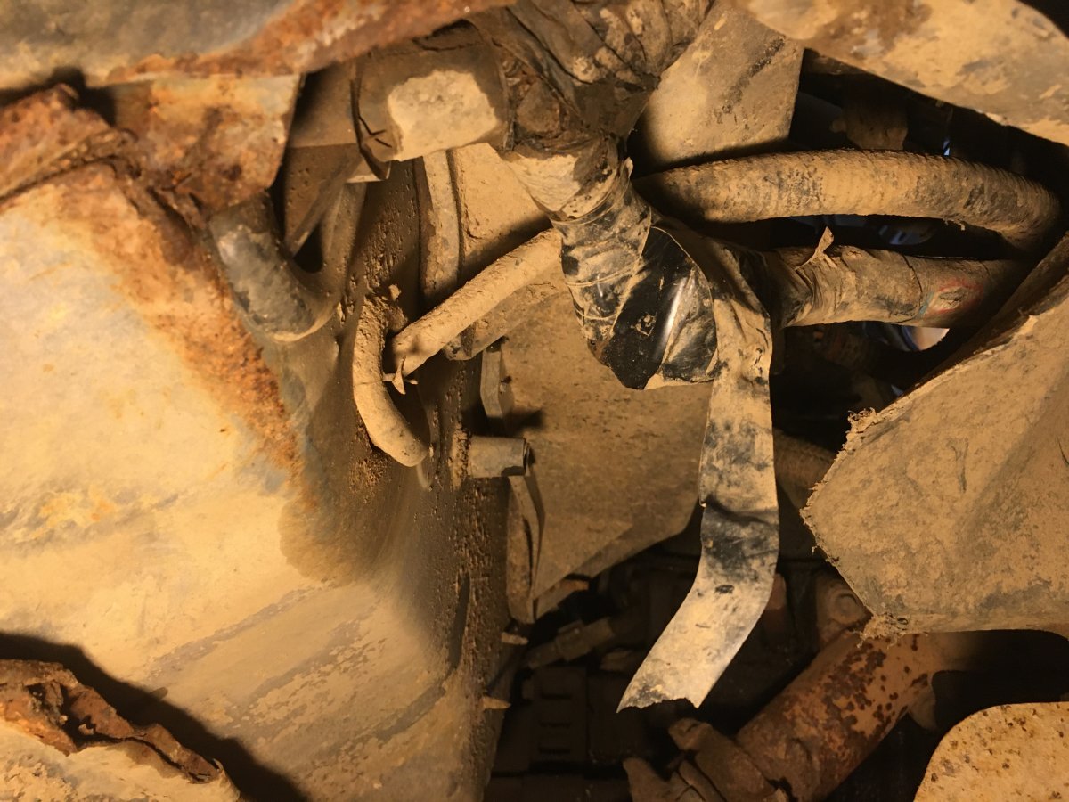

The fuse box wiring is pretty bad and I found where the inner fender is pounded up to give the 35’s room, it is pinching the main cable running from the fuse panel to the computer.

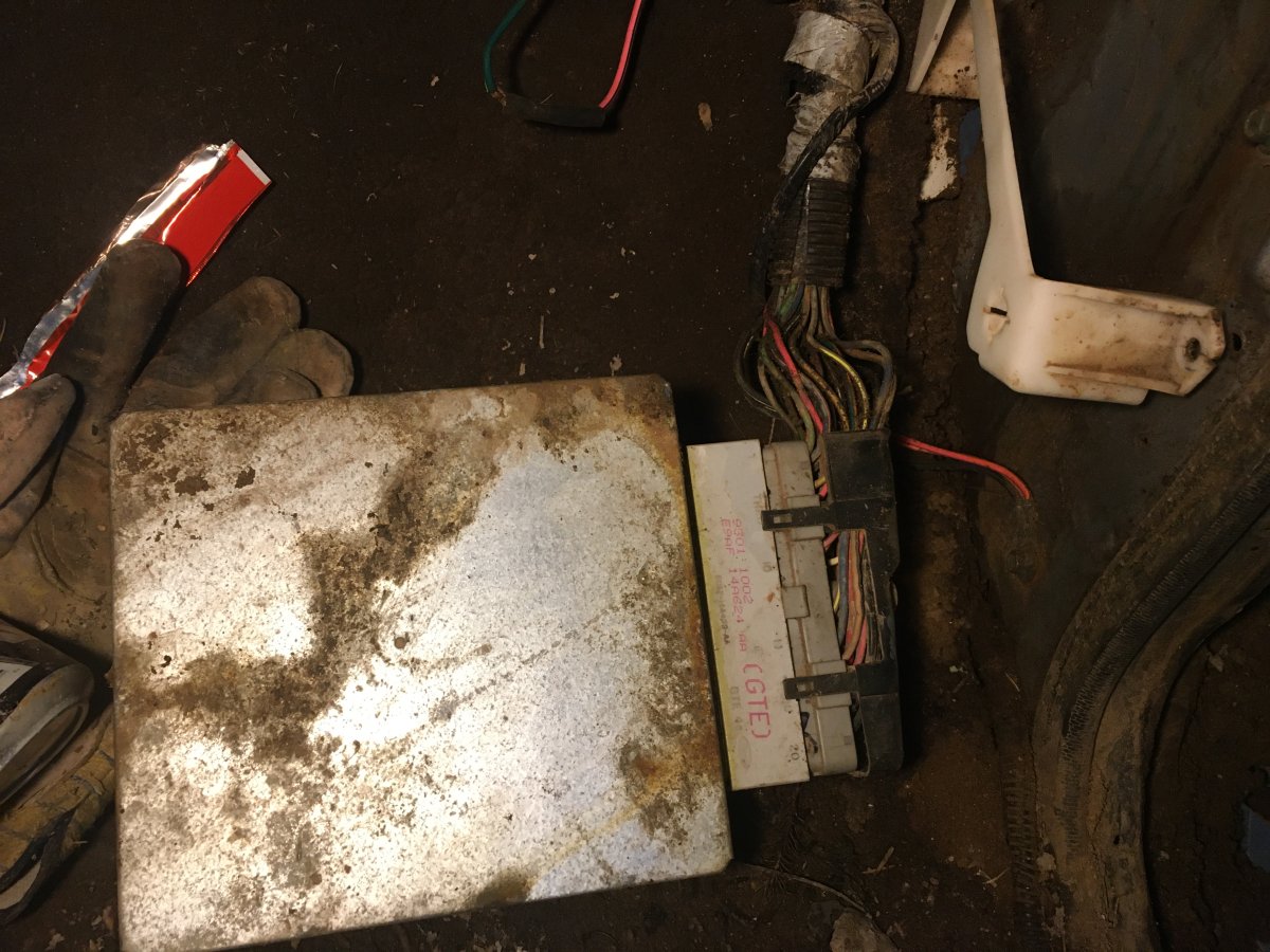

Inside, I pulled the computer and the wires and everything was packed in mud and rocks. I can’t remember how many times I’ve driven it in water up to my ass on the seat. Which means the computer and all the wiring was under a foot or more of water!

That picture doesn’t do it justice😂😂😂
Under the white computer hold down strap (top right of picture) it looks like something white on the floor?? It’s actually a hole into the fender well. All the mud it packed through the hole and filled the wiring harness😳
