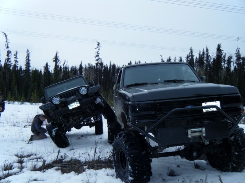

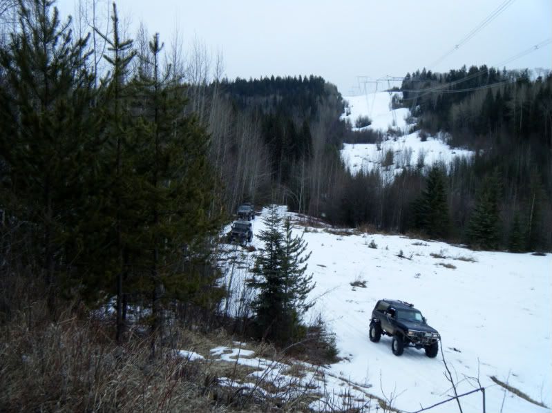

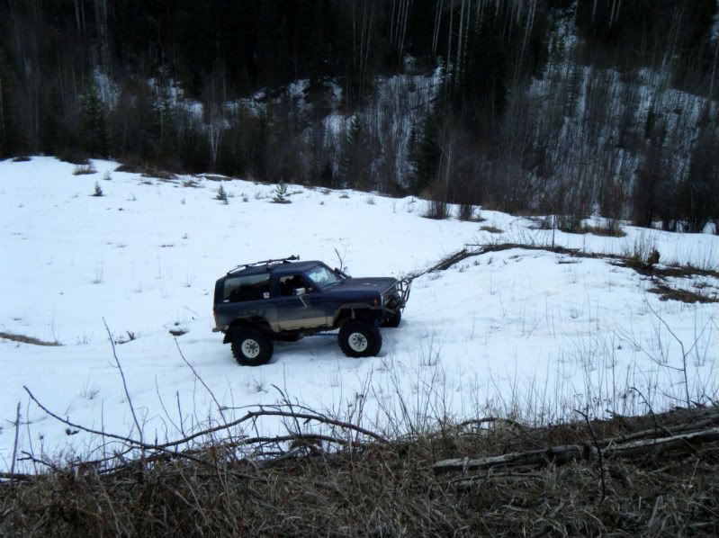

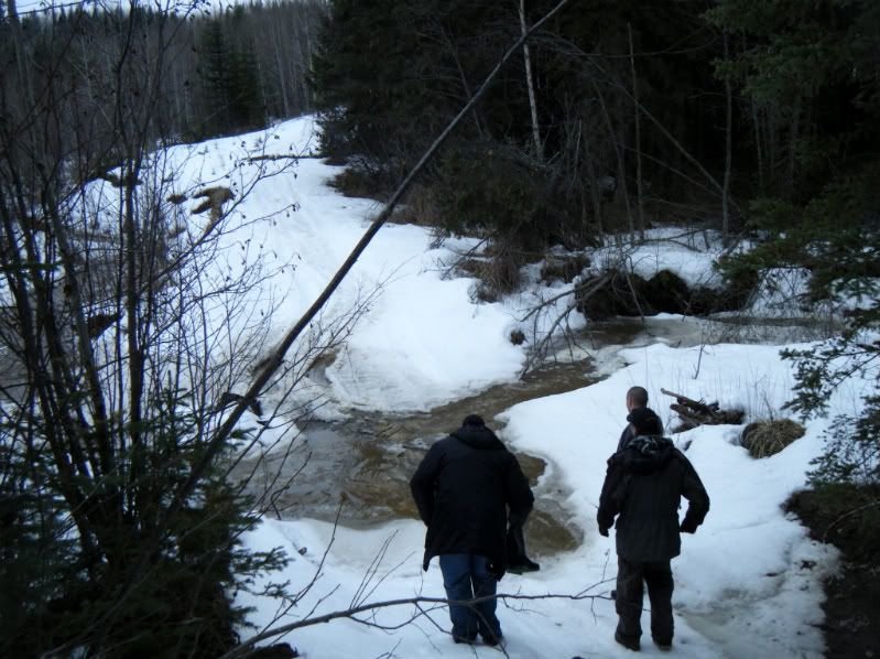

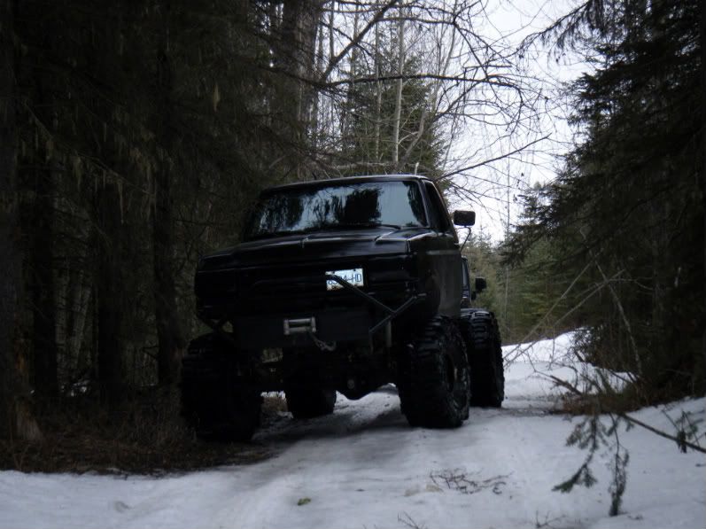

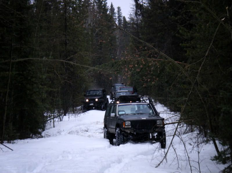

Had a blast out wheeling on Sunday.
I know that truck! The used-to-be F-250. Snowracer over on BC4x4, I love that truck so much!
