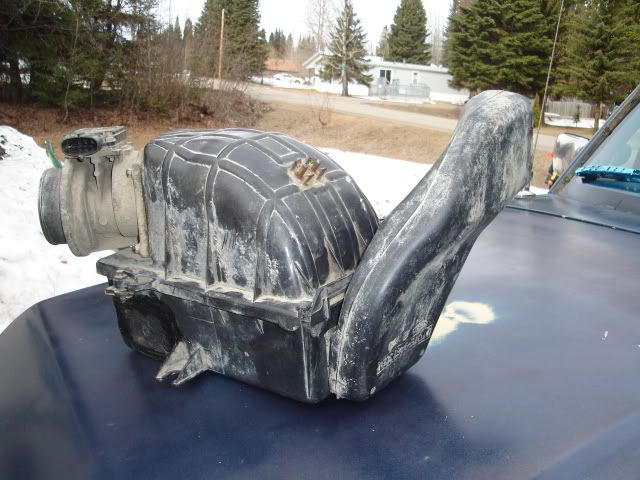

I pulled the stock 4.0L air box out to mod it for a snorkel. Figured it would be more useful for the air intake hole to come from the back side of the box. Since I have a v8 swap planned in the future and the 5.0L I have has the air intake hoses of the engine routed to the drivers side, I relocated to air box over to the drivers side.

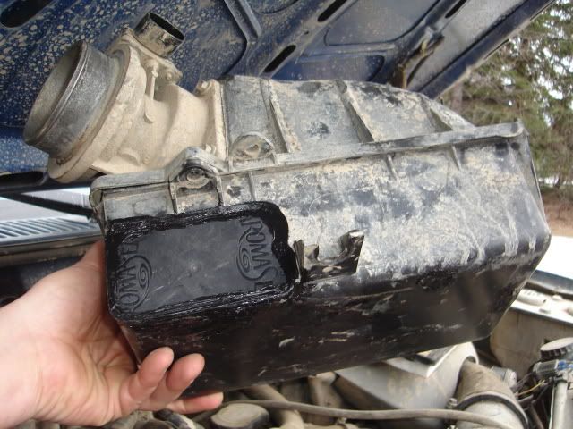

Sealed up the original air intake hole with a chunk of plastic bonded to the box after sanding the surface down for the adhesive to attach to.

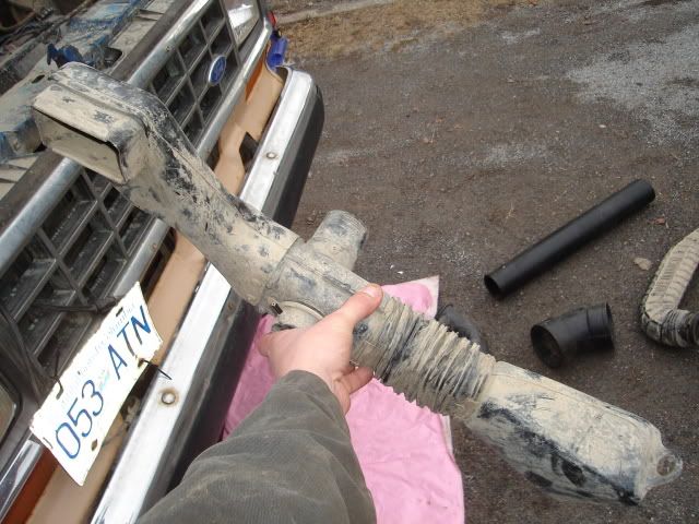

I intended to use parts of the stock grill mounted intake hose to attach the tubing for the snorkel so I dissected it into it's 3 riveted pieces.

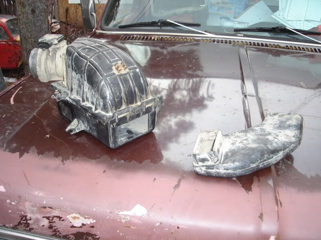

After measuring for clearances I traced out the outline of the elbow I intended to use to exit the air box and then cut the new air intake hole in the box.
thoroughly coated the elbow and air box hole in silicone and stuck them together, the elbow snaps into the new hole I cut in the box so the silicone is only there to help seal out contaminants.

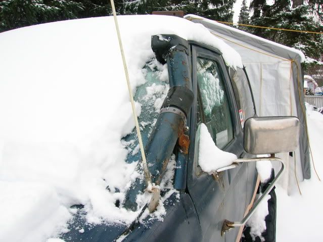

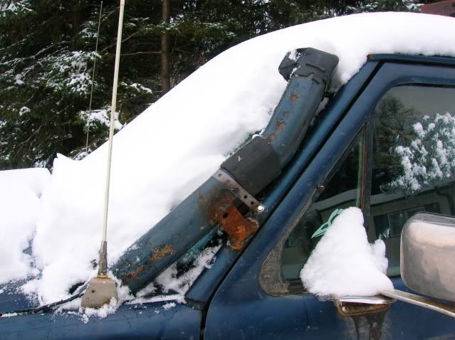

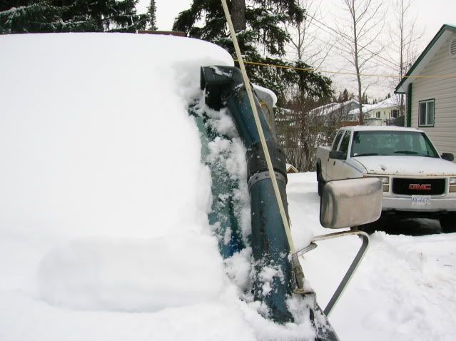

I use a 3" hole saw bit on a drill to cut a hole through the top of the cowell, and the removed the small rectangular plate that holds the clutch reservoir to the fire wall and relocated it over to the inner fender support. Then I had an old 3" tube truck sport bar (thin fake roll bar from the 80's show trucks era) kicking around in my scrap pile, and with the old 2.9L rubber intake hose I mated the air box elbow to the 3" tube, all the bends in the tube were also done with the stock 2.9L rubber intake hose. Then I welded a tab to the snorkel A pillar upright piece and the A pillar to hold it in place.

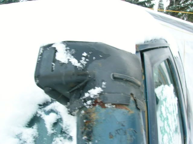

The topper on the snorkel is from the stock 2.9L air box, it was the elbow that come out of the air box and the ran to the grill for the air intake for the box. Just looked neat so I used it to redirect the air flow away from splashes directly into the air stream.

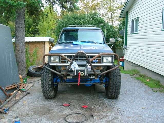

Purchased a set of 28" long braided stainless flex lines for the brakes, lengthened the front shaft I had used with the d35 ttb as it had the correct U-joint for the d44 and then with a cross over U-joint I used a stock Explorer CV front drive shaft for my rear drive shaft, I also swapped out the stock 1350 rear flange for a front flange from the 1354e.

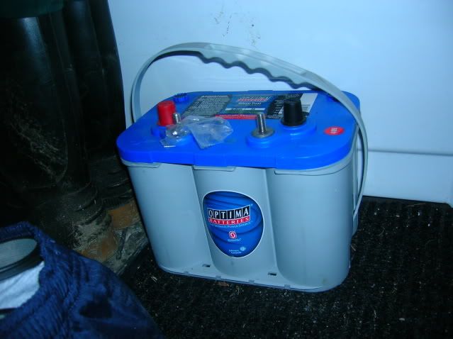

Picked up a new Battery as well.
With that I was ready for some testing around the yard.

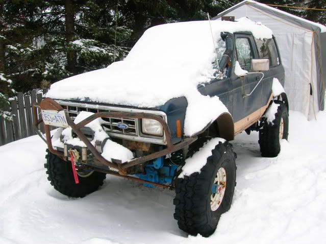

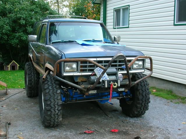

I figure it has about 6" front lift and about 8" rear lift from stock, it has a 3" BL, rear Explorer springs which gave me just about 2" and 3" blocks out back and it's about 2-3" lower up front as of the time this pic was taken. With the stock 215's being about 27.5" tall and the 35's being 34.5" tall that gave it about 3.5-4" tire height gain. So over all she should be 12" higher than the stock Bronco II to the bottom of the door sills, tires, suspension and body lift height added up. Not bad I guess to gain about a foot of elevation after all this. And I said I wanted to keep it as low as possible, lol. I guess I sorta did.

Walked around it taking pics.

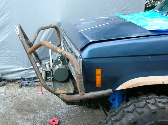

Started working on building the stinger and sliders.

More recently I have been SnowX4ing prolly twice a month since we got snow in November. Sometime in the middle of December I installed a set of 2" TeraFlex coil spacers up front, now she sits closer to level, but still an inch or so low up front for some reason. Should be good for adding some more tube up front and the swing away tire carrier and 38" spare out back.
There you have it the evolution of a wheeler. So far she has done pretty well, broke stuff here and there but nothing major. I ripped off the passenger side shock hoop off when landing after jumping it a few feet in the air a few weekends ago and then ripped off the drivers side shook hoop after another jump last weekend. Figure I better get started on triangulating the shock hoops and build an engine cage to tie them into for added support.
