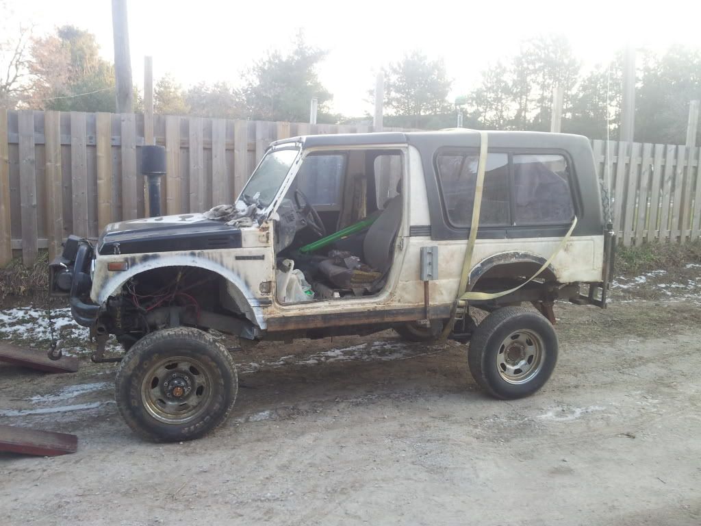

how did you make the coil mounts on the axle?
I used the stock lower coil plate and spring retainer from the 77 d44. the ones that originally bolted to the top of the radius arm. Instead of attaching to the arm I welded them to a piece of 2x2 and then welded that to the axle tube inboard of the radius arm. My theory was that having the springs closer to the center of the vehicle I could possibly achieve more suspension travel than if I spaced out the upper spring mounts like everyone else was doing. Using a shorter spring to get more flex was the idea. LOL It was a theory anyways, she can twist up pretty good.

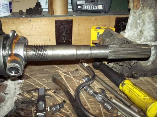

I'm undecided on whether the shaft is able to be splined, hard to measure it with the speedo threads. It might be thick enough at the speedo threads, however, with the governor off it definitely is thick enough. AA says to remove the governor assembly for the shortest c4 combo possible, but then they say you need a reverse manual valve body.
Heres the 2wd c4 output shaft.

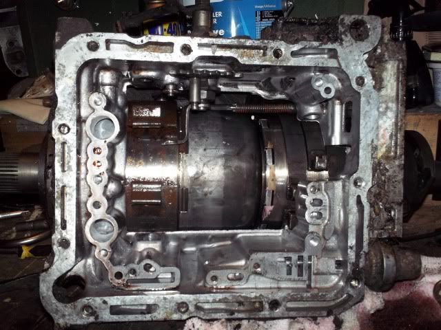

Well after fighting with the c4 pump I beat the snot out of it with a dead blow and it finally came out.
I now have 1 shaft ready for shipping.
Apart the c4 came to extract output shaft.

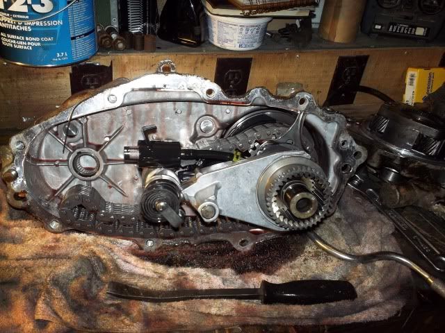

I pulled the 1354e apart only to find it has a 4 pinion planetary... :(
1354e apart with shitty 4 pinion planetary. I'm trying to locate a newer 1354e to rob the planetaries and associated parts from. For now this one will serve as template for doubler plate build, trans-tcase adapter build and output and spud shaft measurements.

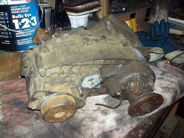

Also got the shaft out of the 1354, so all 3 shafts are ready for shipping as soon as I can get the doubler plate built and measure for the spud shaft and get the adapter built and measured for the output shaft length.
