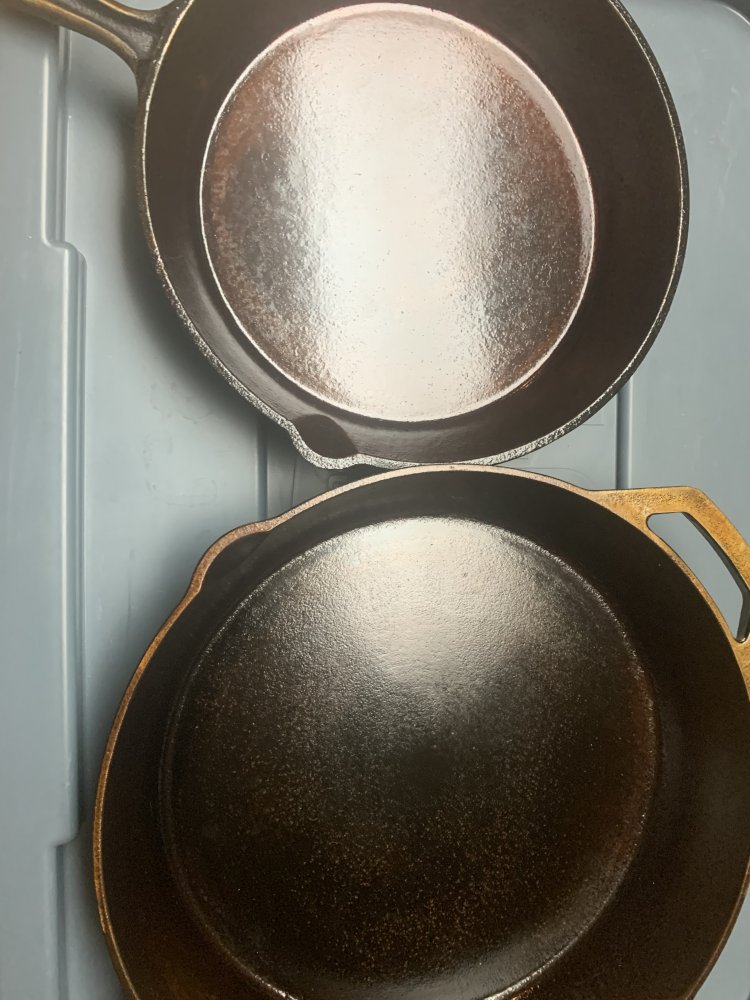

I seasoned the freshly sanded pans today...
46865
After seasoning them in the oven (oiled the entire pan), I put them on the stove over a medium flame (hot enough that they oil would just start to smoke very lightly) and wiped a little oil in them. I let that go for 15 or 20 minutes (until it wasn’t tacky anymore). Then another coat of oil and a good 30 minutes on the stove(until there was no smoke).
They now have a good couple a layers of polymerized oil like a pan that’s been used for years would build up over time... time that I don’t have because I wanted them ready to be packed away with my camping stuff. Normally I would just cook some bacon, sausage, or fry something in them for the first few uses, but I really don’t know what’s going to be the first thing I use these for.

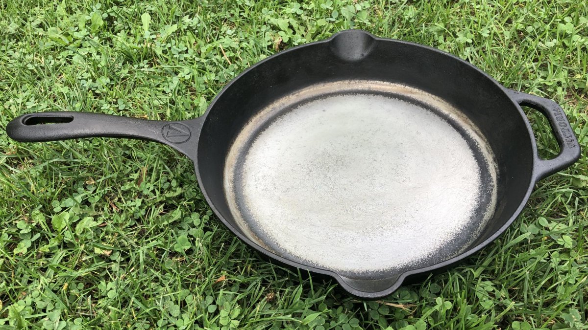

This is a $10 Walmart Lodge skillet I ground smooth years ago, and it's used almost daily - I spent more time on it and it's quite smooth. It's a little thicker on the bottom which is a help with an electric range. It's perfect for eggs, they don't stick at all.

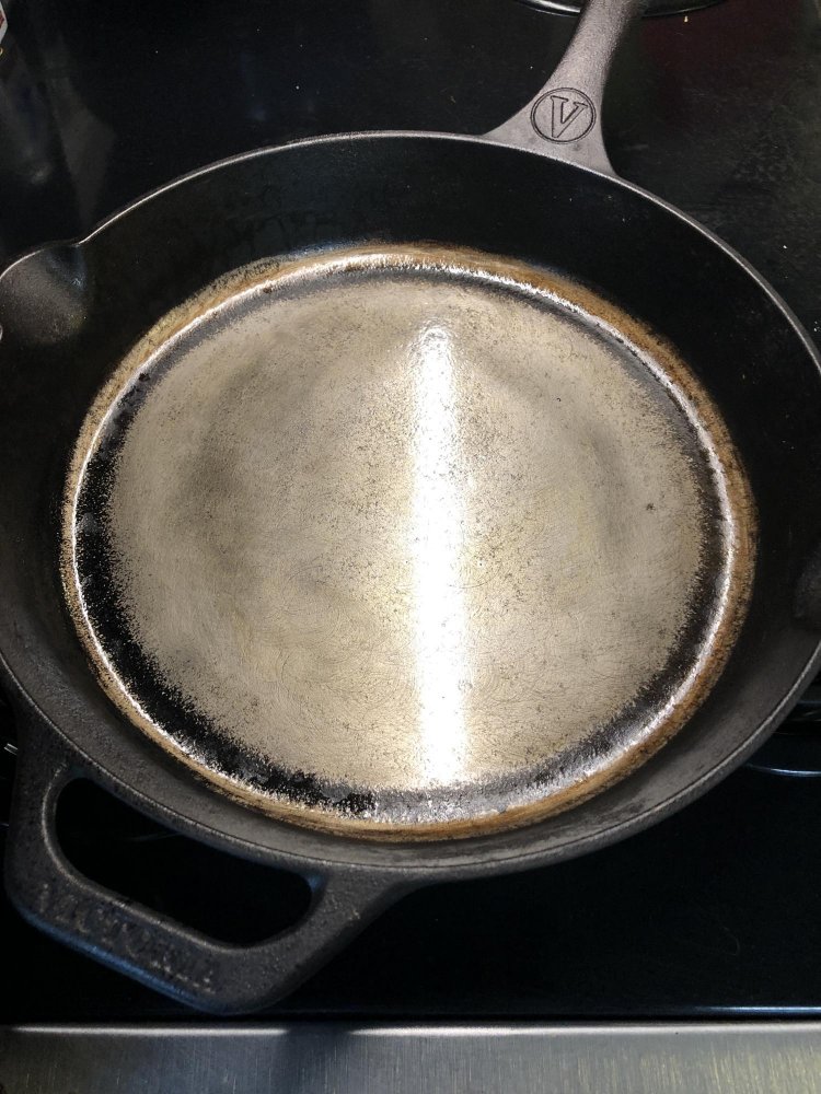

I just did this big, cheap Victoria of my Daughters. She bought it as a camp skillet but now it will be useful in the kitchen. I didn't get it as smooth as the Lodge but it shouldn't matter.
Just ground:
And seasoned:

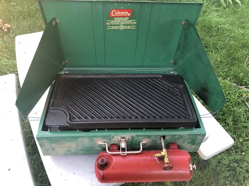

I am kind of a cast iron wimp. So far all I have is two double sided griddles for my campstove. Everybody be impressed, one is a Char-Broil and the other is a Bobby-Flay.

My wife made scallops on the newly ground out Victoria pan, and it worked great. I think that will be a good addition for my daughter's kitchen.
