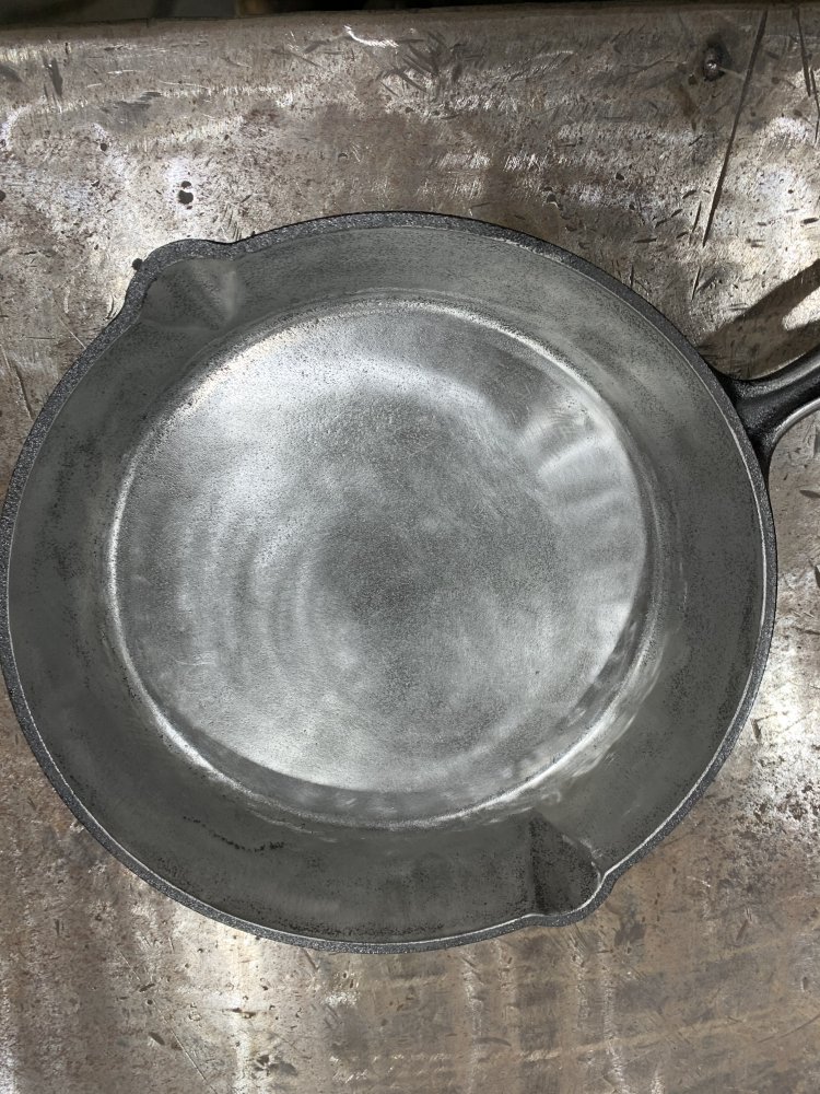

Too late.... Wiz wheel and a couple brown Roloc discs and she’s smooth. I wasn’t going for perfect, I just wanted to get rid of the 36 grit texture.
I’ll update with pics after dinner.

Do you have any $9.88 Lodge cast iron pans from Walmart? 36 grit isn’t exaggerating.

I consider this just speeding up the break in process. I mostly just knocked down the gritty roughness on the 2 of them. They still have that “cast iron” texture. I only used a surfacing cookie... not a sanding disc.
