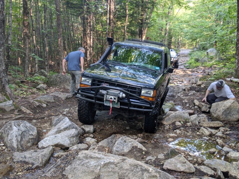

I decided I would post a thread about my truck. The folks around here have been so awesome in helping me get this build to where it is! The least I can do is post the process so that it might help others looking to do similar things.
My intentions for the truck started out as wanting to build "stocker" rig. I wanted a wheeling rig that was minimally built. My 2015 Tacoma is fairly built at this point, and I wanted a rig to make things more difficult again. Well all of that eventually went by the wayside as I got into the build! The idiot in me took over and now The Pig is way more capable than my Taco.
In this thread I will retell the story of my build and add anything new I am up to. I grew up around mechanics and auto body men my whole life, but there where a lot of holes in my knowledge. The Blue Pig is my first build from start to finish and it filled in a lot of those hole in my knowledge base.

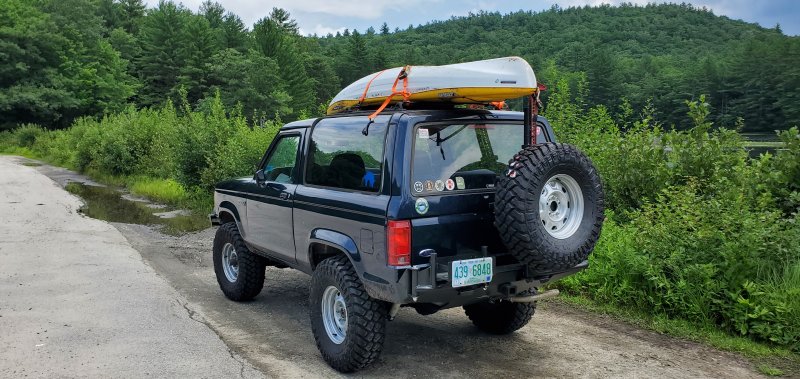

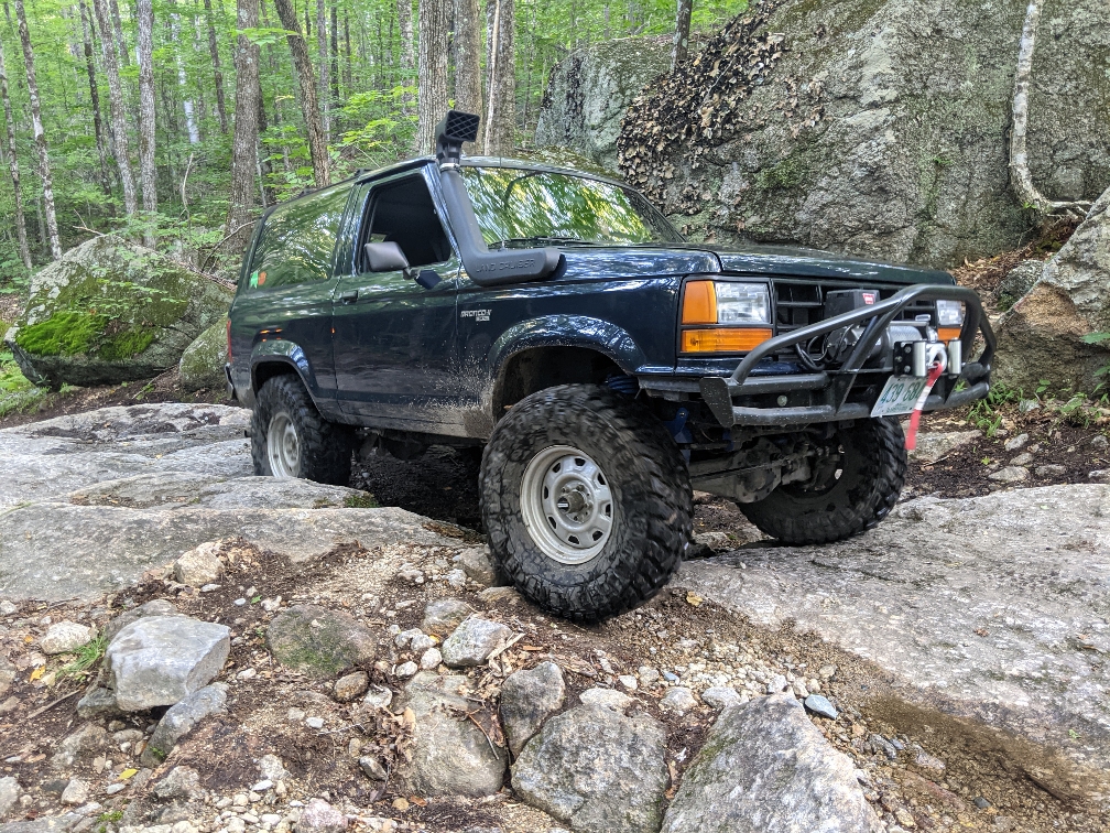

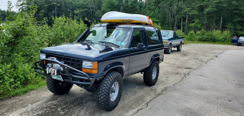

Here she is as she stand today!

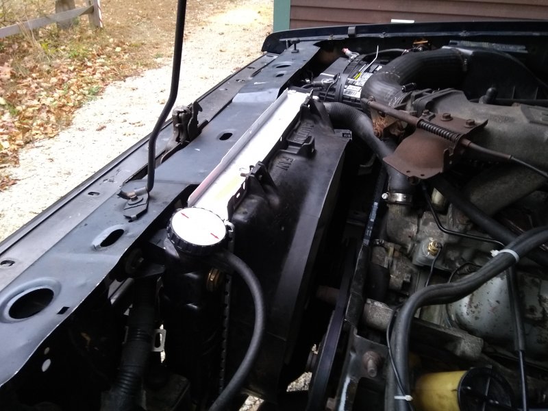

- 4.0 radiator to tame the HeadCracker

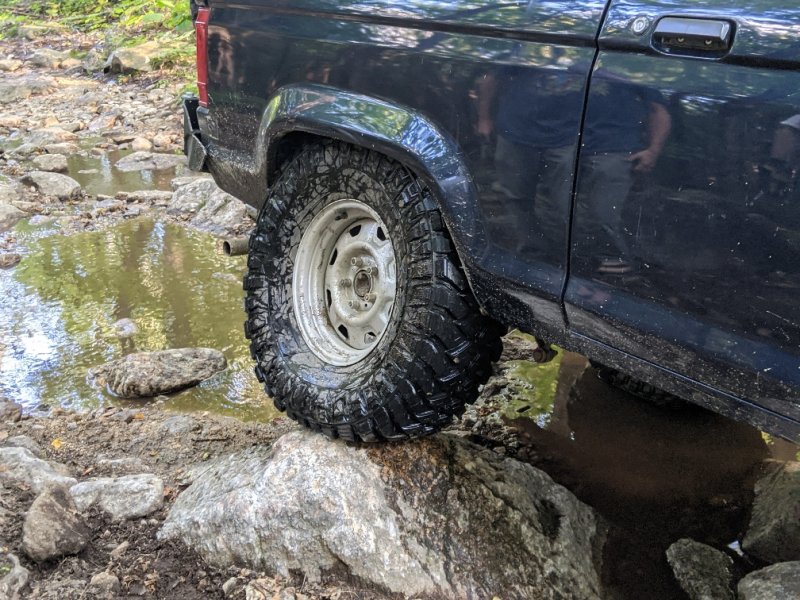

- 33x10.5r15 Maxxis RAZR MT Tires

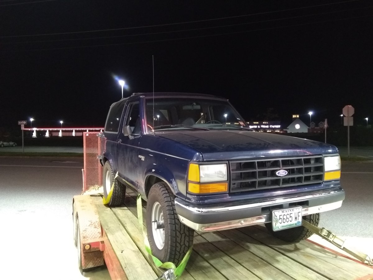

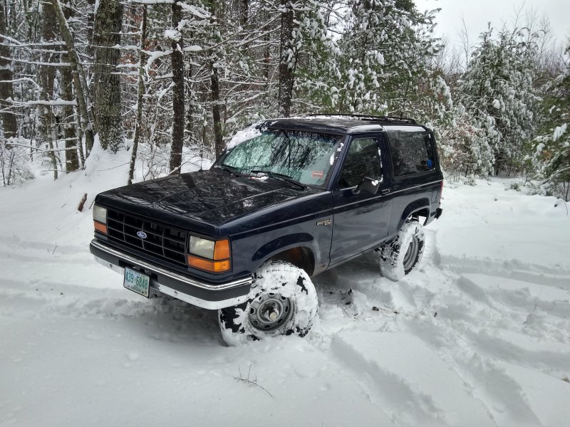

A long time ago in a galaxy, well....right here. Here she was in all her glory. My '89 BII from Maine with a blown head gasket. She spent a lot of her years on Martha's Vineyard apparently. How she wound up in inland Maine I don't know.

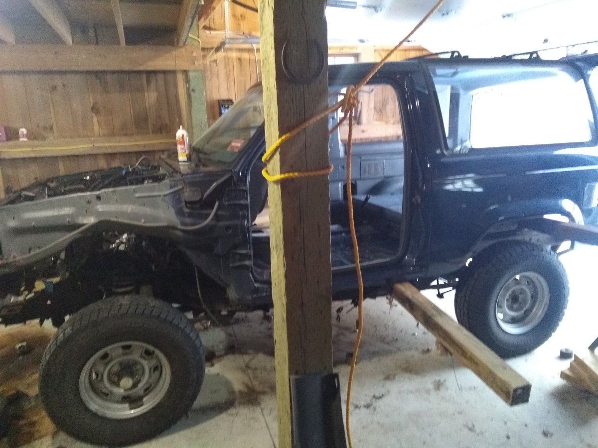

I played around with the engine until I had to accept that the heads where just F'd and the whole thing needed to pulled and replaced. What was the issue? Someone overheated it and the heads cracked...surprise!!

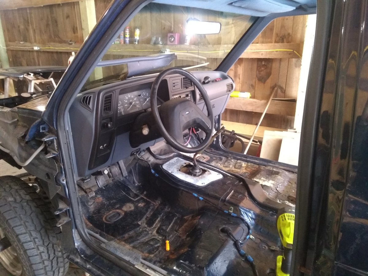

I set about tearing the truck apart and figuring out what was next.

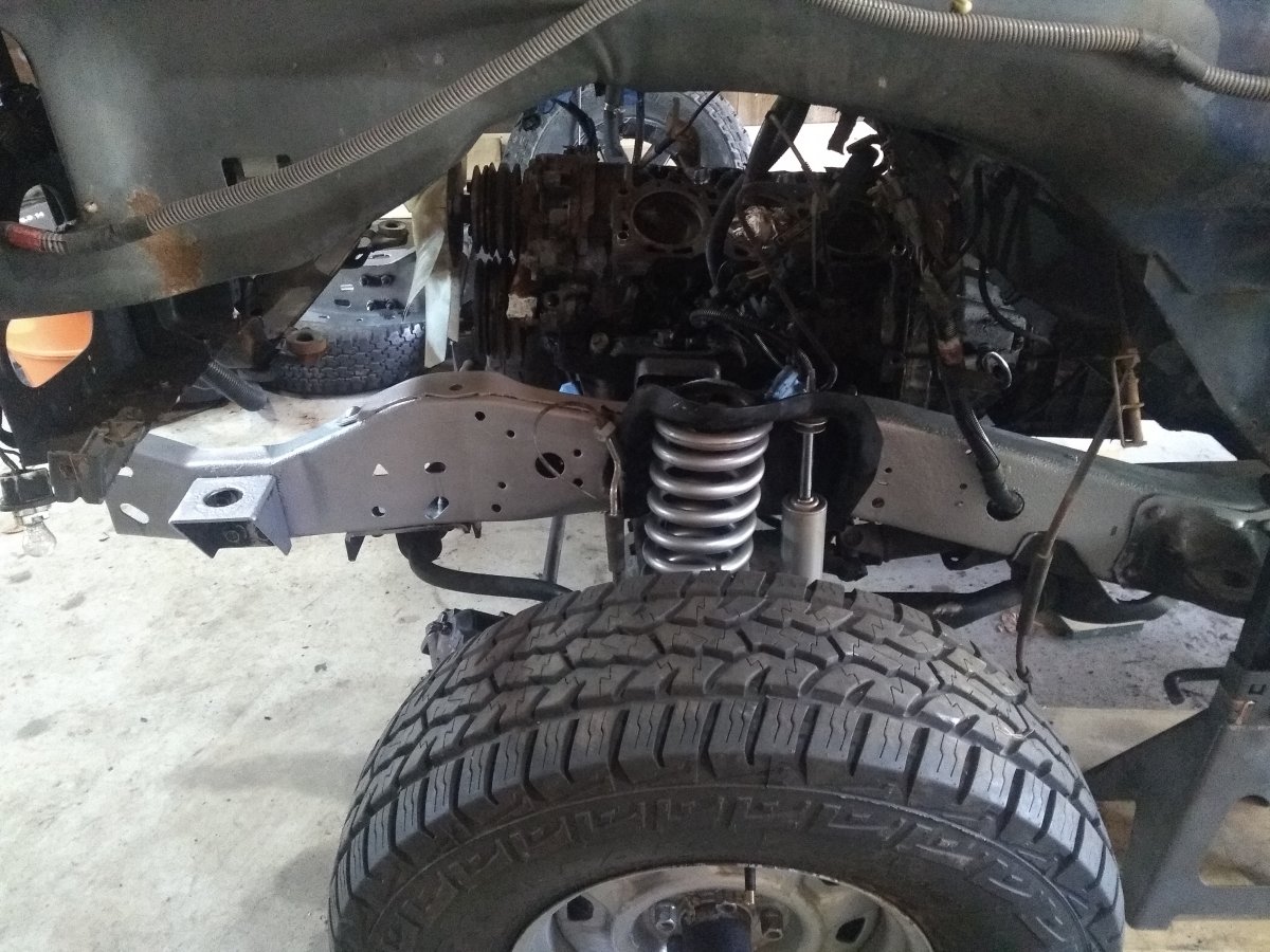

Rust-wise everything was pretty good, but the frame needed attention. I used Eastwoods rust converter followed by a black topcoat.
73111

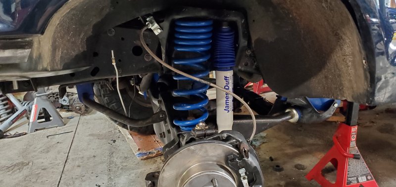

In this pic you can see I installed a Rough Country 1.5 inch lift up front. In the rear I used Wulf shackles. If you are look for a cheap way to get 1.5 inches of left, that is the way to go. Eventually, I went with a Duff stage 1 as you can see in the next post.

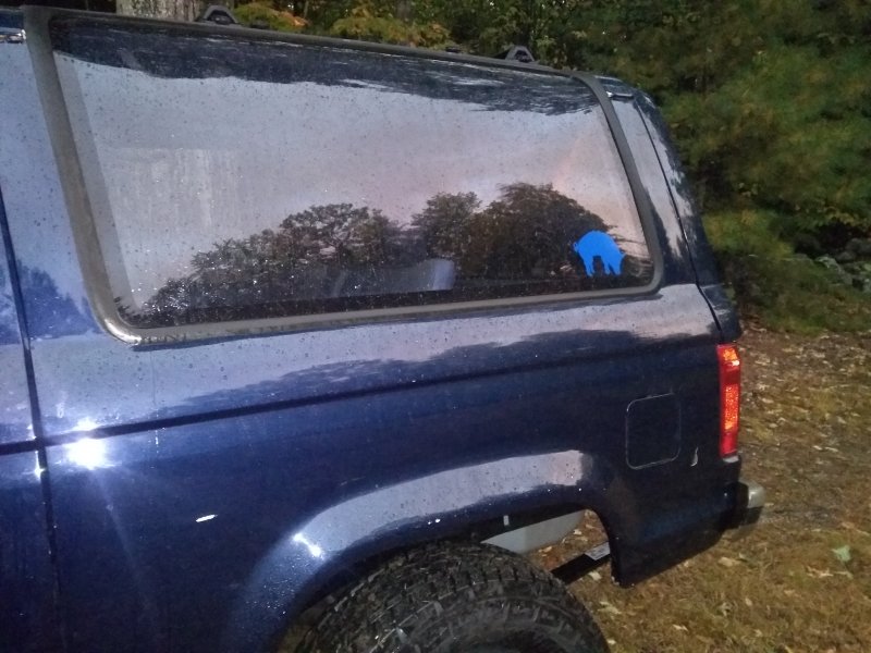

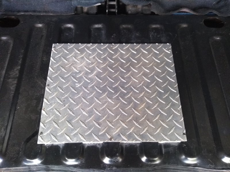

Fuel tank access panel:
73512
4.0 Radiator:

New tire day (and a shameless pic of my Taco):

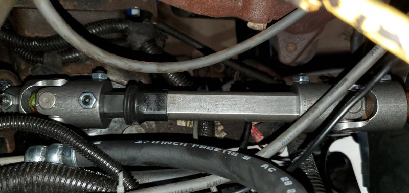

New steering rod:
73515

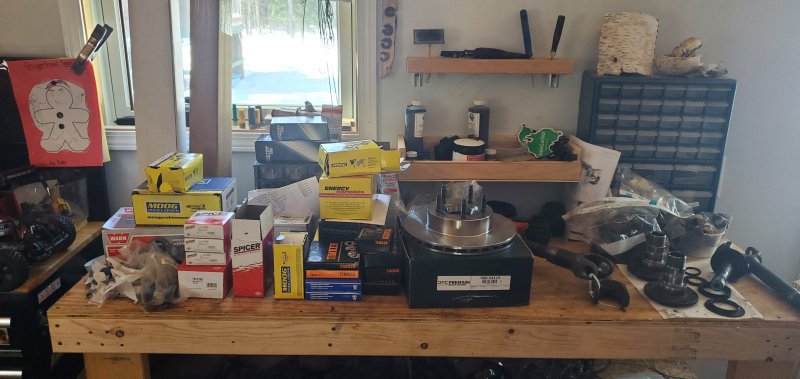

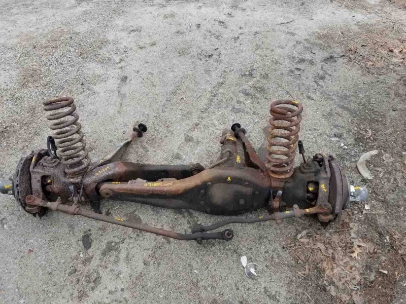

Since I was going to run 33s only, I decided to keep the 7.5 and rebuild it. Upfront I swapped in a Dana 35 from 92 Explorer. Both recieved 4.56 gears and lunchbox lockers (Aussie up front, Lockrite in the rear)
Donor D35:

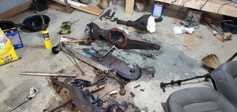

First order of business was to disassemble...much carnage:
73487

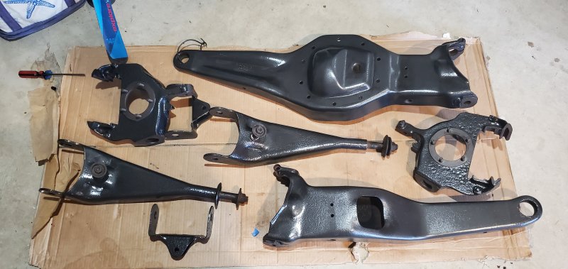

All parts hot tanked and painted with Rustoleum Hammered.
73484

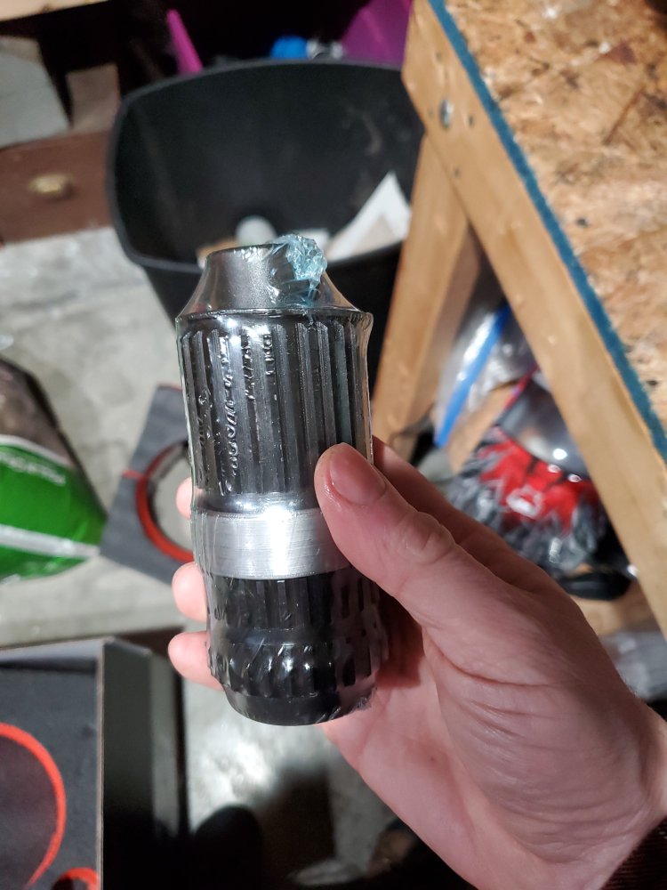

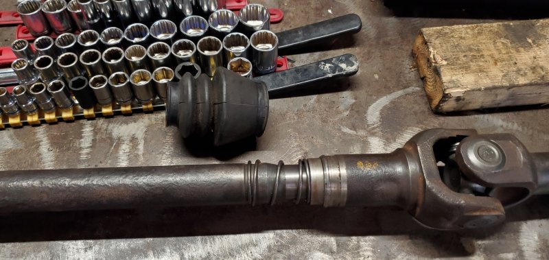

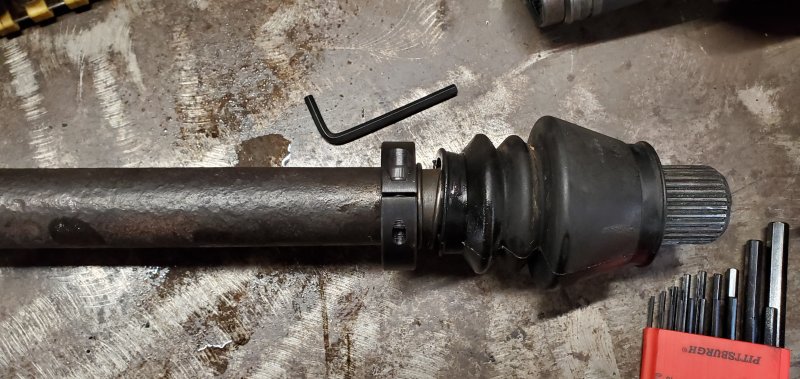

C-Clip eliminator:
73493
Used a clamp to hold the spring (and no I don't remember where I got it. But it was from some industrial supply place)

Some Duff love with extended brake lines:

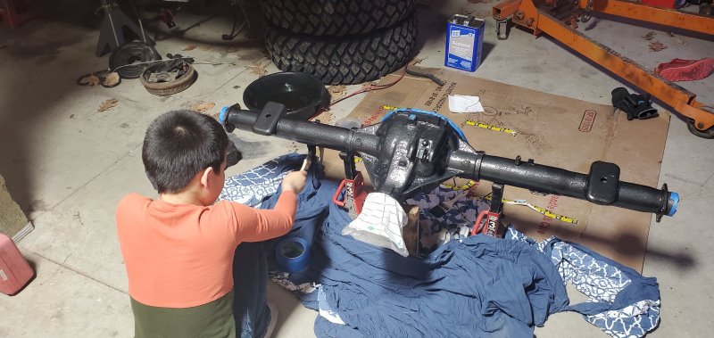

On to the 7.5! Paint it boy!

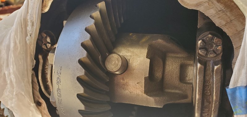

When you try to stuff 4.56 gears in a tiny 7.5 axle, you are gonna have problems. Opps...pin dont come out.
73492
A dremel and about 60 min of careful grinding solved this problem (no issues with this 1000 miles+ later BTW)
73491
This is how much crap you need to rebuild axles!
73485

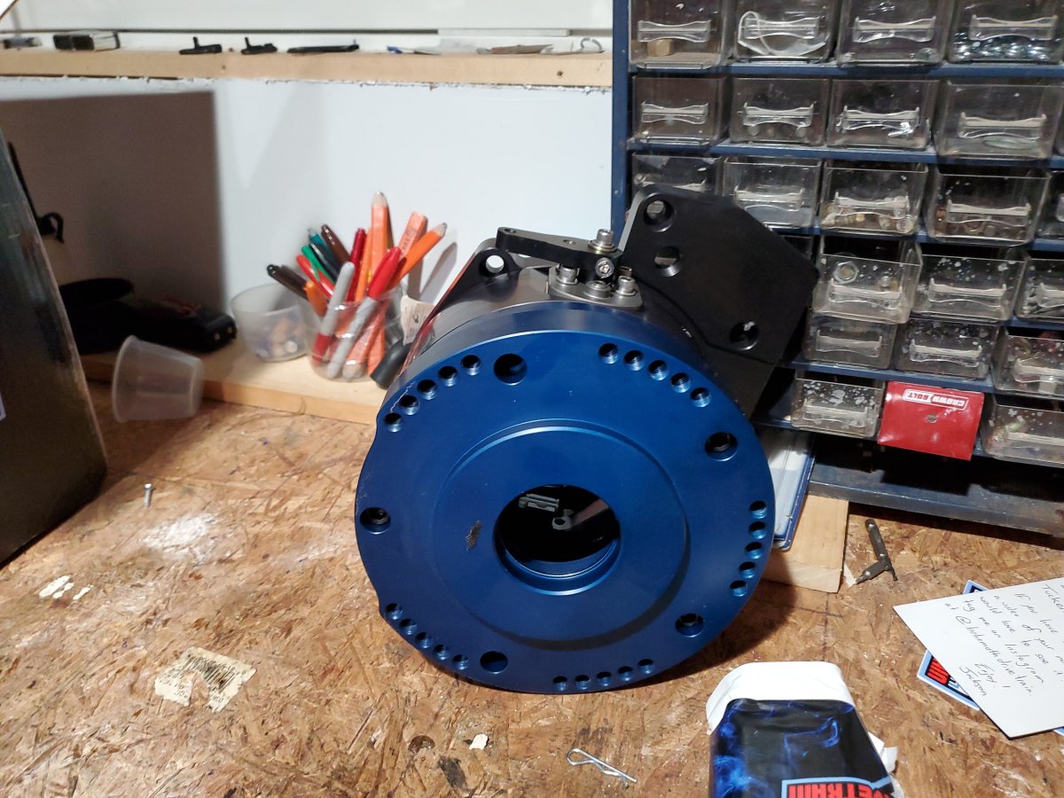

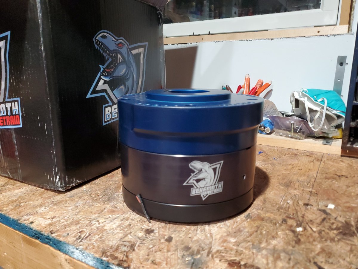

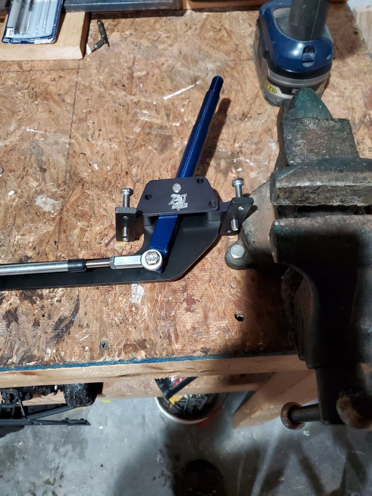

Look what arrived! Behemoth Strongbox Shorty. I would like to keep the electric T-Case I have in there now. I spent a lot of time making sure it worked properly, and I kind of like it (I understand that a manual would be more reliable). This should give me a 6:1 crawl ratio when the Strongbox is engaged! Now I need to track down an M5OD, as the fm146 I have in there now is about done.

Wow .... That's gonna be seriously badass...the electric is fine. Just keep a spare harness and computer for it....along with a motor or two....where I shop that's 60 bux or less.
The lockouts are a different matter. Looks like a 28 auto lock hub in the pic.
Your potentially screwed. You triple the torque, those oem axles won't like it bound up
Going to a d35/44 hybrid or a d44 may be the smart move with a doubler..a ttb 44 with RCV shafts would be epic and allow for some fearless wheeling.
Careful driving ftw....
Those are old pics. I have a D35 up front with manual warn hubs. The first pic in the post shows the new front axle. I don't see any reason that wouldn't hold up.
And you are absolutely right. I should carry spare motors, etc. I'll put that on the list.
