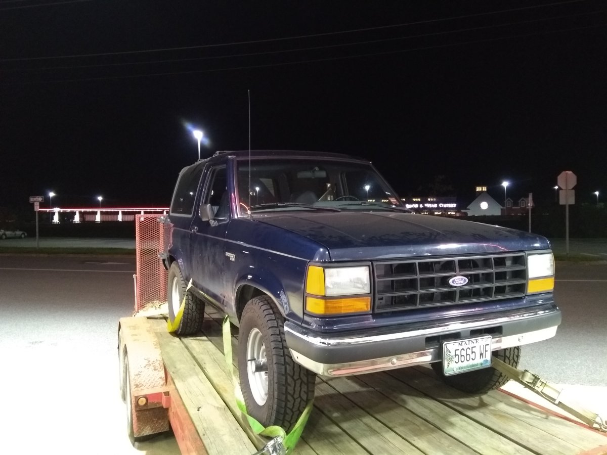

A long time ago in a galaxy, well....right here. Here she was in all her glory. My '89 BII from Maine with a blown head gasket. She spent a lot of her years on Martha's Vineyard apparently. How she wound up in inland Maine I don't know.
That was 3 years ago...ouch its been a long build.

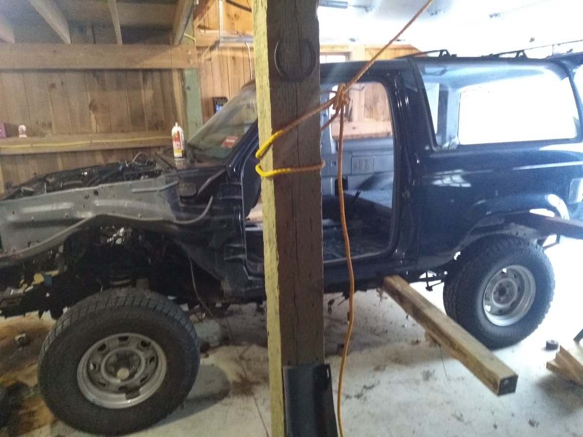

I played around with the engine until I had to accept that the heads where just F'd and the whole thing needed to pulled and replaced. What was the issue? Someone overheated it and the heads cracked...surprise!!

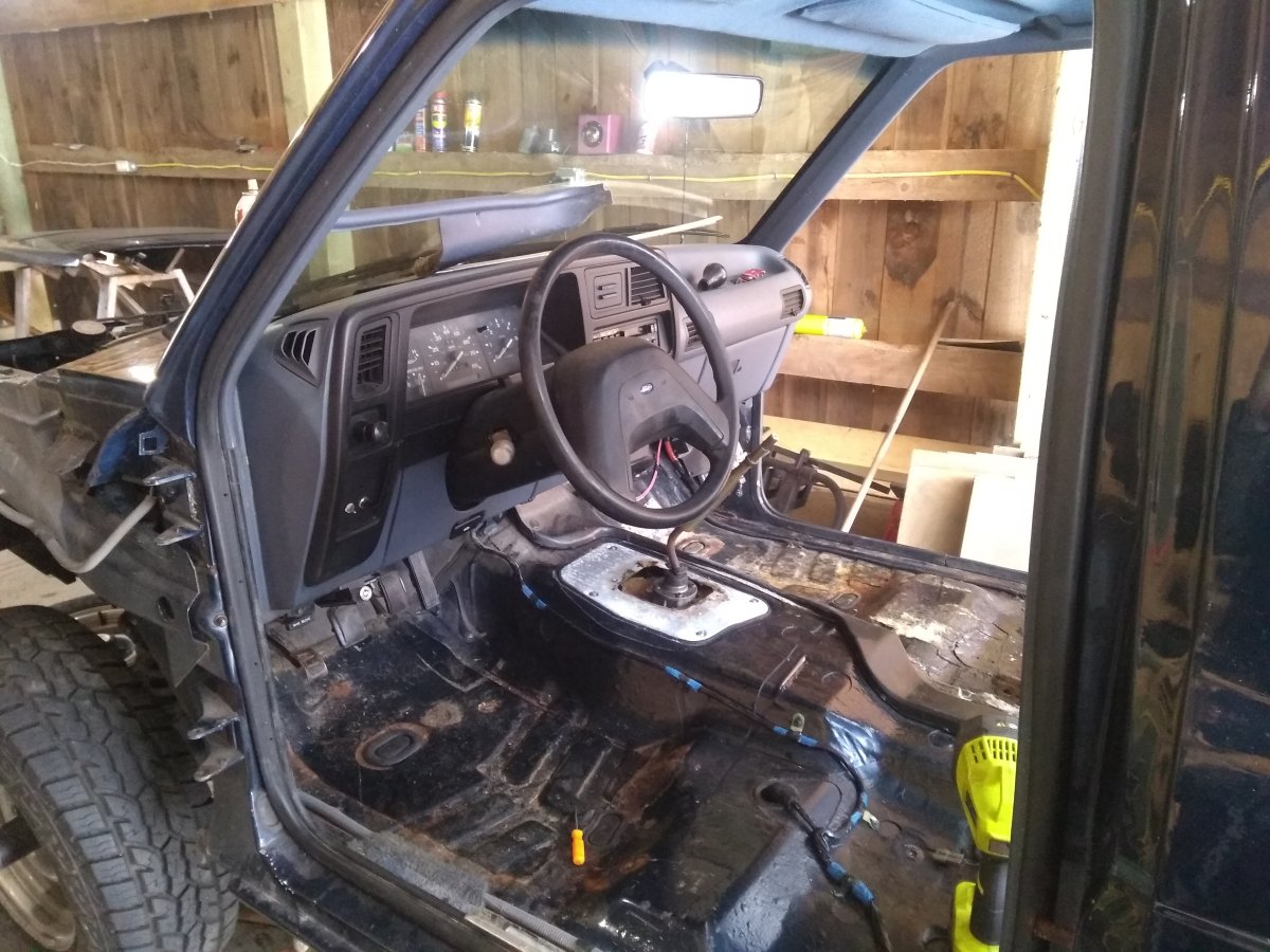

I set about tearing the truck apart and figuring out what was next.

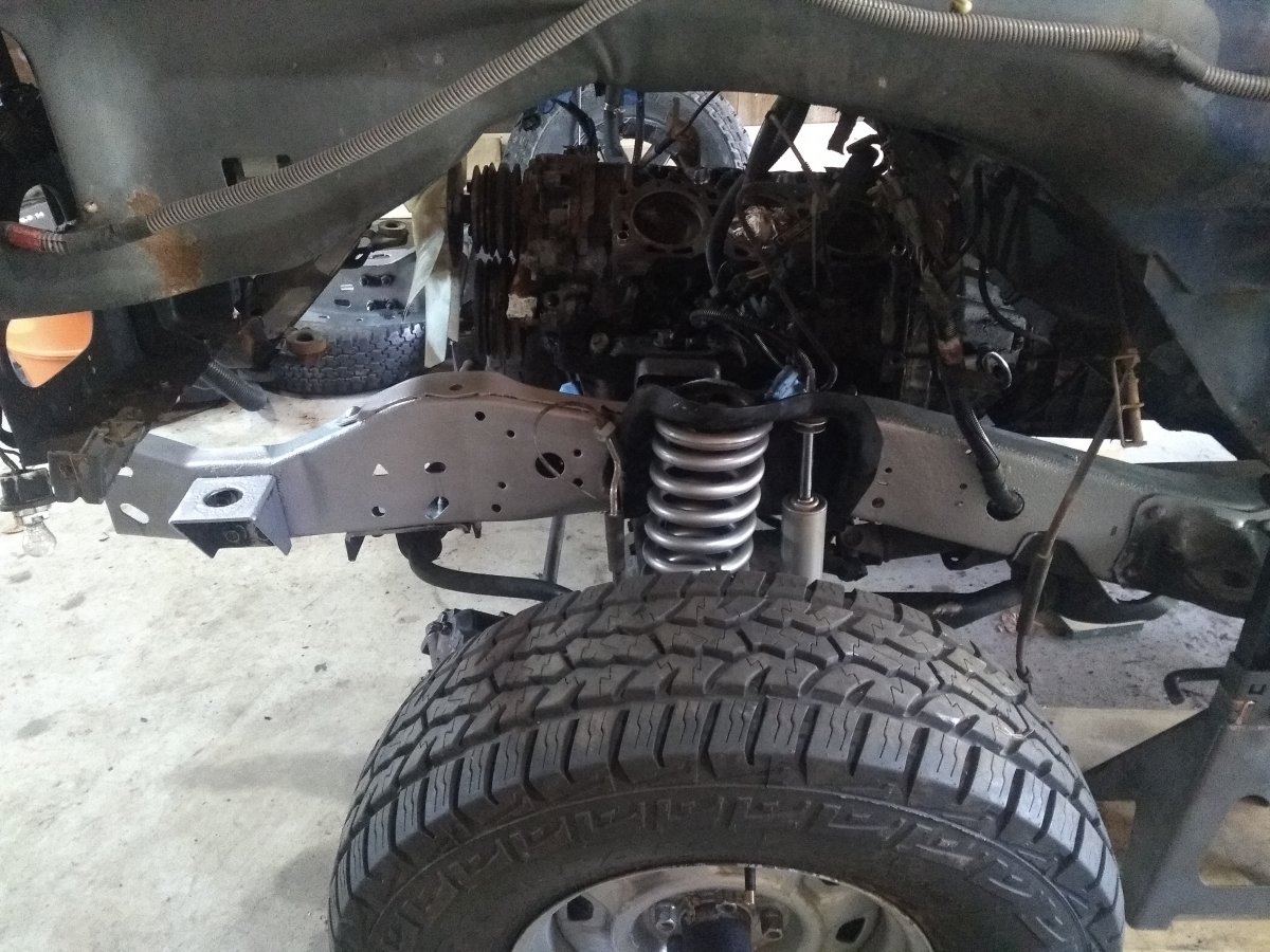

Rust-wise everything was pretty good, but the frame needed attention. I used Eastwoods rust converter followed by a black topcoat.
In this pic you can see I installed a Rough Country 1.5 inch lift up front. In the rear I used Wulf shackles. If you are look for a cheap way to get 1.5 inches of left, that is the way to go. Eventually, I went with a Duff stage 1 as you can see in the next post.

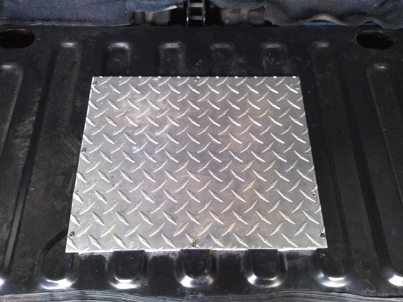

Fuel tank access panel:

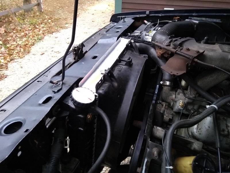

4.0 Radiator:

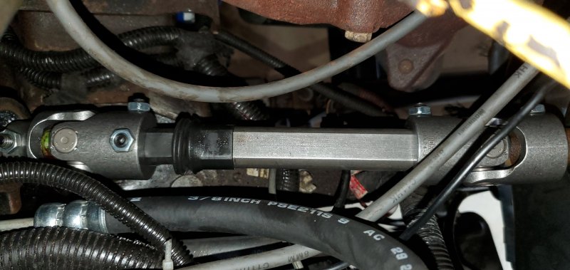

New steering rod:
what did you use for a steering shaft?
Second that on the steering shaft.
I bought Bronco II and it already had one on it. I swear he said he got it from Bronco Graveyard... but they don't have it listed.
