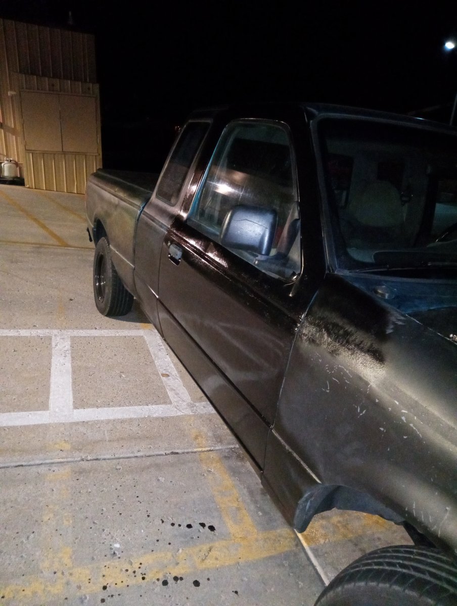

So, as you may have seen from my previous threads, I acquired a 95 XL extended cab from a tow yard at the beginning of April. It' needs attention...a LOT of it. Had I known what I was getting into, I probably should have passed on it, especially what I've discovered since. I plugged the VIN into Carfax. (That's when I realized the last 3 is 666. Carfax said the manufacture date was April 1 of "95. But, it has a sound engine, and I was thinking it would be mostly cosmetic. Oh boy, was I wrong.
This thing has been neglected big time. In the last two months, I've had a clutch failure, catastrophic transmission failure, and have discovered the extent of the neglect and modification.
I can truly say, this thing seems to be held together by drywall screws and gutter hangars.
Hence, it has been dubbed Abaddon, which is an ancient Hebrew name for the devil.
The first improvement was to replace the lights. All lenses were broken, and the headlights were so yellowed one could barely tell they were on. After that, I removed the sound system. It had a decent head in the dash (more drywall screws) a 3800 watt amp drywall screwed to the floor, and then the old tower home theater speakers, held in with (yup) more screws And gutter hangars. The speakers were completely blown, the head and amp were wired hit so they couldn't be turned off. And the speaker wire was brown household extension cords that had the plugs removed.
I'll post pics the brakes when I do them. The drums are trashed. One could stack three quarters in the grooves. Pads are on the river heads and rears don't even make contact.
I'll post a list of the project so far. Pics as I can. I think a couple thousand more, and I'll have something I can trust.

Another fun discovery: it originally came with 14" rims, (tire size 215/70/14).Previous owner put two different sizes of rims on it, then smaller tires on front than on the back (295/95/17 on back, 235/75/16 in front.). This effectively wore out the ball joints and drag link, as well as tie rod ends.
Since one can't get 14" 5x4.5 rims any more, I found an online size calculator that computes closest tire size to original, and now running 15" rims with uniform size tires. HUGE difference in handling.

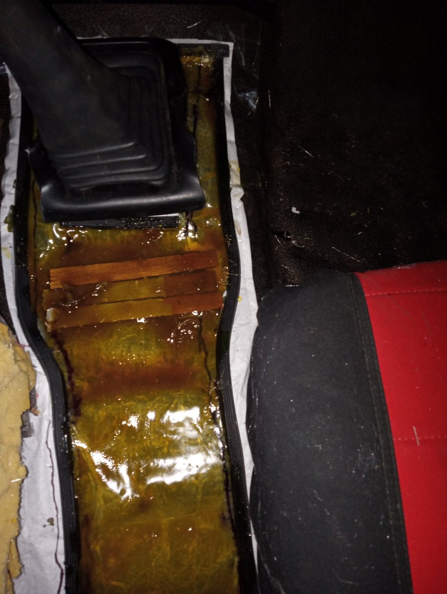

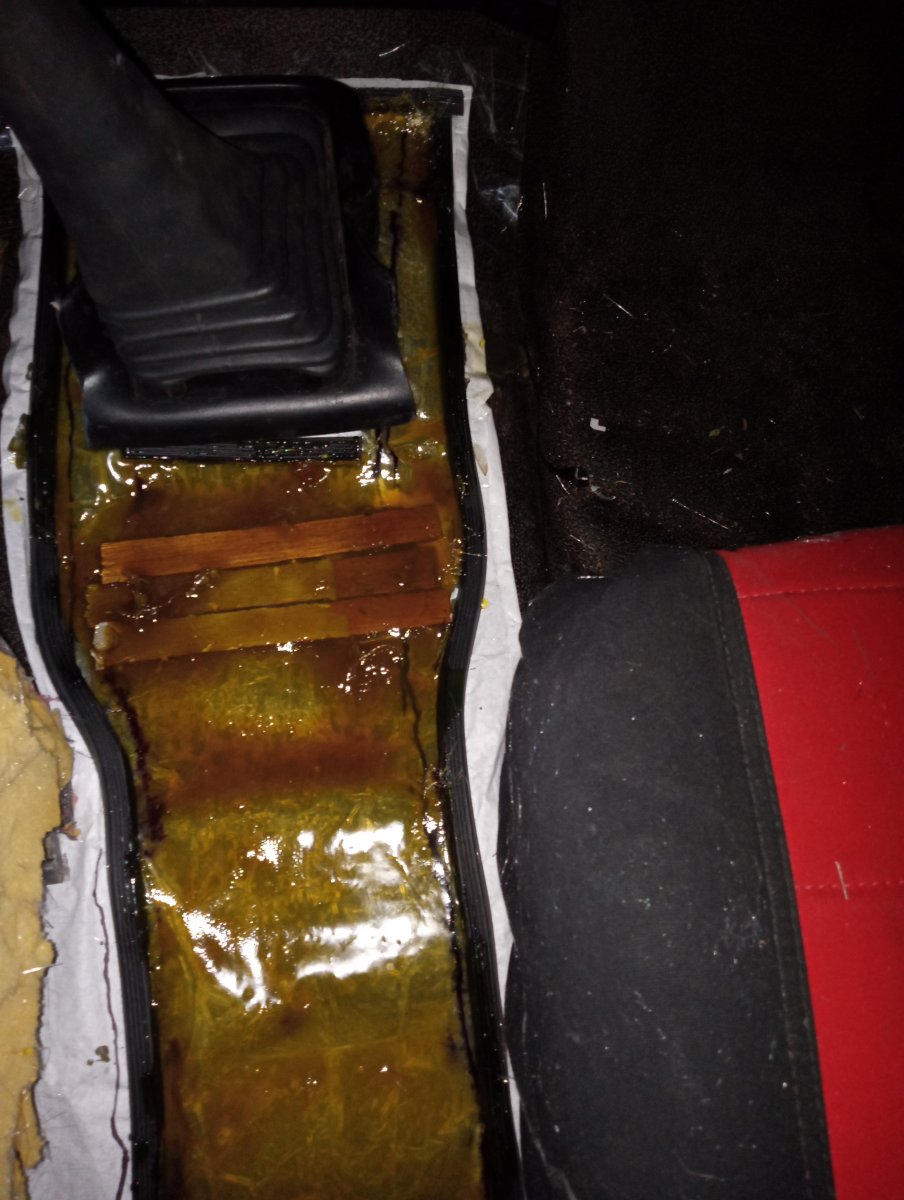

But today I started on construction of the center console. After removing the center portion of the drivers seat and the frame (doesn't matter, it's getting redone anyway), I decided to use sone old knowledge from my Halloween prop making days. First, I laid some plastic drop cloth cut to basically the shape I need, then after figuring out seat travel, I used a self adhesive rubber seal from home Depot to lay out the basic shape of what I plan to build. Then, using fiberglass mat, I applied resin to get a good shape of the contour if the transmission tunnel. I'll be reinforcing this base after a couple days with wood strips and more resin.
To shspe the actual console, I'll use that pink 1'3)2":insulation board. I plan to glue it into a large block, then using my hor knifebasnd a normal knife, l carve it to it's final.design.
Once this is done, the entire thing will be costed with fiberglass then sanded and ultimately wrapped with what I have chosen for the new interior color scheme. More pics as the project progresses...
The shift boot us not attacked, but will be shaped better using body putty and incorporated as a drop in unit into the front portion of the console. That way it can be easily removed if necessary without pulling the whole unit

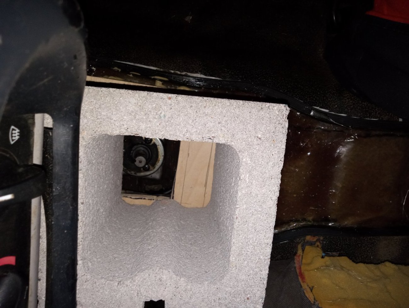

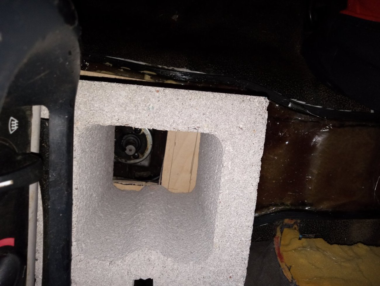

Center console construction.

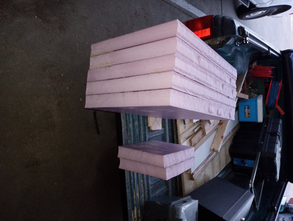

I acquired a sheet of EPX foam today, the stuff used to insulate buildings. It's great for carving and holds shape really well. It'll also take fiberglass resin pretty well, as long as the first couple coats are relatively thin. So, I started with cutting pieces to build a blockmatching the largest dimensions needed. In my case, I decided to use a separate block for the shift boot, it's just easier I think. There is still the option to join them together into a solid unit later. Besides, smaller pieces are easier to work with.
I need a piece that is 16 inches high, 24 long and 10 thick, so that meant cutting five pieces of 2" material and then used liquid nails to fix them together to get to ten inches.
The second piece for the shifter needed to be 10x12 (always start a little big) and two pieces gives me a depth of 4.
While that was curing, I cut a piece of wood and put a hole for the shift lever,, then with liquid nails, affixed it to the fiberglass base I made to contour the transmission tunnel. A cinder block works as a weight to get firm cure. Now I wait.
