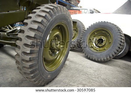

This topic reminded my of the tires on the old military vehicles. Just as good traction going forward as going backwards.
I think most tires are designed to have optimum performance when going forward, while still being able to film them around any which way. Which doesn't make much sense now that I think about it.
These tires you show have no side to side variation. What I'm saying is tread can be mirror image (though offset) but be directional as in regular tractor tires.
Your pic tires are not mirror images but they are effectively mirrors because they are the same everywhere. You can flip them or drive them any way you want and they work as well.

Great pic, thanks.
Now, where do I get these in 31x10.5R15? I suspect on the road they would be a bit noisy, but who knows.
These are for 16" wheels, but they are about 30.5x5.8xR16. They also sell some for 15" wheels that are about 29.5x5.8xR15.
Seems like old military tires like these were all fairly narrow.

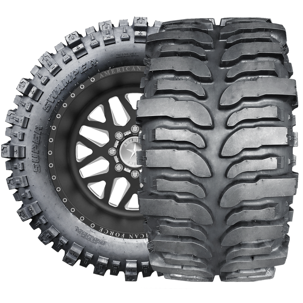

Could always go with a TSL Bogger. That is also kind of symmetrical.
I think they have a 31x12.05R15
I don't think you would find anything truly symmetrical. Problem being, the lug spacing. You don't want to have a tire with a big lug on the left and right at the same point. It would give you a terrible ride and bad traction all in one. If you had a big lug that went all the way across the tire you are spacing out your pressure across the entire with, diluting it.
They clock the big paddles on these tires so they are alternating, that way you always have even pressure on the ground. The big paddles are not for increased traction, but to help dig down and throw the loose mud away from the tire.

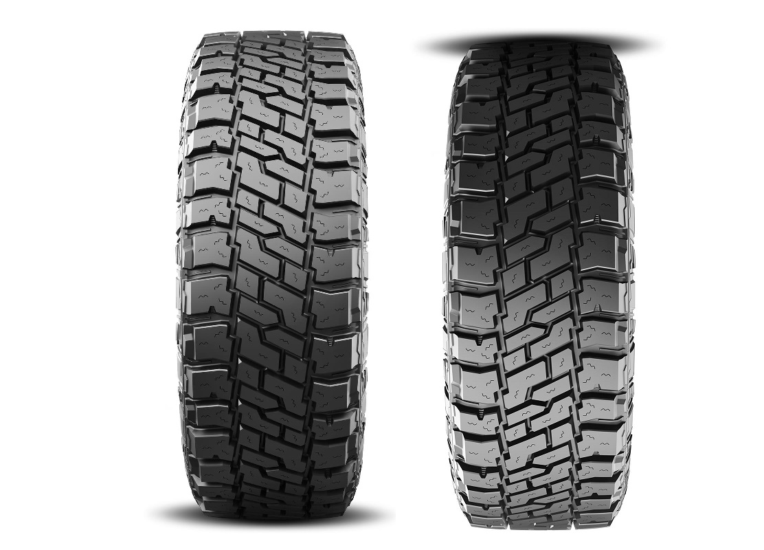

Take for example this tire, which I'm looking at as a probable when I upgrade tires:
Mickey Thompson 52510 Mickey Thompson Baja Legend EXP Tires | Summit Racing
That is not a symmetrical tire. No matter how you turn it or flip it, you will have the lines that you see running diagonally through the middle part of the tread running the same direction. They won't be mirror images. As I said it's like you will have 2 lefts or 2 rights in a sense.
To me it seemed like flipping the face - for instance those M Thompson tires you could do that as they are not OWL and it looks like there is no front/back, I think the faces are identical - it seemed like flipping the face would do the trick but it just doesn't work that way. I made little mock up tires/tread and turned them around and turning something asymmetrical 180 degrees does in fact reverse it but if it's not symmetrical you end up with that weird situation that is bothering me. Obviously it's not terribly important or it things wouldn't be like that, but you see what I'm saying. To me the two sides should have the tread as a mirror of the other side. A lot of tires look on first glance like that's true, but, they aren't. Regular street tires probably just about always are symmetrical, but not a/t tires.
This is a picture of the tires linked. Left is the original, right is flipped, as if on the other side of the tire was facing out. Yes, You are correct, mirror images. I believe the "Aqua Tread" design was truly symmetrical and directional at the same time.

The TSL Bogger qualifies to me as symmetrical, as I noted, perhaps in the other thread on this, the 2 halves, as if you sliced the tire vertically, don't have to be lined up side-to-side because they are continuous so while it's not symmetrical per se, it does qualify as symmetrical for what we are talking about and yes it's directional. Nice. Awfully wide? Could I even put a 12" rim on my truck and would the tires fit without rubbing? I kind of want to pursue that more even though that's a more aggressive tread than I might be thinking, it would be awesome in snow, dirt, mud, on rocks - everything, right? Maybe a bit noisy. But most places I would go are say w/in 50 miles of here then I'd have a set of road tires. If I weren't going on a trip I'd probably leave them on in the winter for those occassional snows we have.
Yes about the lugs and offsetting the sides. I totally agree, and thanks.

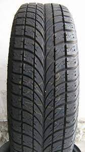

@Ranger850 just to clarify I assume you made mirror pictures, as well as flipped them 180 degrees (large pic). Because if was -only- flipped over, it would look the same. In the left pic, there is an angle running upper left to lower right, if you flip it over, it looks the same (angle runs same direction). So you must have not only flipped them but mirrored them. You could have just mirrored them and got the same result. What we are seeing there is two different tires. I think that's what you meant, tell me if otherwise. To have what is shown, you would have to order 2 lefts, and 2 rights. No one I know does that at least not commercially.
In the small pic (Aquatread), yes, that's truly symmetrical and directional and no doubt has arrows on it telling you direction of rotation. For street/rain tires you can find them, I think I ran directional tires on the Fiesta back when for the track. Shaved, which at the time seemed ridiculous to get new tires then cut off most of the tread. They stick better though. You had rain tires too.
