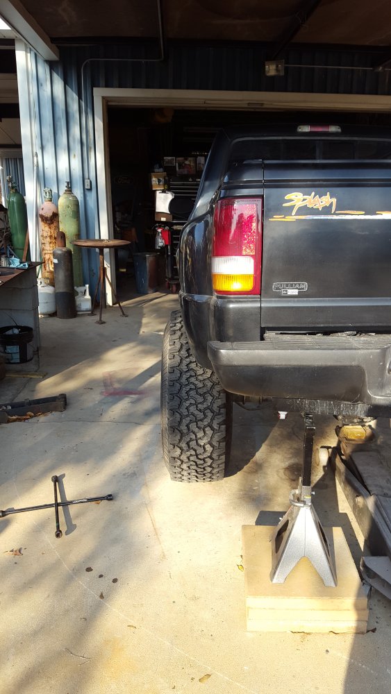

Nice Splash.
How are you getting all that snow in SC??
Is that AOR bumper?
Are the side bars connected to the frame or are they just steps? Do you like them?
That is a giant tire. Do you notice less pep on highway or is it not a factor.
I like it.

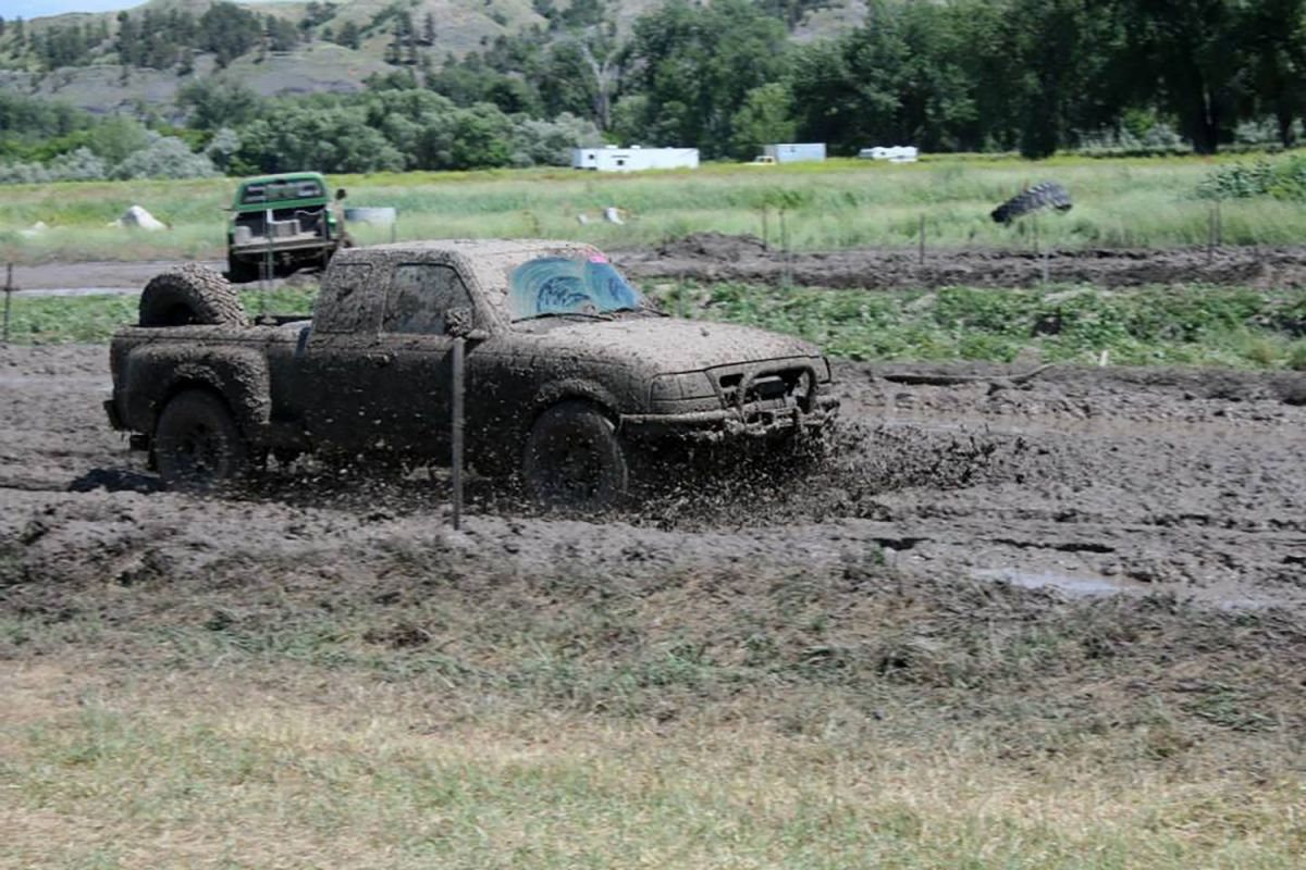

Holy crap Batman. He'll need a trip to the car wash. His spare doesn't look like a mud tire, does it? Is he running those? I'll check out the site, thanks.
The boggers are good for bogging, and that's about it. The tread isn't much good at side-hill/off camber traction, just digging forward through sloppy stuff. The classic super swamper (or any if it's variants) would be a much better pick if you want an all purpose tire.. but terrible if you need to deal with snow.

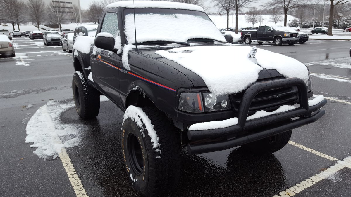

Nice Splash.
We usually get at least one light snowstorm per winter. Normally melts away in a day or two.
Is that AOR bumper?
Old Jeep bumper. It's been modified several times and is about to change drastically again because I recently got hit by an angry tree
Those are custom built rock sliders. They are bolted directly to the frame. I love them. No more lower body damage.
I regeared to 4.56, which puts me almost exactly back to factory gearing performance. But, with the extra weight and rolling resistance of the tires and bad aerodynamics from the lift, my fuel mileage is down to about 15mpg average on the street. It's a 3.0l engine with 5 spd manual. So, it's no speed demon.
I like it.
Thanks
