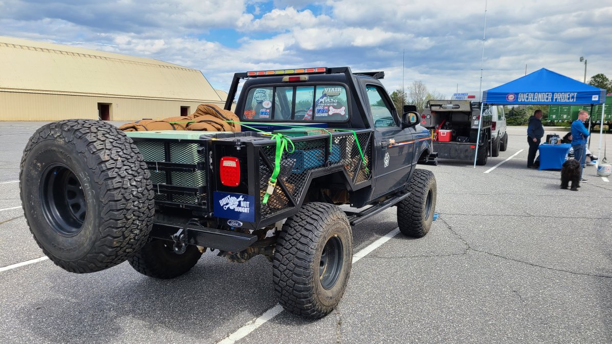

When I bought the truck from my in-laws, it had General Grabbers on it. Honestly, I didn't really pay much attention to what they were except that they were wore slap out. I did take the truck wheeling on some difficult forest service roads and it surprised me with how well it did. That's when I figured out I had bought a great little mountain goat. But those were street tires. Not even close to what I need.
When I began planning my build, I decided what size tires i wanted and soon began watching Cragslist for tires and wheels. A guy in Charlotte had a set of BFG A/T's that had been on his Jeep for a few years while he did his build. They were old. But they had almost no miles on them. Still had most of the little rubber ties from manufacturing. I also found a set of 15" x 10" wide steel wheels locally to put them on. Those got me by for a few years and they're great tires. The wheels had been previously abused. I had to beat them out as straight as I could. I had trouble with that tire and wheel combination and never could completely get rid of a vibration problem. When I first got them mounted, the balance was off so far that instead of clip-on weights, we used balancing beads. Imperfect wheels? Old tires? Not enough balancing beads in the tires? Who knows.
Finally, I saved up for a new set of wheels and tires. I opted for the mud terrains this time because I have been doing more aggressive offroad driving. These are on straight rims and they balanced well with traditional weights.
I prefer steel wheels. They are more durable for what I do. I like BFG tires. I used to work for Michelin (mai tenance tech at their Lexington, SC plant and was with them when they bought BFG. I am very loyal to Michelin and BFG because of their corporate philosophy regarding quality. I ran BFG Mud terrains on my 88 F150 and they always did what I needed, probably at least 4 sets. I still pay attention to other tires and have to watch my budget. BFG's aren't perfect for every situation. It depends where you're going to wheel with them. Guys out west in desert sand and the big red rock like at Moab need totally different tires than what we use here in the east. You can see that when you watch them on YouTube. Watch video series like ultimate offroad field trip and Great American Crawl and pay attention to how each rig performs in different parks across the country. Besides the education, it's just fun to watch.

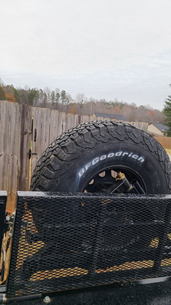

These are OWL tires, mounted with the lettering to the inside. Absolutely no effect on performance.
