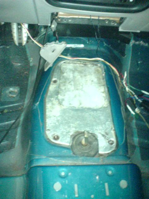

Where does the shifter come thought the floor in relation to the stock shifter?

The shifter comes through the floor HERE:

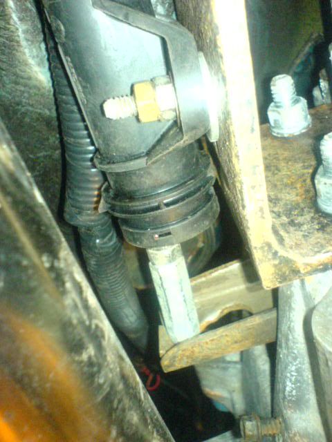

You can use the stock line if you use a slave cylinder from an '83/'84 Ranger V6. This is an external mounted slave, with the connection in the propper spot.
Most likely, you will use a generic slave, like from a Nissan 280Z. That has a standard type fitting.
I uses THESE, to mate the stock Master cyl to a braided line, to a Ranger (83/84, DIESEL) slave. I got the line from Summit or Jegs.
http://www.summitracing.com/parts/RUS-640281?autofilter=1&part=RUS-640281&N=700+115&autoview=sku
Here's my setup. The 3 models of Ranger in '83/'84 had three different slaves. They differ in the way they mount. The 4cyl mounts like an F150, has no bolt holes. The V6 mounts with bolts in the opposite direction of mine, in line with the push of the slave. The diesel (mine) bolts at a right-angle.
Also, as this slave, and most I've found, have a 3/4" bore, I needed to swap my Master cyl. The stock Ranger one (on my '97, and I believe most) has a 5/8" bore, and would not give the slave enough travel. I used a master from an '89 2.9 Ranger, it has a 7/8" bore (new at NAPA). You check my build thread on RPS for pics of how it went on. It bolts to the firewall like '94-older Rangers. Newer Rangers have the Master clipped on to the pedal assembly.
