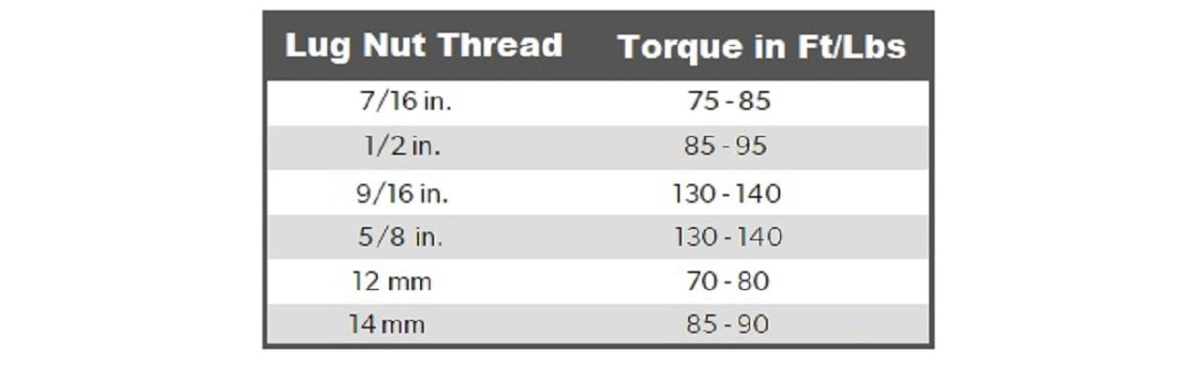

I've had this chart hanging in my shop for decades.. and that's what I've used to set the torque wrench to.
With luck they'll stay on, I assume you have 14mm lugs which are close to 9/16". Are they your only choice for a dealer? Our Ford rep used to send us what he called visiting owners- meaning they bought the vehicle elsewhere- for us to do the final repair attempt before a lemon law case went to court, or if their selling dealer couldn't fix whatever problem got him involved. We had a service department, not a profit driven flat rate hack shop. All dealers aren't the same.

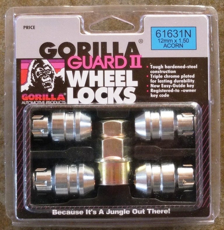

The lugs are 12 mm (0.472). These are the lock lugs I bought back in 2019.

So, I get home and check the torque on the lug nuts. The owner's manual specifies 100 ft-lbs., that seems high? I did some research on this when I bought the truck (Sept 2019) and 85-95 ft-lbs is what most tire shops use. So, I've been torquing them to 90 ft-lbs. when I rotate the tires.
I set the torque wrench to 90 ft-lbs... and only (4) out of (24) lug nuts were tight. The others weren't "loose", but they weren't 90 ft-lbs.
