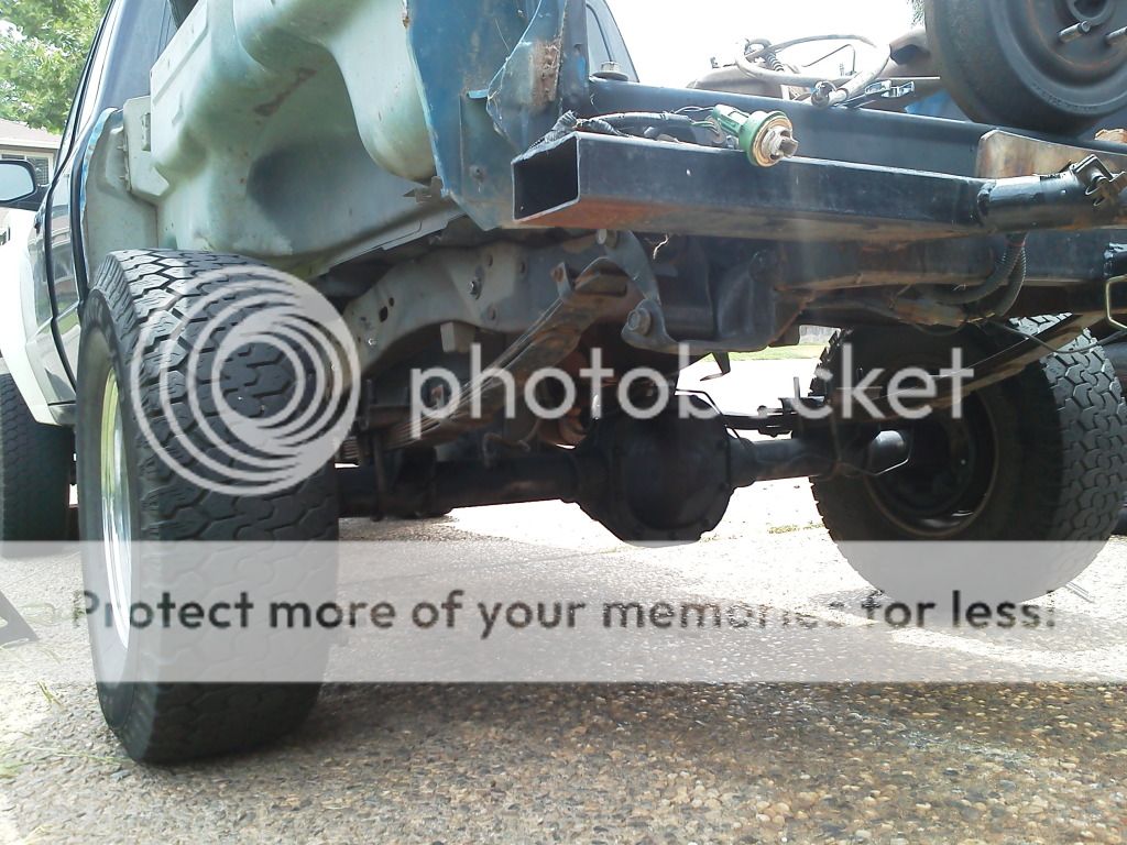

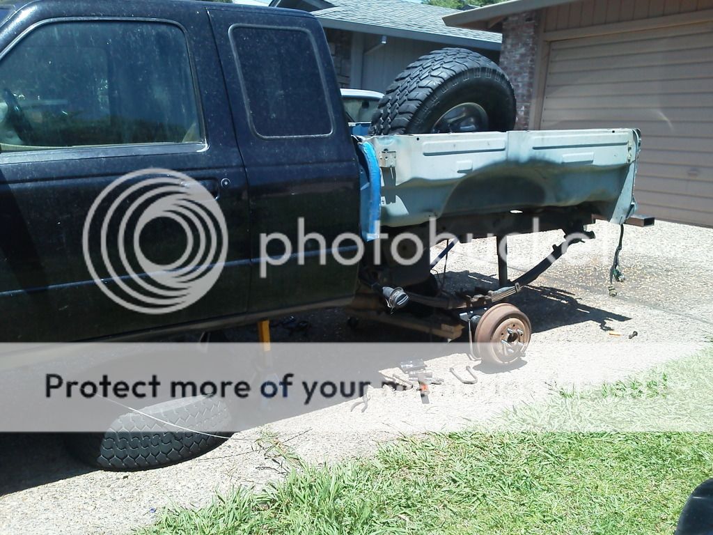

Test fit those ruffstuff perches before you weld them. My deaver center pins were too big for the holes they laser cut. Its a pain to get the axle under the truck to realize you've gotta drill the holes out.

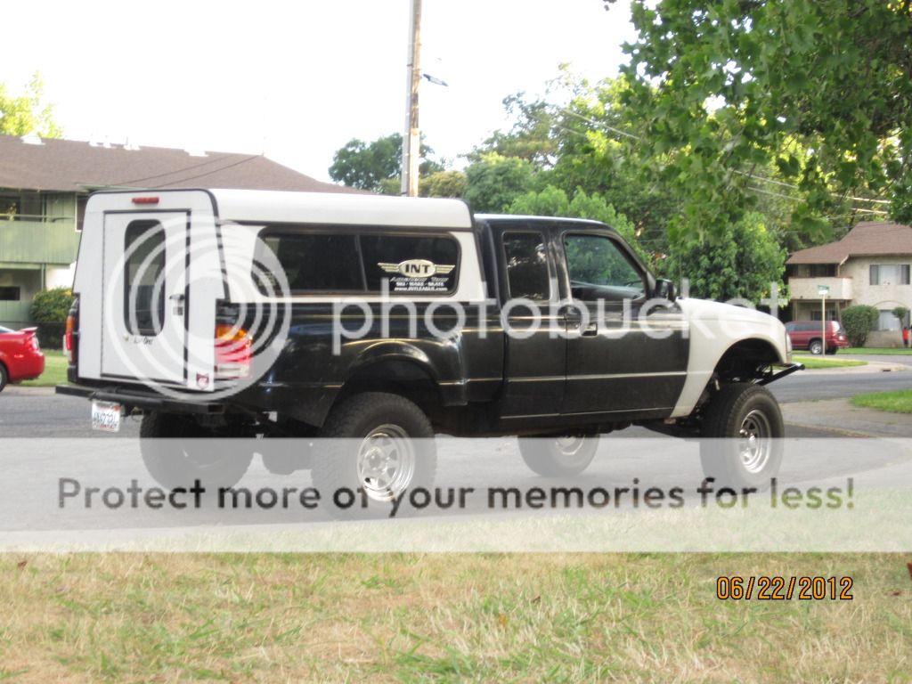

looks really good!
Looks like they fit together like they were from the factory. I like it.
