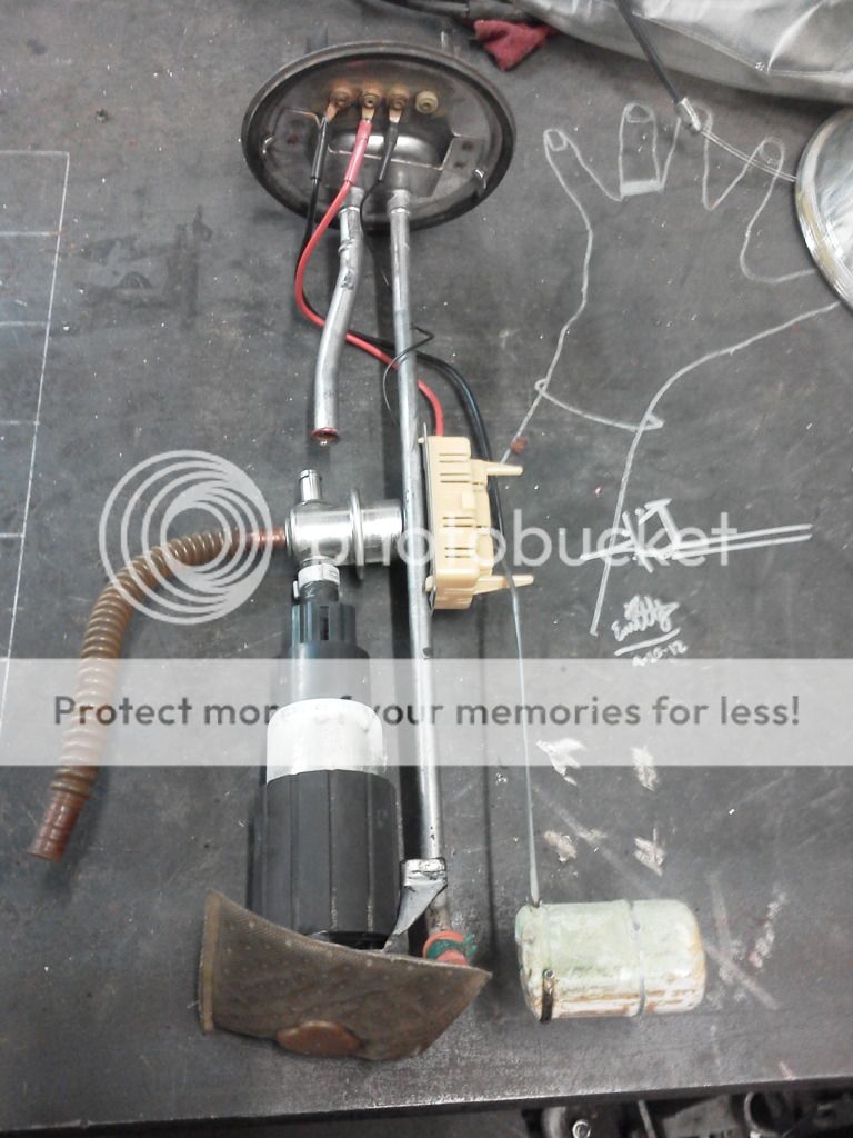

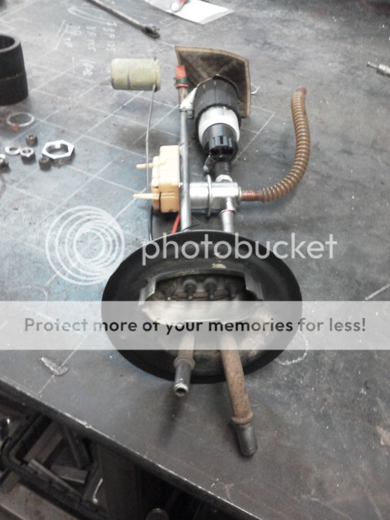

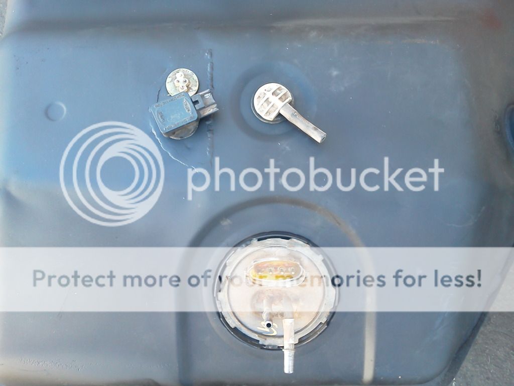

i just got done with this swap. the swap was not as plug and play like as i had hopped. the main reason it did not go as smooth is because i was dropping a (OBDI) 89 bronco 2 tank in to a (OBDII) 98 ranger frame.

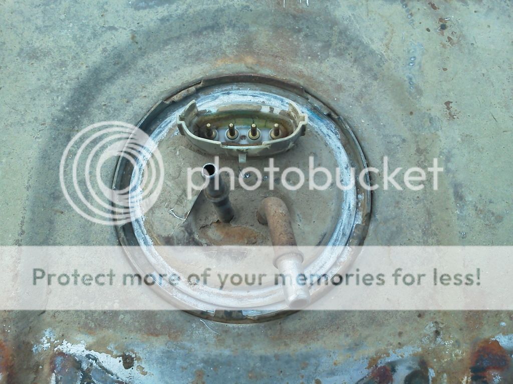

this is what your sender should look like
Swick's Prerunner
this is what my sender looked like.
Swick's Prerunner

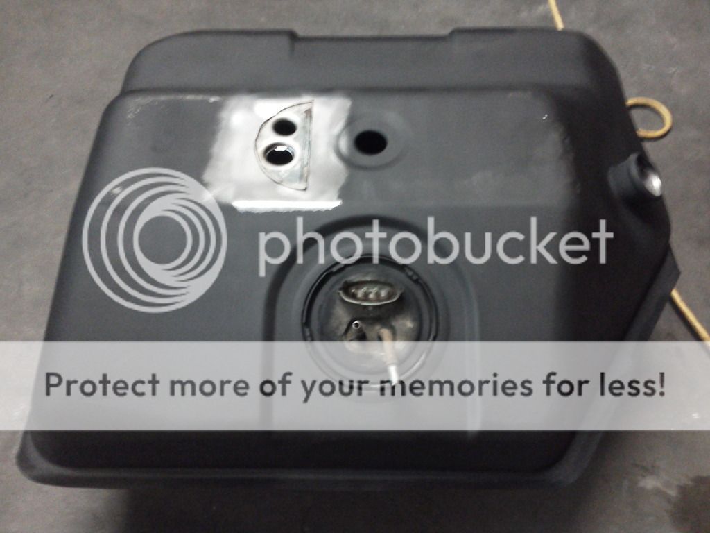

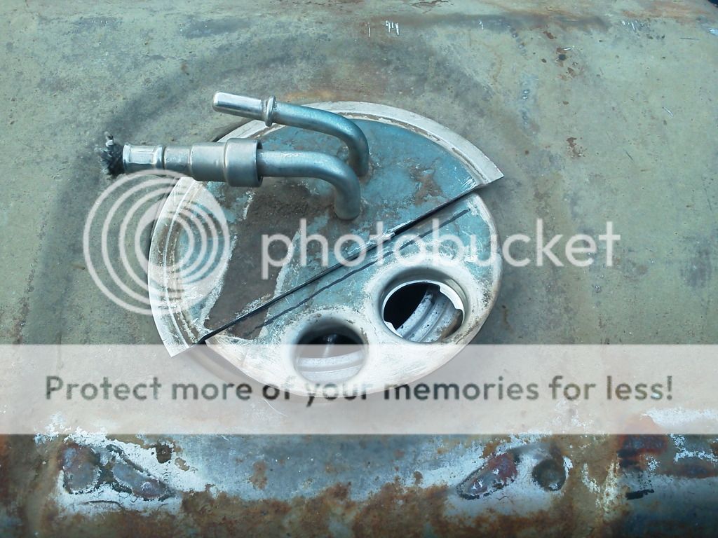

this is what i had to do to make it work for me. (I do not recommend anybody doing this)
98 ranger sender cut up
Swick's Prerunner

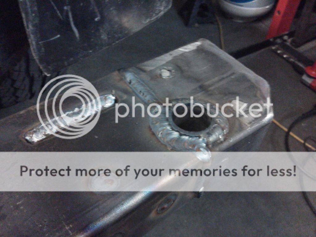

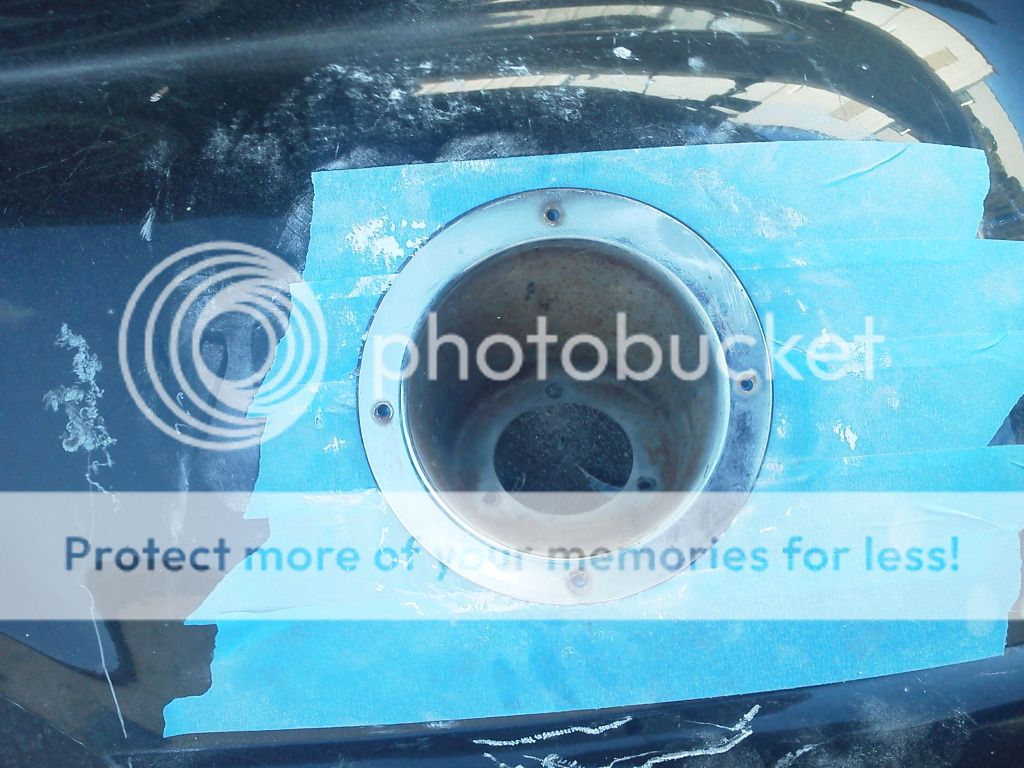

hole cut in to tank to match the plate cut from the sender
Swick's Prerunner
plate from send tiged into the b2 tank. the blank sensor measures the in tank pressure and the little white thing use to have the wires that powered the pump go through it. is just a plug now. im using the connector on the 89 b2 sender power the pump.
Swick's Prerunner
89 b2 sender with 98 ranger pump

So my Ranger is a 1991, will my field pump work in the B2 tank or will I have to guy a B2 fuel pump?
^^^i do not know what you fuel pump looks like. it would be best to use the b2 pump/sender. i did find out that the mid 80's b2's ran to fuel pumps. one was in the tank and one was on the frame. in the latter b2 ford went to one fuel pump that was in the tank. if you can mod the b2 sender so it will work with you ranger pump. kinda like i did

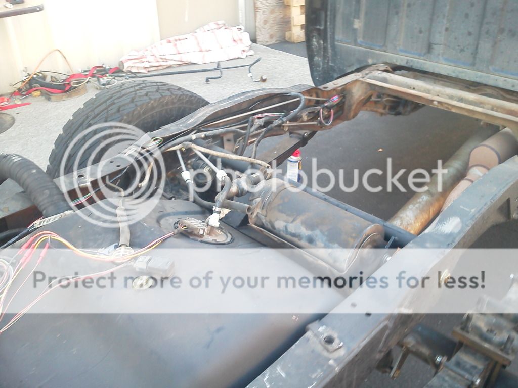

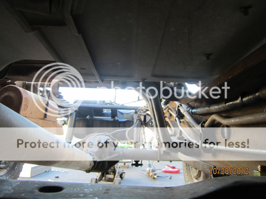

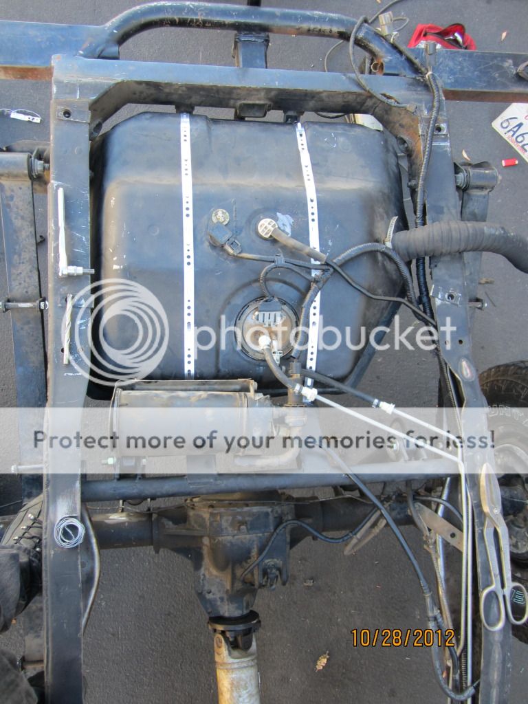

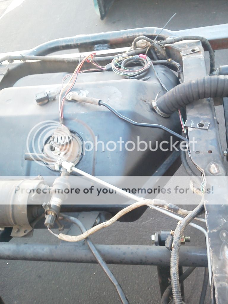

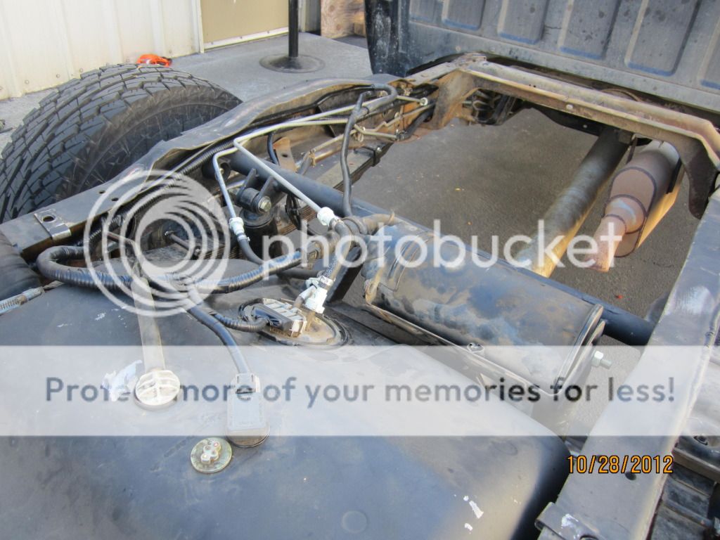

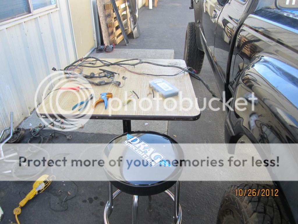

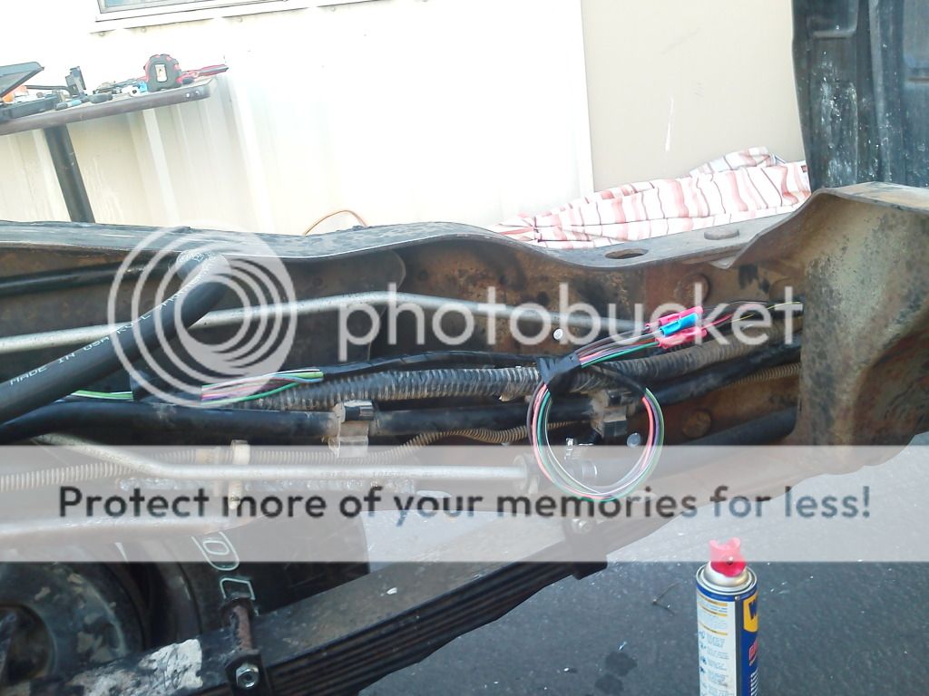

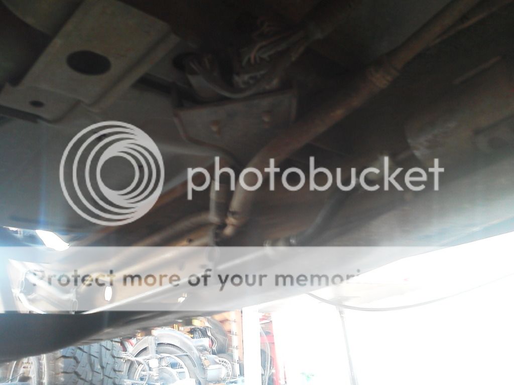

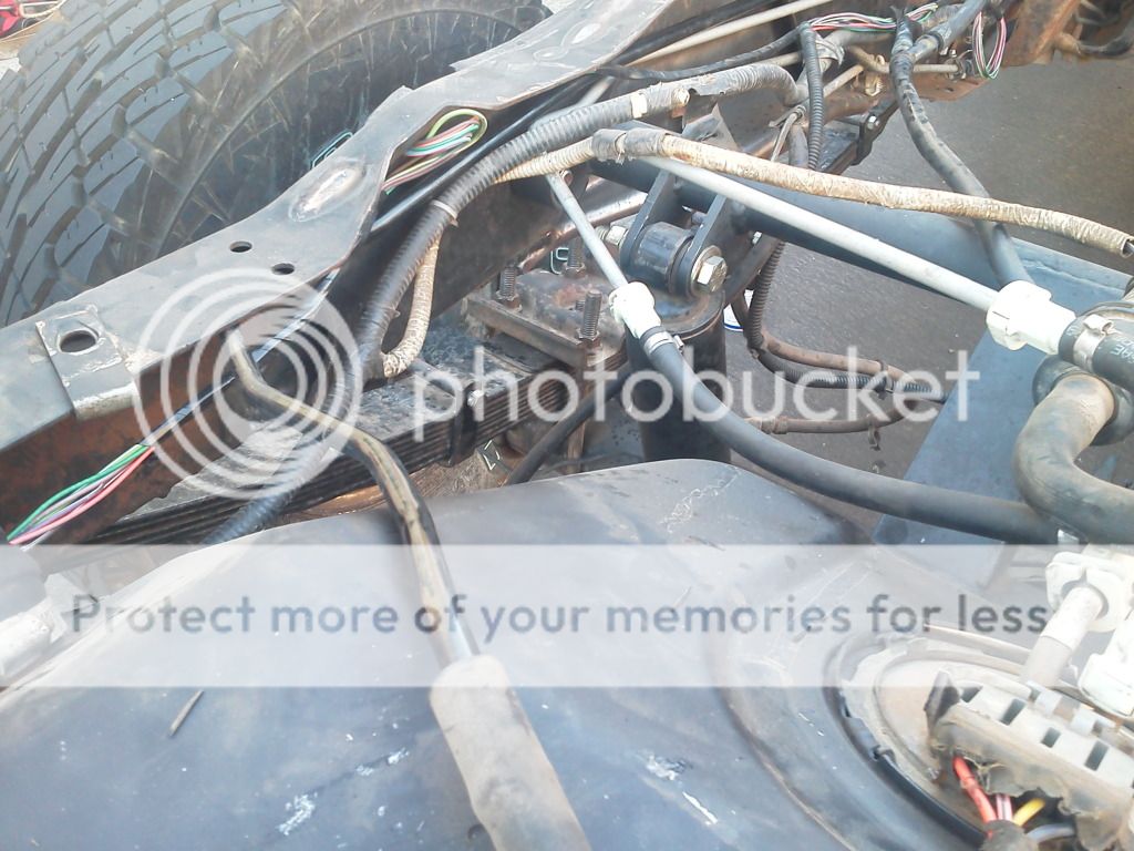

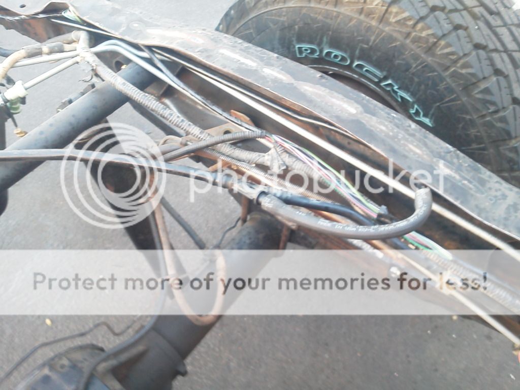

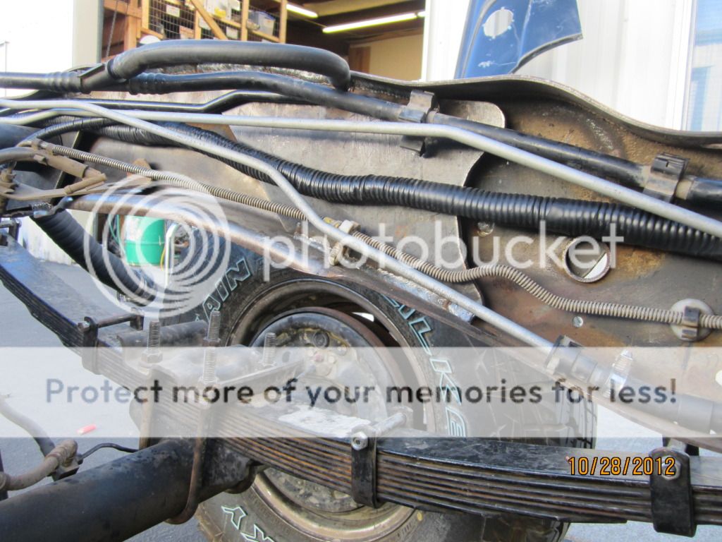

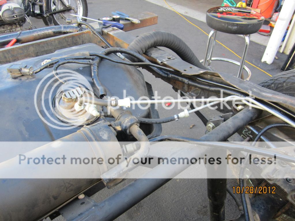

pics of the plumbing and wiring (tomorrow i will be make everything look clean and ditching all the quick crimps for shrink tube and soder) one thing if i did not have access to all the aluminum line this project wold have been scraped. the hard lines are carb approved so i should not have any problems with smog.

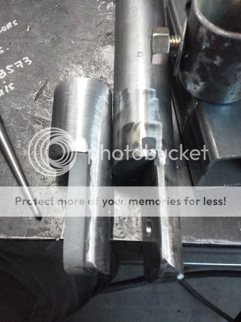

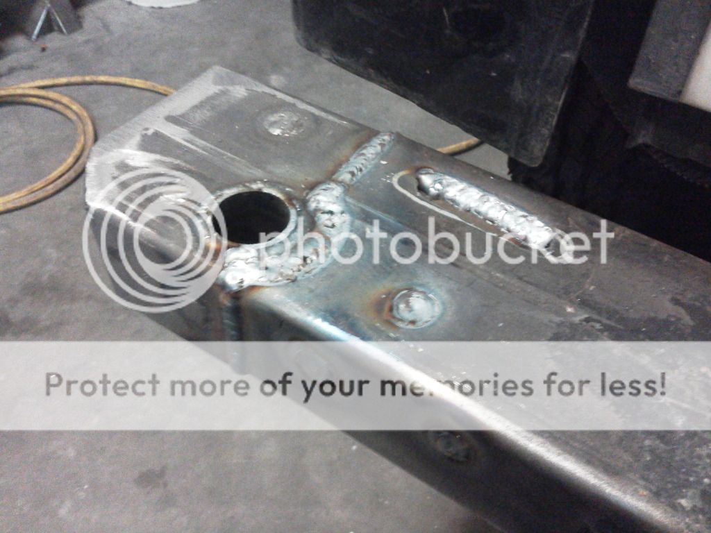

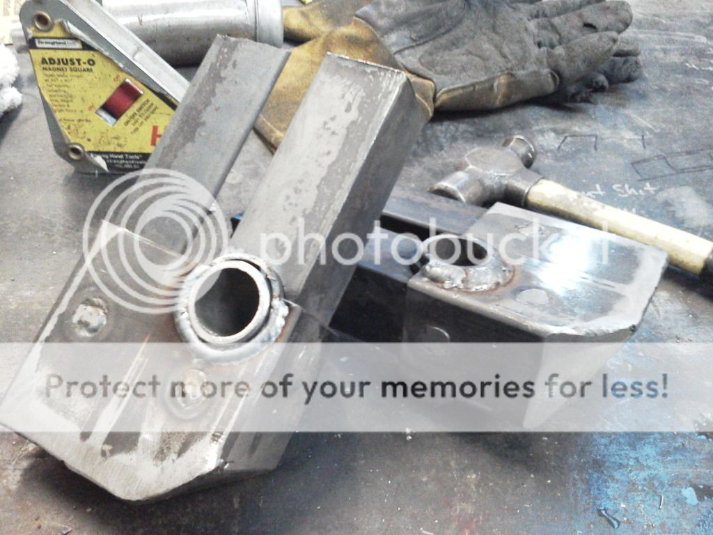

i like the way the tank came out man! how hard was the 2.0 conversion when you did it? did you mig or tig the upper shock mounts? also, still down the the DR PC meet nov 11th?
my 2.0 conversion only took a day and i was only using a sawsall, grinder, and welder. what helped was that i did not have to make lower shock mounts. i plan to make it but i may not have my truck. my trans is dying a slow death.

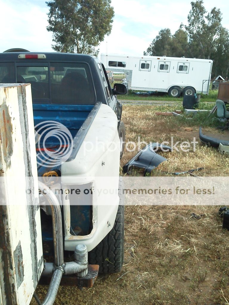

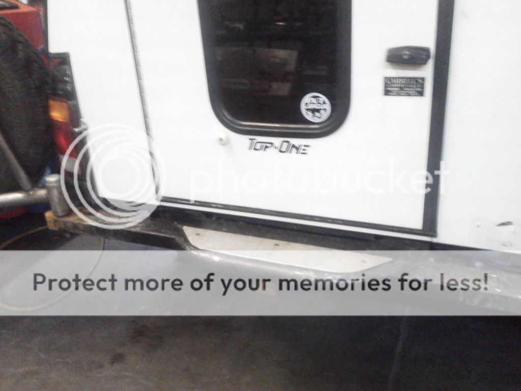

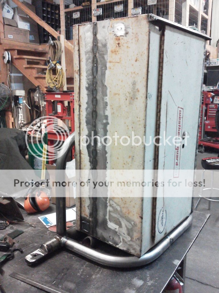

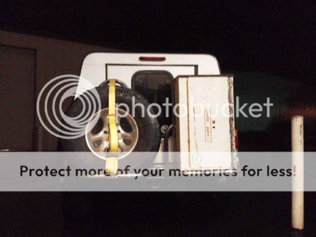

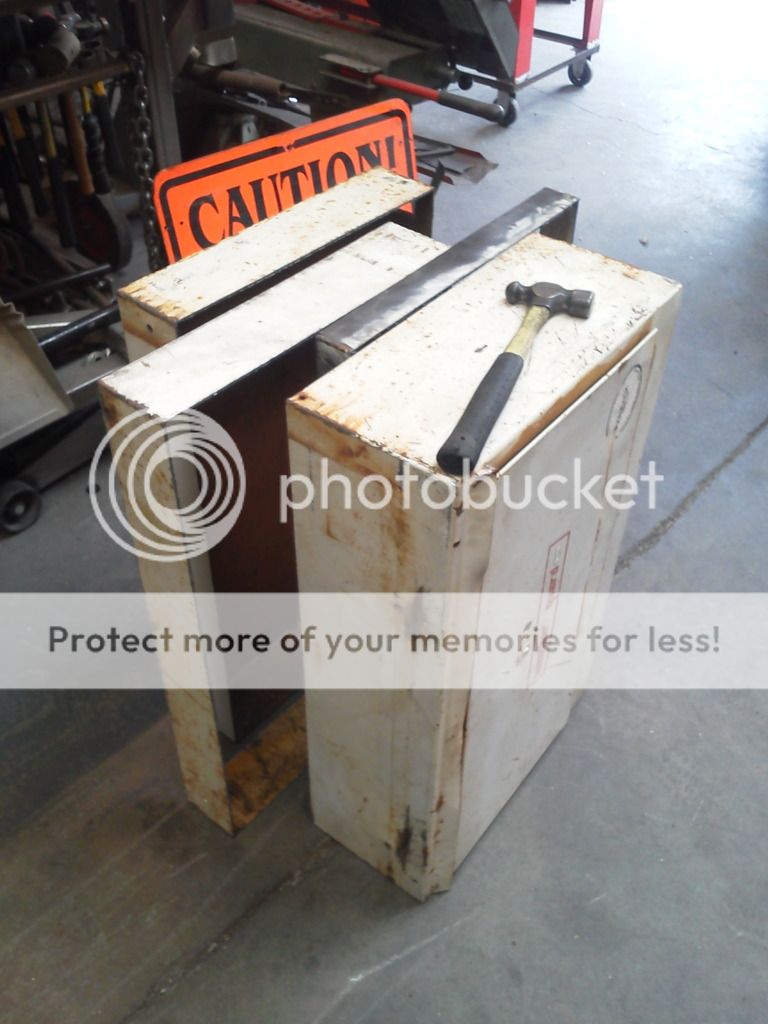

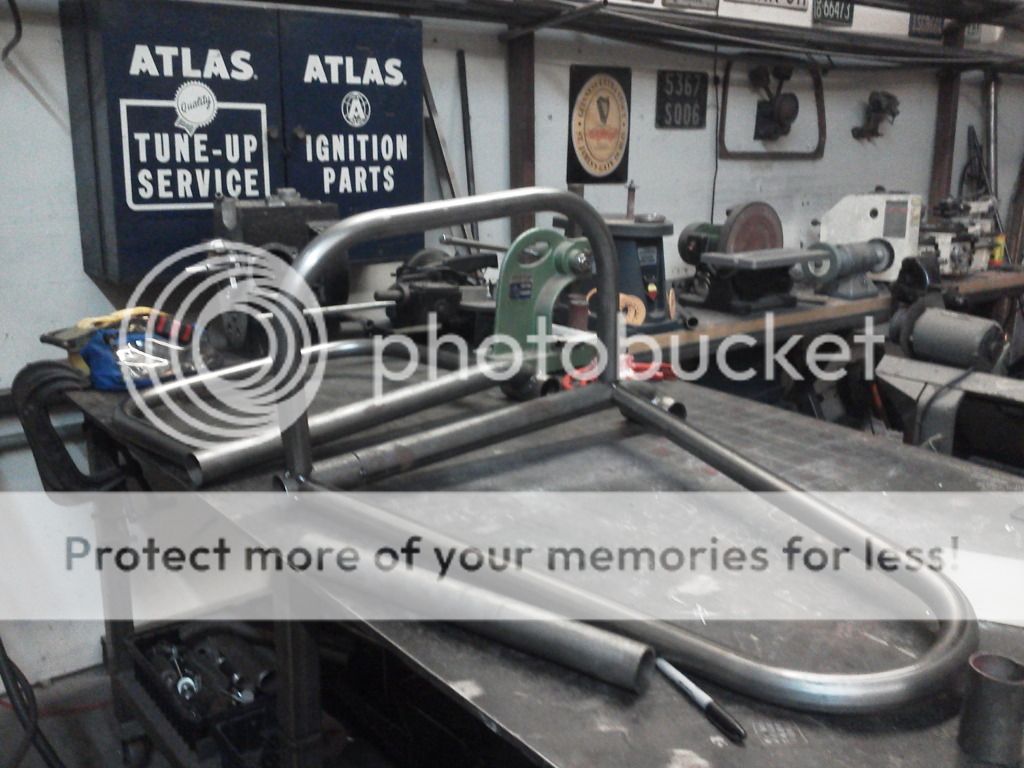

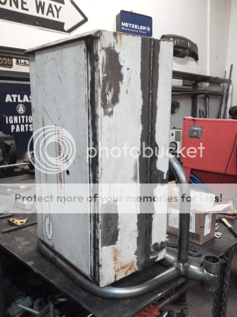

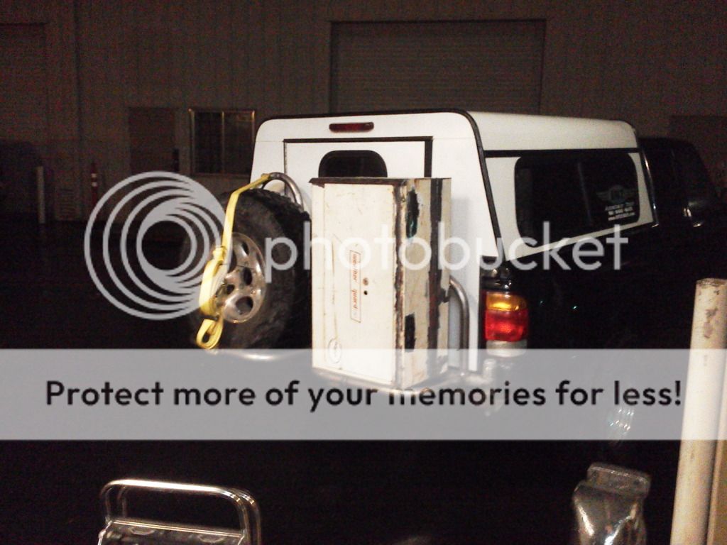

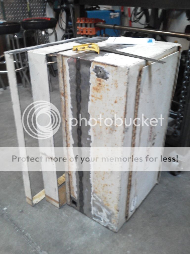

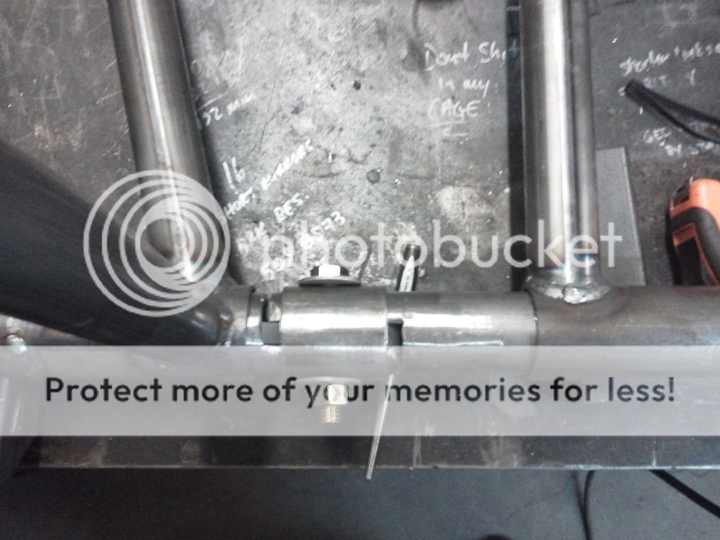

did work yesterday. im 98% finished with the fab work. i just need to clean up some thing today and it all will be done. im going to get it all powder coated. im thinking the framing black and keep the box white.

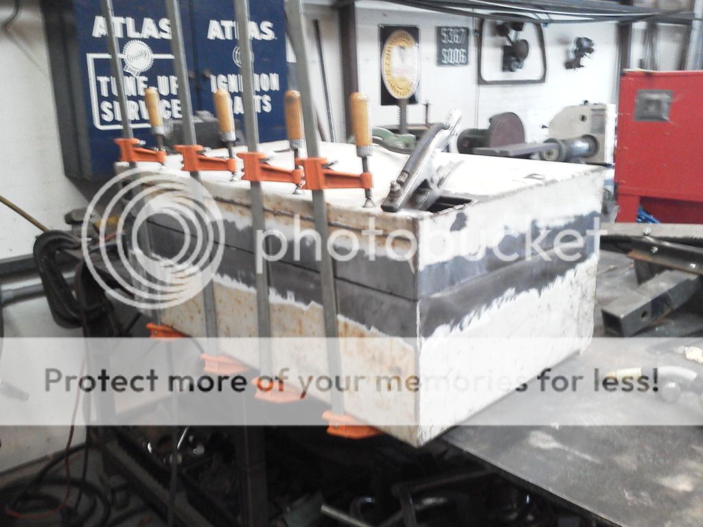

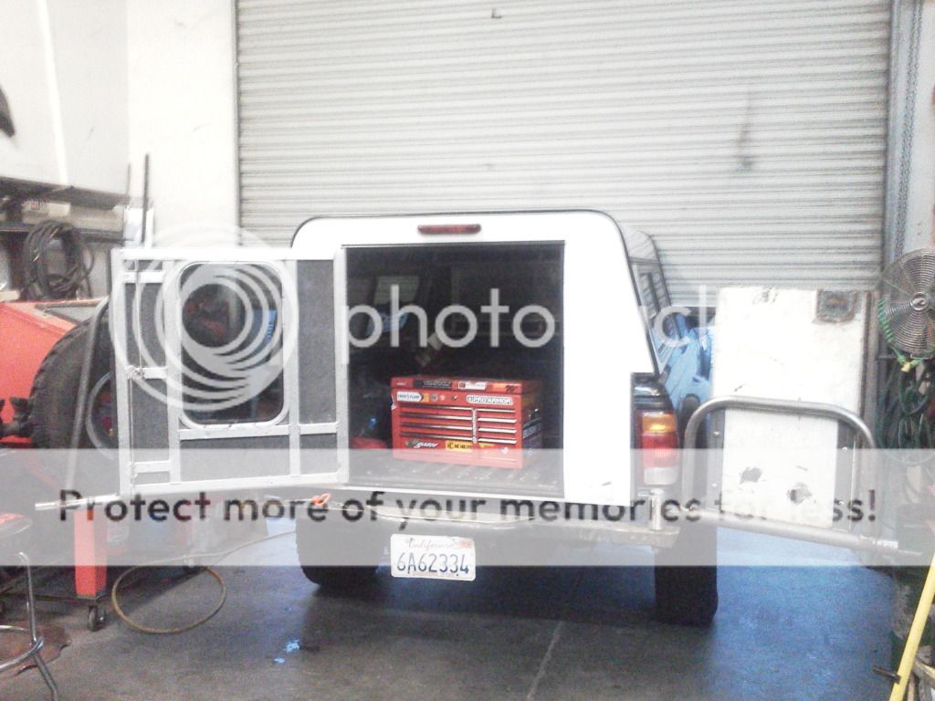

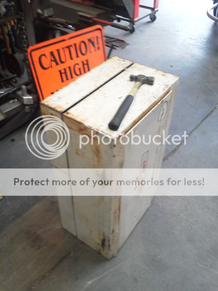

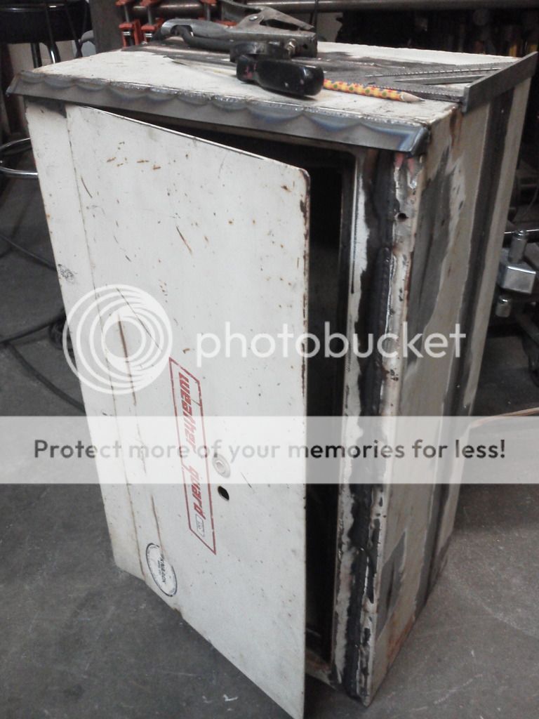

for most of yesterday i was mainly working on the box. it started out as a lay flat and open with the dimensions of 18"L x 18"W x 32" T. i converted it to a stand up and open with the new dimensions 18"L x 18"W x 32". i traded my small old box for two of these boxes.

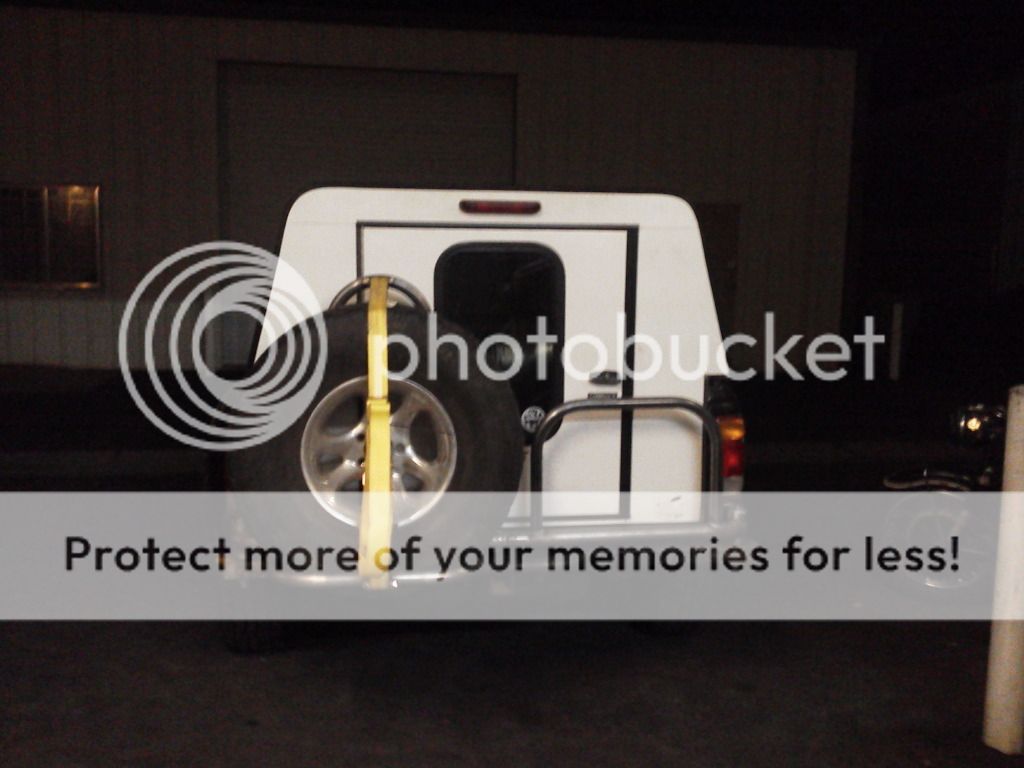

quite the adventure mobile you have created
haah thanks.

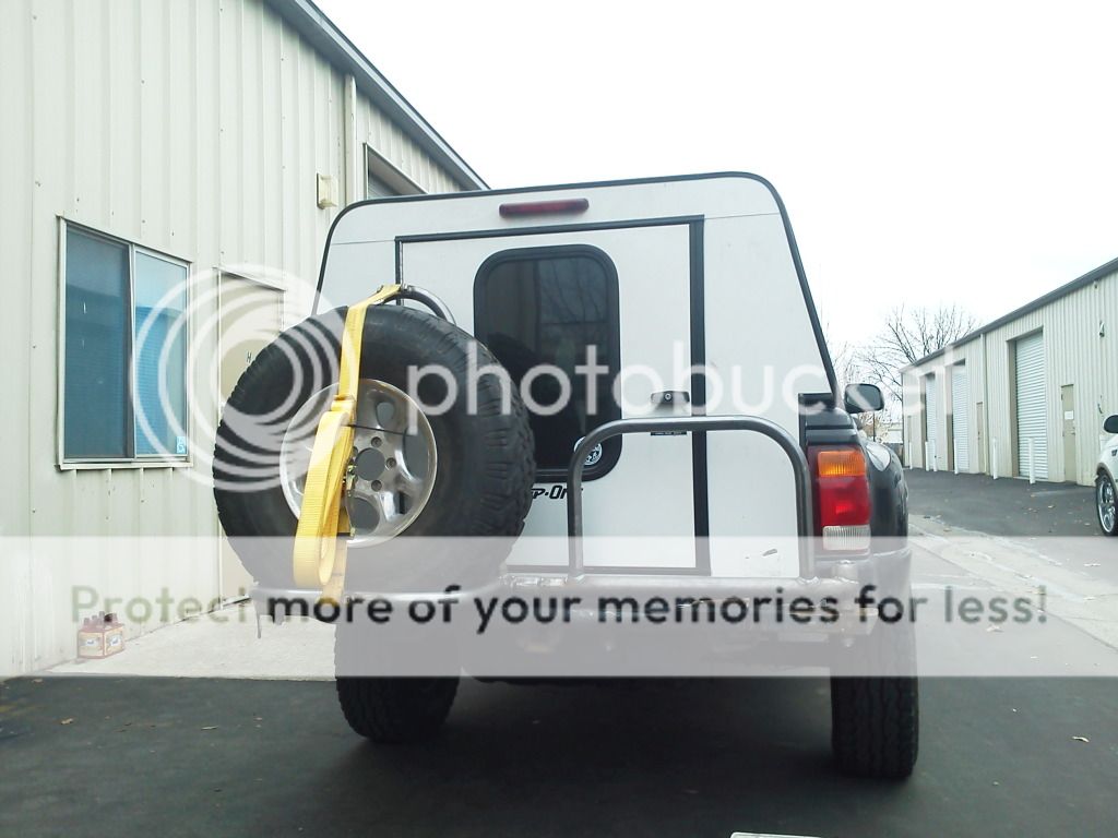

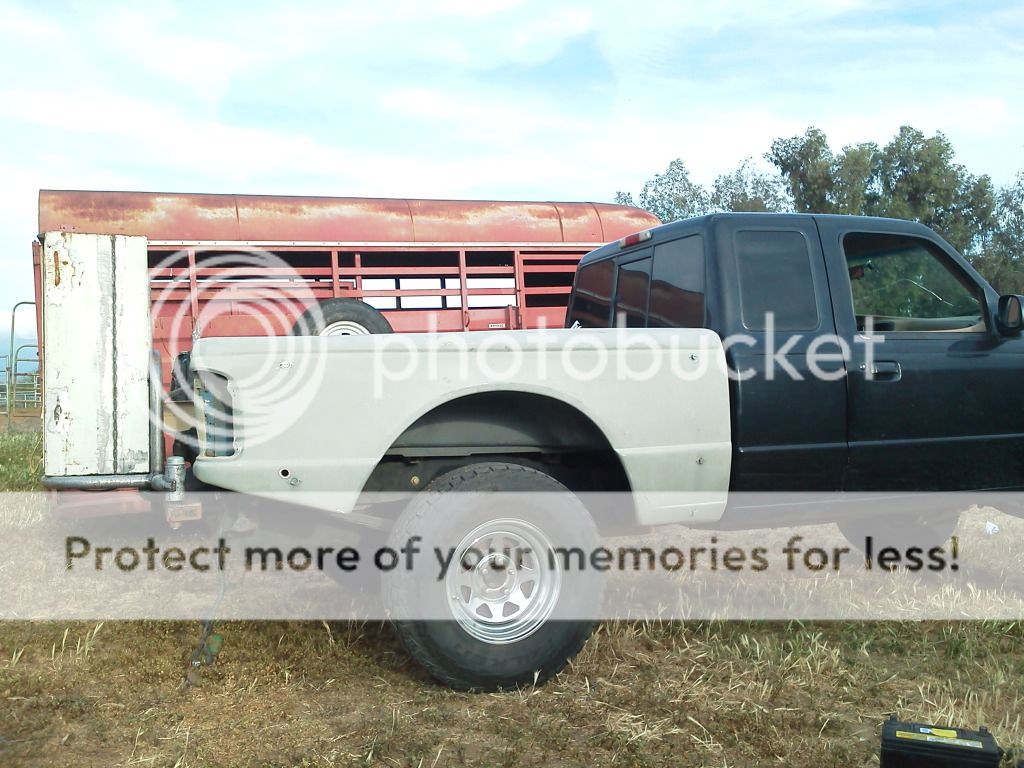

what nice about what i have created is that i can remove the shell and the swing outs including the spindles and then i can run trail with the best of them.
