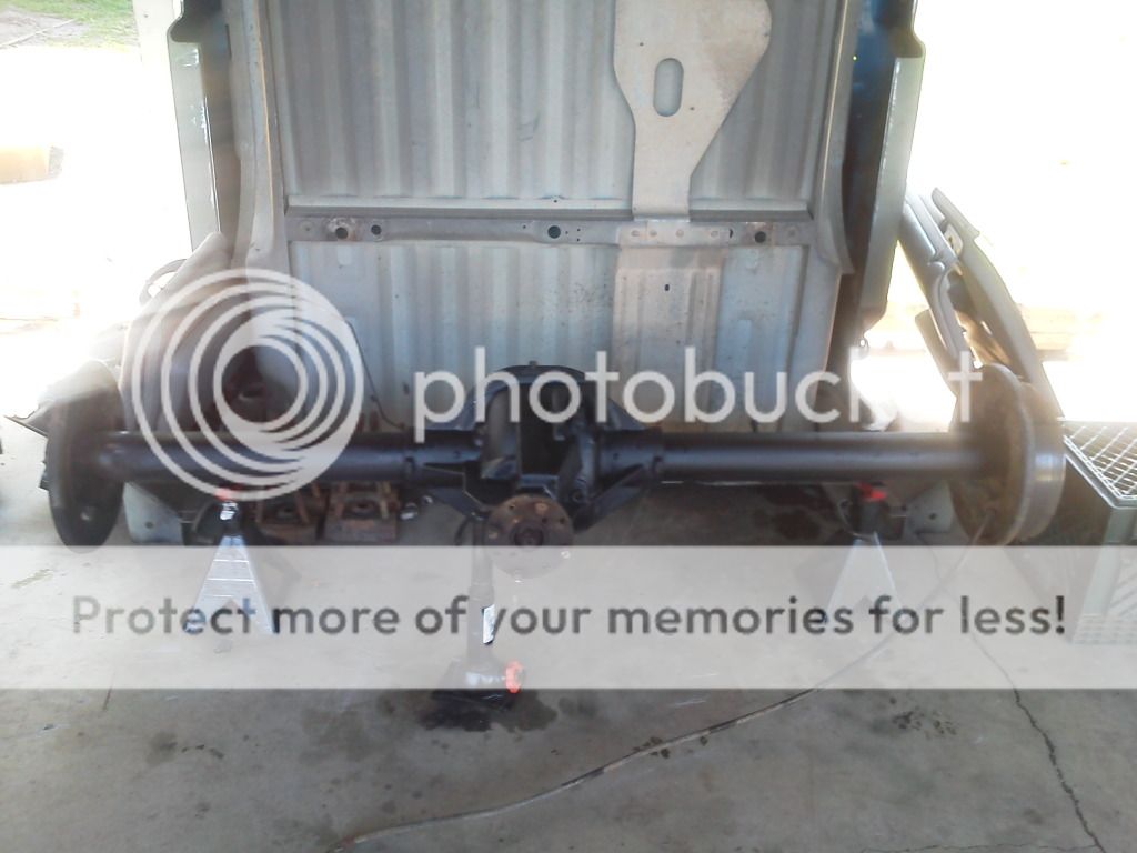

i picked up a full width axle today. i was able to pick it up for no cost to me. all i had to do was help the original owner with some things. im also going to go back tomorrow and pick up some move stuff. im glad i have to get the axles re drilled because it need new wheel seals. tomorrow morning im going to strip it down and see what else its go to need. im also going to see what i can can be swapped over from my ranger axle. i

thats awsome... i love my ranger 8.8 that i swapped into my truck. good luck. p.s. your gonna need a jack and a friend to get that axle in hahaha
i have had fun with my ranger 8.8 with 3.55 limited slip for over 200,000 miles. also i have never serviced it besides making sure the diff fluid is where its suppose to be. that is one of the reasons im swapping out the ranger 8.8 for the fw 8.8.

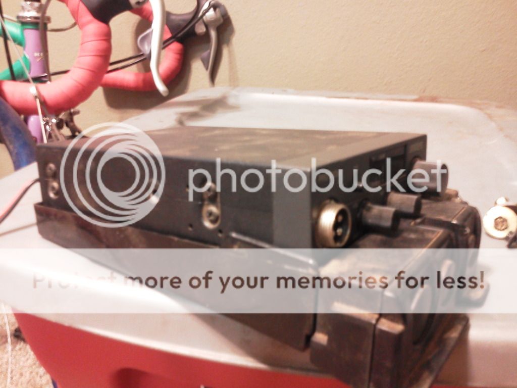

my bounty for today. picked it all up for free charge but i did have to work 6 hours. so hare i worked for this guy for 8 hours and i have pulled over $500 in parts (local wrecking yard prices). all the parts were pulled from a 96 expo. i also scored a cb radio. i was able to pull a functioning tail gate for my dads 85 bronco.

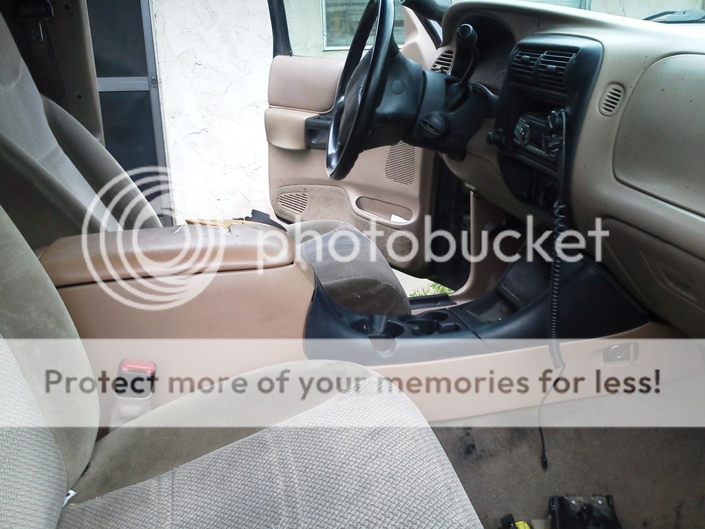

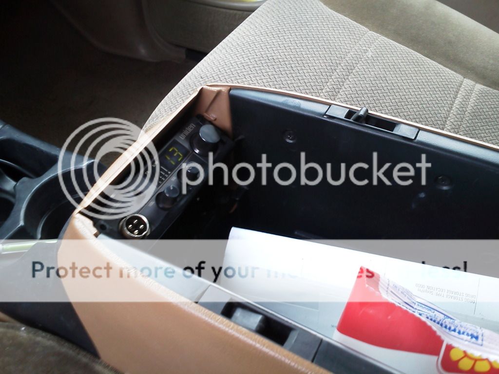

found that the cb will fit perfect in the center console.
cb sitting in the snot rag tray.

cb sitting where the snot rage tray goes

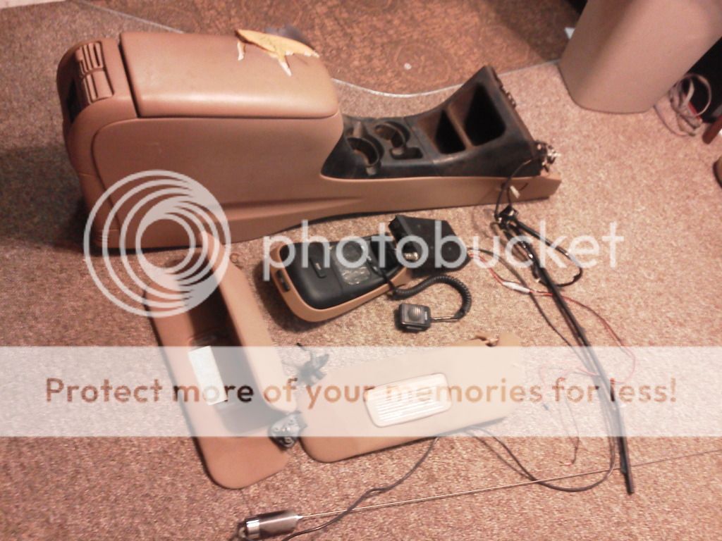

i got the sun visors in and ran the harness for the ohc.

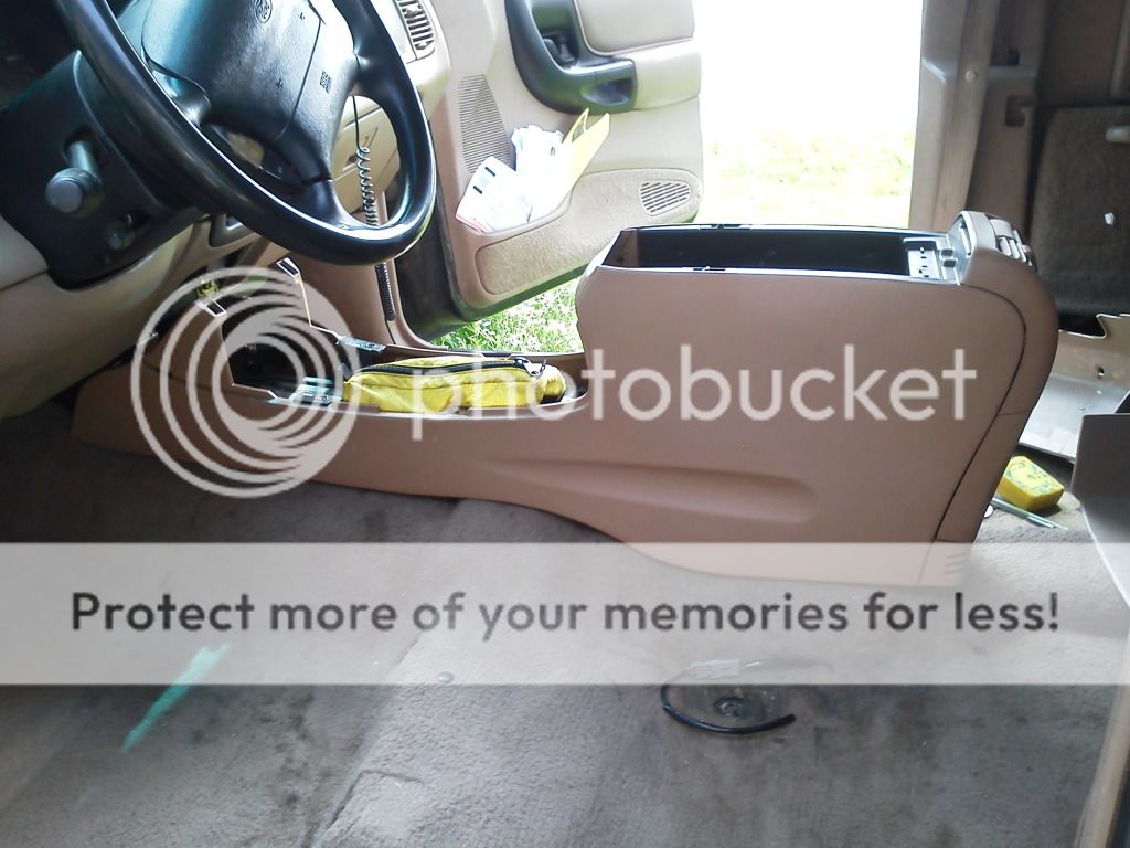

console in
Swick's Prerunner
console in for good.

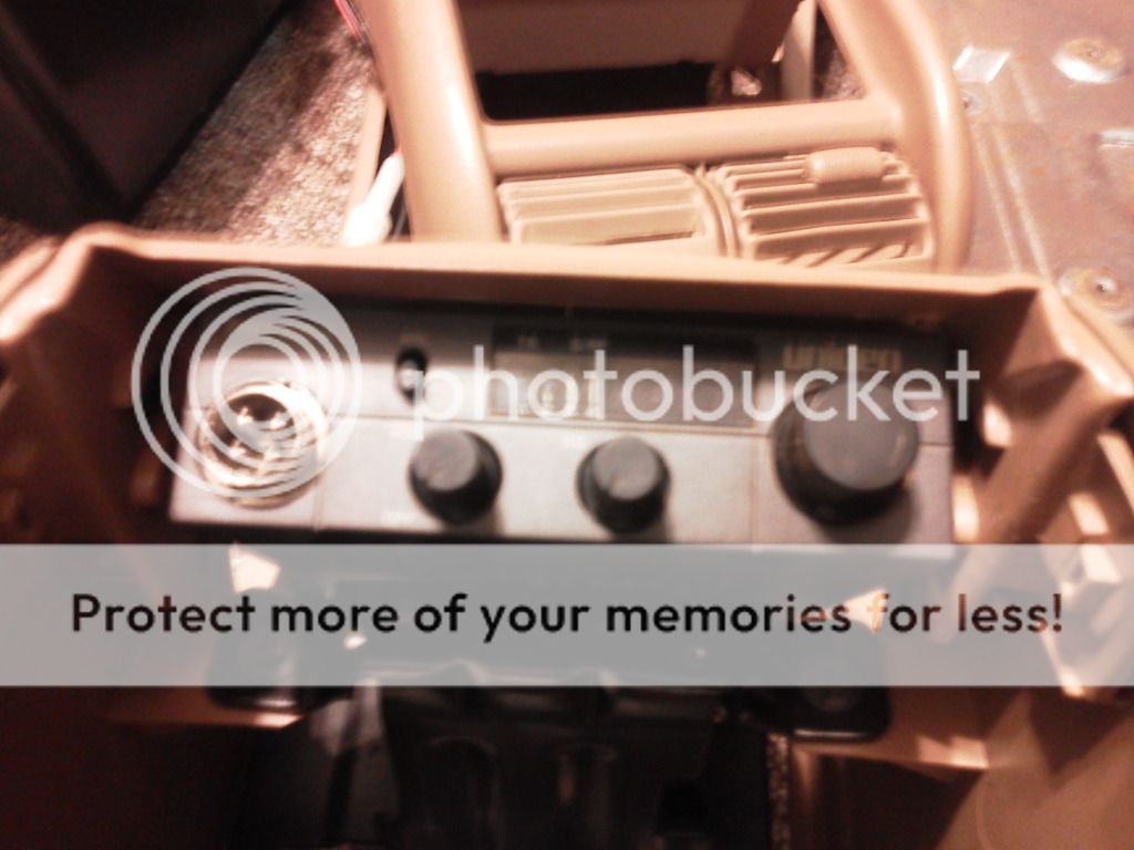

cb in for good as well
Swick's Prerunner
thats an awesome place for the CB.
i was stoked when i found that out.

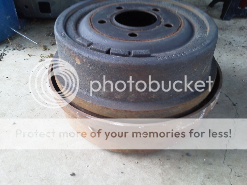

yep ranger brakes will not work on the f150 axle.

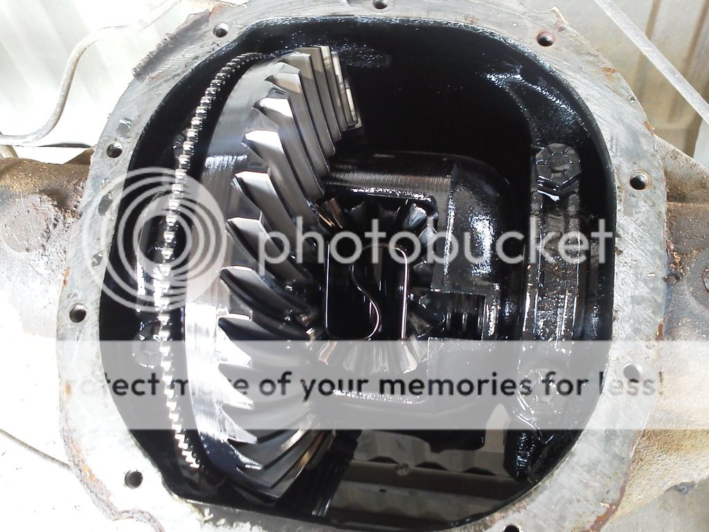

the gears looked good and the clutches are thick.

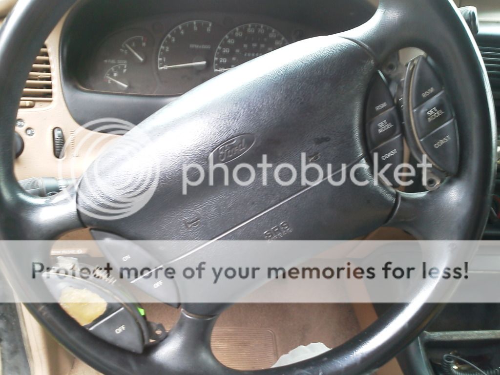

installed new switches.

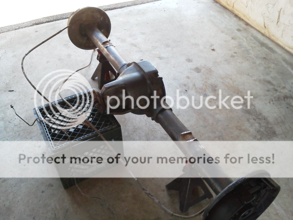

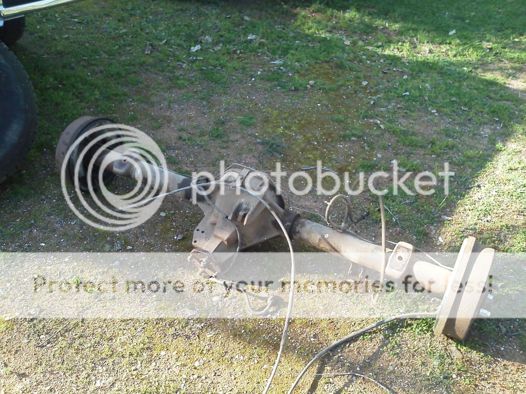

here are some up dates on the axle. i should be getting the shafts and drums back tomorrow.
Started to clean the axle.
Swick's Prerunner
Finished removing the perches and stock shock mounts. Also gave it a coat of paint.
Swick's Prerunner
Won't you have to remove some paint to do any welding to it? Like for a spring perch/shock mount?
