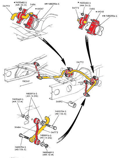

Some exploded views of how various style sway bars fit together. Fronts are 2wd, 4wd is similar.
I have the sway bar colored in gold and the mounting bracketry you may need to go with it for those that are retrofitting it in red.
Behind Axle (83-88)

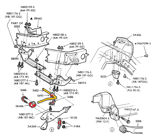

In Front of Axle (89-97 Ranger, all Bronco II)

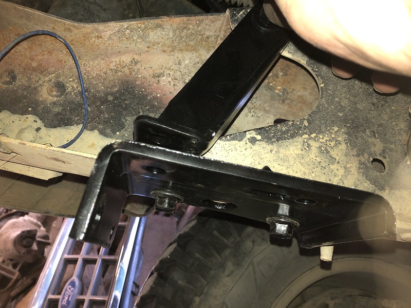

The hole where 5D484 brace mounts to the frame is different second gens/BII's (they use the same brace) and mere mortal first gen trucks, it is roughly a quarter inch too high and the brace will need shimmed. Second gen Rangers and first gen BII's in my testing use the same brace.

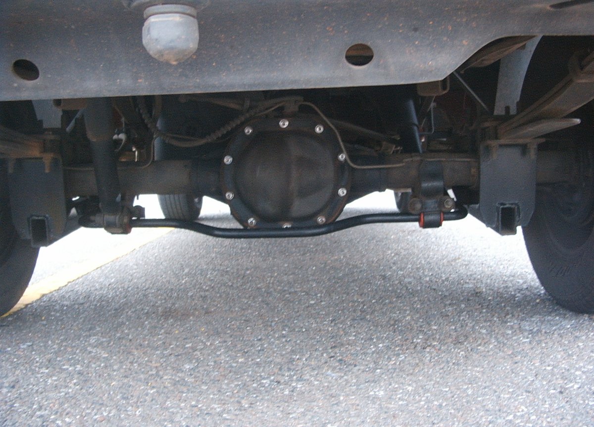

I adapted F-150 brackets to fit my 31 spline 8.8:

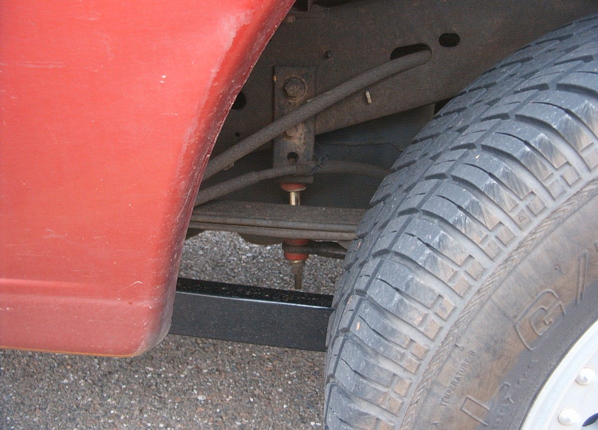

Hellwig rear sway bar on my 98 Ranger.

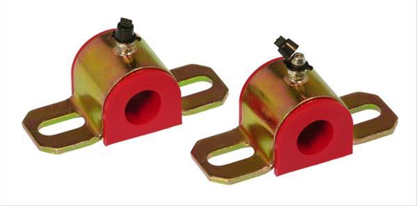

Worst case scenario, you can remove the factory sway bar mounts and use some universal mounts like Energy Suspension sells. They sell sets for all diameters of sway bars.
I used these on the front of my 87 V8 truck with a sway bar and end links from a 97 2wd Ranger. Though I do have a 97 beam swap installed. They do take some "creativity" when installing though. It's not a true bolt-on. Minor mods are involved.
I have a usable set of bushings from the 97 along with the factory steel straps that go around them. Fresh coat of paint.. I won't be using them.
Sway Bar Pictures
Yah. I redid mine in 2015 with Energy Suspension parts that I bought off the shelf at Auto Zone. Just figure out what diameter the bar is and how long the end links are, and match them up. It's not rocket science. And yup, they have grease fittings on them.
